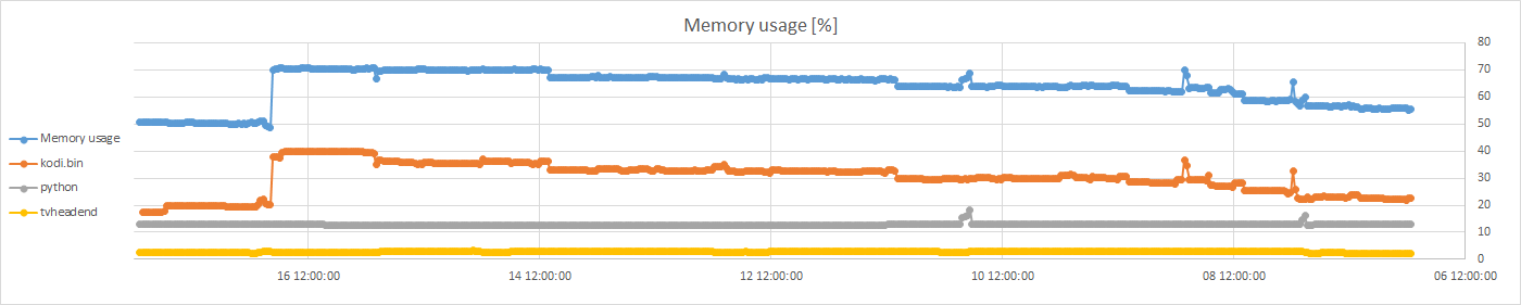

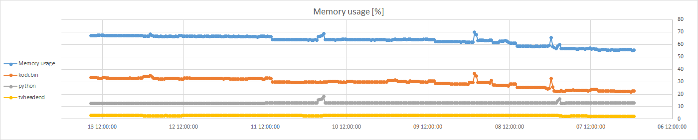

    Hi,
    Just an update on my findings so far.
    In the last days of last year I started to use Plex live TV & PVR i.s.o. TVHeadend (mainly for a daily recording of new and weather).
    In the graph you can see that the constant increase of memory usages moved from Kodi to Plex Media Server...
    I also found a memory release issue with SABnzb-2, not releasing its memory.
    In a week or so I hope to move to a x86_64 system.

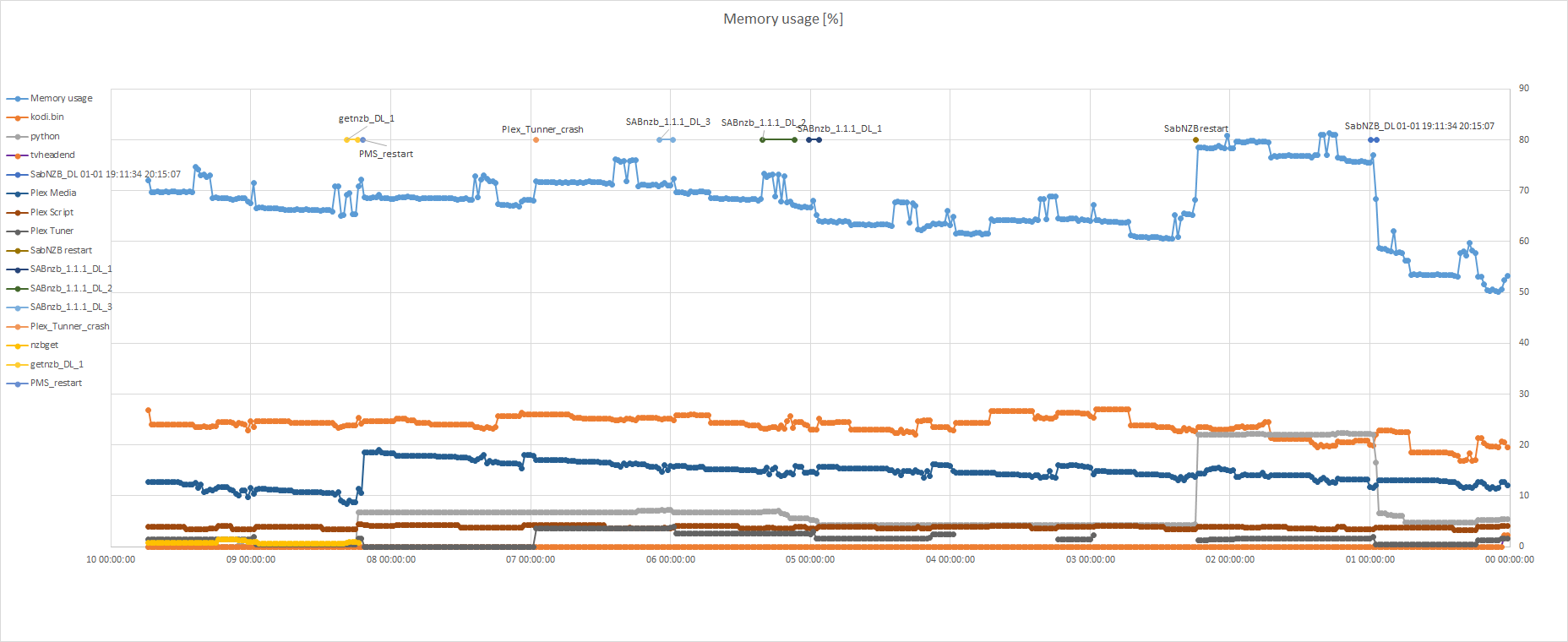

    I only recently started monitoring memory usage, and observed the same issue with all 3 downloads I started.
    I'm using SABnzb 2.3.9 from the Thoradia add-ons on LibreELEC 9.2.6 on a RPi3b.
    This works very well except that it appears that SABnzb doesn't release its memory after download/par processing/unpacking.
    I'm monitoring memory usage for a high amount of Kodi crashes (still an issue), and now also see that SABnzb doesn't release its memory after use.
    The graphs below are made from the output of 'top' sorted by memory usage collected every 30 minutes.
    Graph of first occurrence:
    (what you see it total memory usage in % in blue, Kodi in orange, Python in grey, and TVH in yellow. Added with some additional time events including the actual download period of SABnzb. And time goes from right t=0 to left. Just look at the most left part for the grey line.)
    Graph of second occurrence:
    (In above graph again total memory usage in % in blue, Kodi in purple/orange, Python in grey, and TVH in yellow. Added with some additional time events including the actual download period of SABnzb. Look at the grey line which doesn't go down after the download/processing finished.)
    Just wonder of other have observed the same...

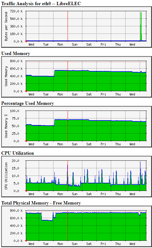

    The daily and weelkly MRTG graphs:
    Yes, indeed. Even with 3% memory usages increase each day it should run for a week or 2, before it is getting into problems.

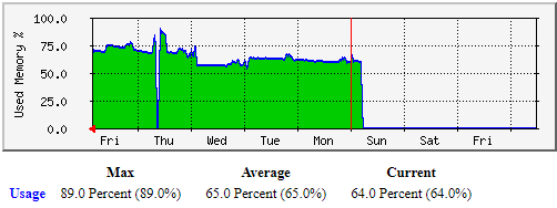

    MRTG with the new 'Available Memory' OID is now running a number of days.
    The below graph shows the weekly graph of the Used memory in percentage.
    There is constantly an increase of memory usage, but I was not able to identify a process (top -b -o +%MEM | head -n 20) that could be responsible for this increase.
    Graph details:
    - MRTG started last Sunday evening.
    - The RPi3 was running mostly idle for two days. During this period memory usage increased about 3 percent per day.
    - Kodi crashed on Tuesday (1-Dec-2020) evening at 2215. This decreased memory usage with about 6 to 7 percent. After this memory usage is flat for a long time.
    - Wednesday evening I played a bit with the Plex server and started a scan of my library which was still busy when I went to sleep.
    - Thursday morning at 7:42am there was another Kodi crash.
    - On Thursday at about 11am started a download that lasted till about 5pm
    - After the download memory increased about 8 percent a day.
    - At 2pm memory usage decreased with about 6 percent, but have not seen a reason (see spoiler for details).

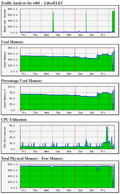

    (adding a graph from the last ~day, and patches used toward the end of this post)
    /Edit
