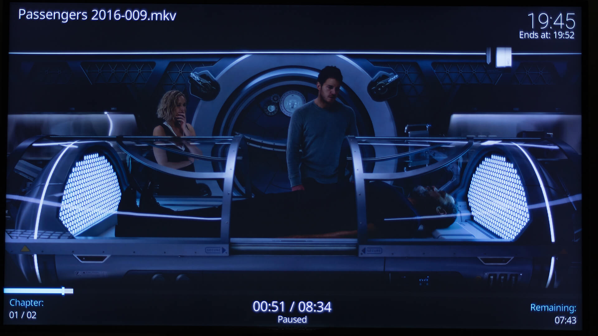

just loaded 8.0.1l-mm coming from 8.0.1l, TV Output is darker.

I am sorry, but if you prefer Frankenstein Nougat based on a 10 Bit video (your screenshot), I cannot take you seriously.
10 Bit causes horrible banding in Frankenstein Nougat builds.
The menu screenshot looks like you took the MM-build picture before playing a video, i.e. before restoring the correct brightness. -
