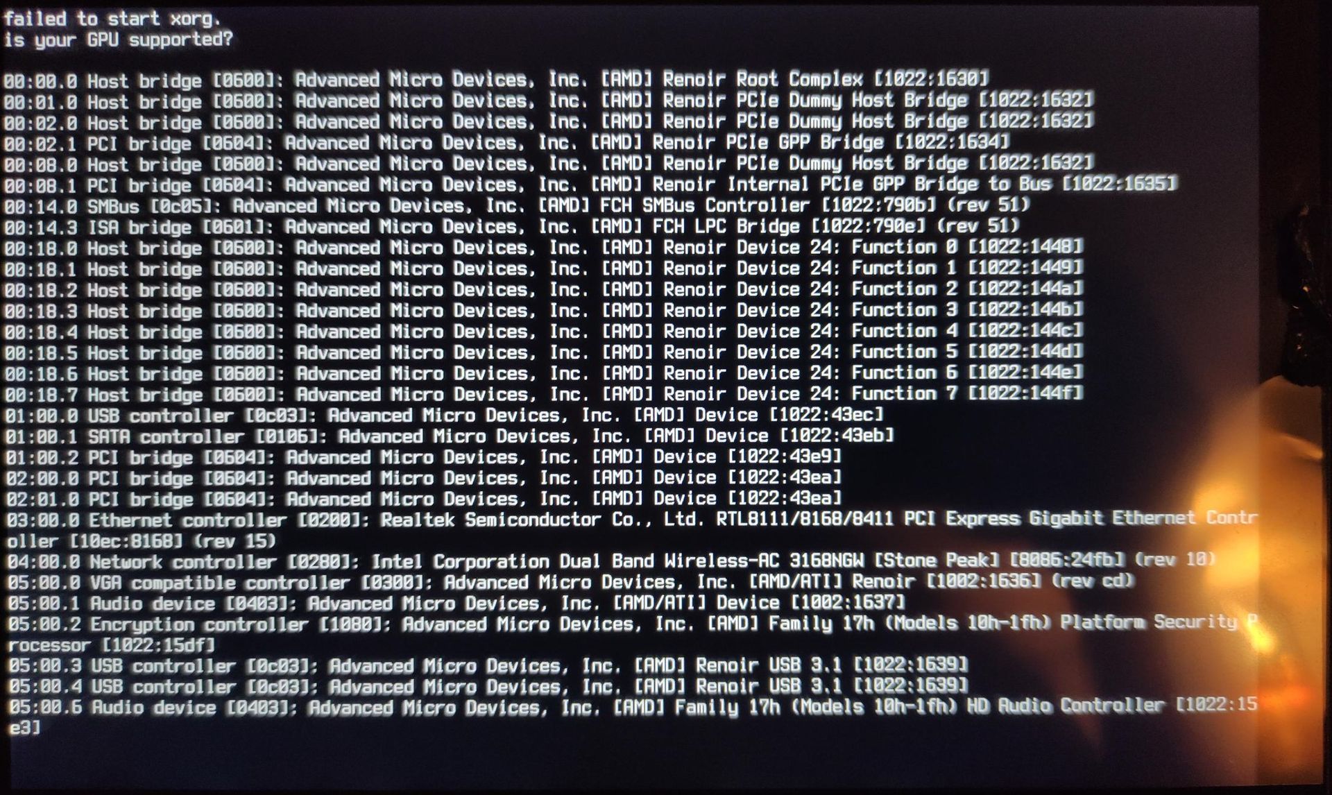

Are there any known problems or settings when interacting with the AMD Ryzen 3 4300GE ASRock A520M-ITX/ac ?
No matter if I use the current LibreELEC-Generic.x86_64-10.0.3 or LibreELEC-Generic.x86_64-9.2.6 on different USB sticks and USB ports, even deactivating the SecureBoot&uEFI-Boot only brings the possibility to run the different boot versions or to install them on a memory, after that the system hangs in the LibreELEC screen... then nothing happens any more.
