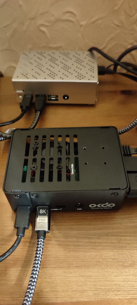

    This is my setup with two Rasp Pi's ver 4B rev 1.4....

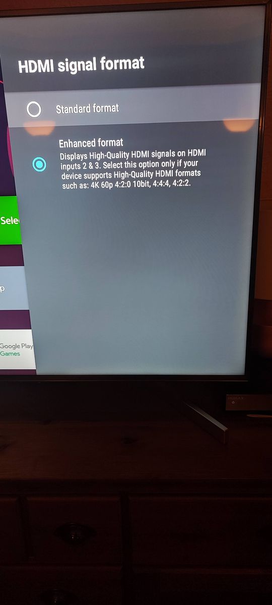

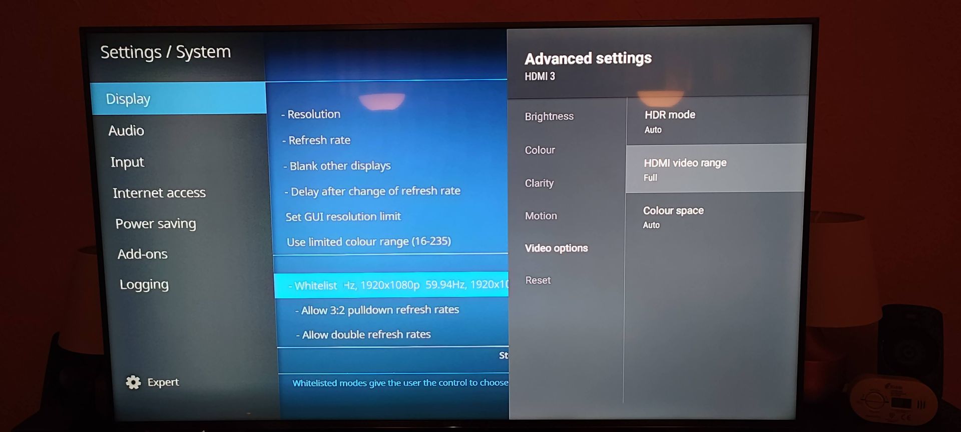

    I might have something that could be interesting BUT more testing is required. Since I have changed my HDMI port to "Enhanced" (see photo above in post #19) the Nightly Pi has been booting and rebooting without issue. It also has been switching resolution as needed very responsively, without pause.
    When first booted, after the Pi coloured square splash screen, it now goes immediately to the Libreelec boot screen. EVEN if that worked before there was a delay before it did that, sometimes failing with an even longer black screen delay. No black screens noted as yet.
    But I will keep testing, this time on the nightly build, as I feel that it could well be resolved due to the port being set to enhanced and support 4k at 60Hz. Not sure of the technical reasons as to why that could happen.

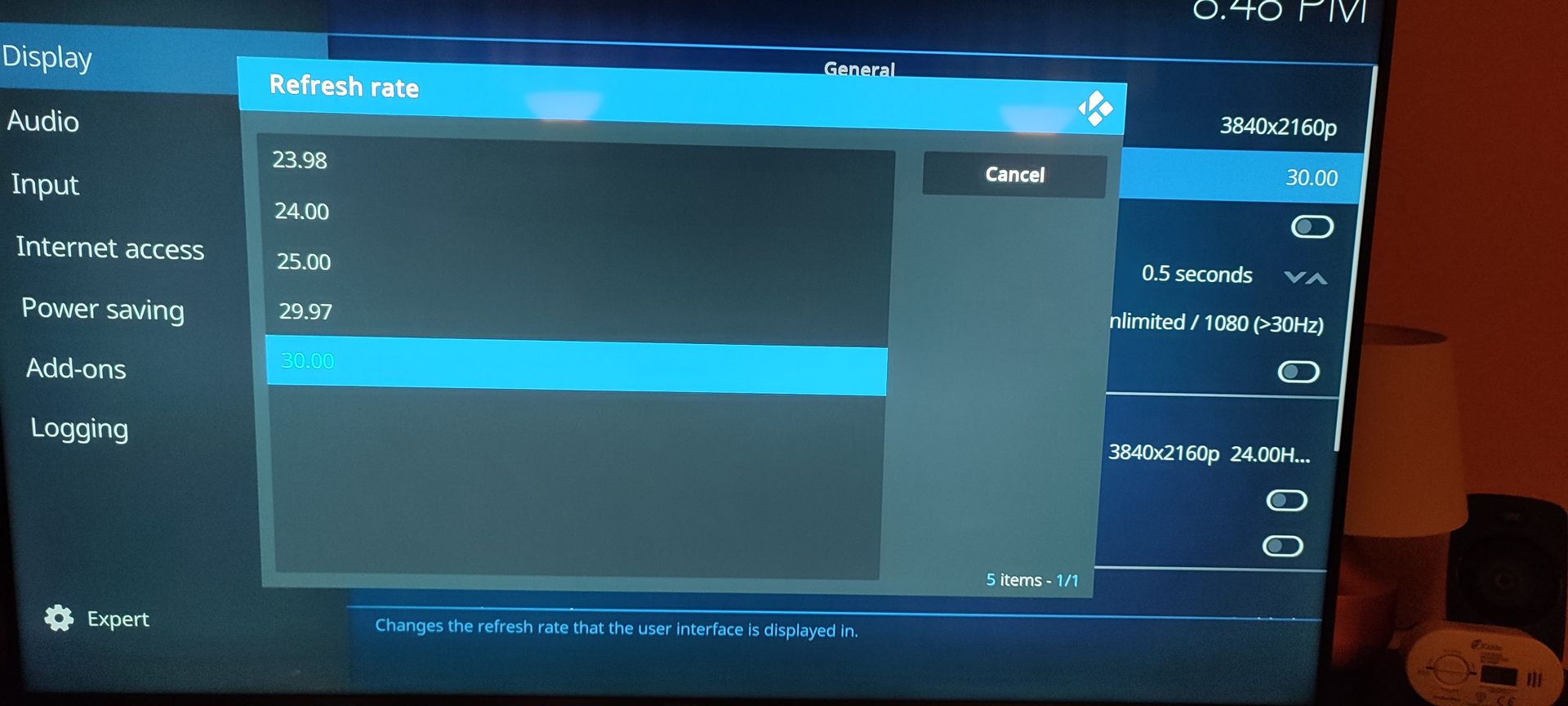

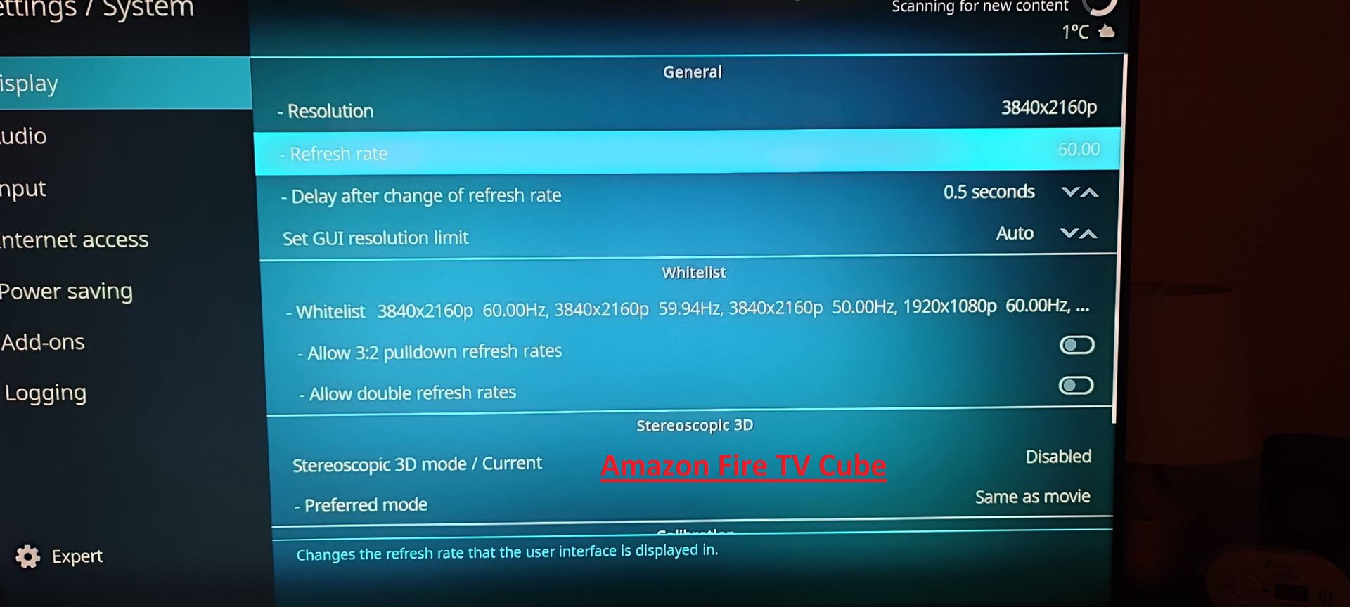

    BTW Since I changed my external inputs to the first attachment I now get 60Hz if ever needed in the Kodi settings, see second attachment.

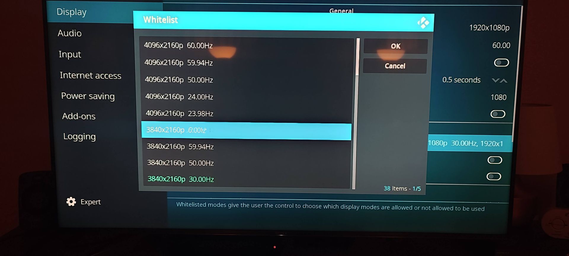

    I added that line and then rebooted. I don't think that it might have added that refresh rate as I see this....
    See file "limited refresh rate available"
    and also I ensured that the HDMI port is set to FULL range. The cable is ok for 60Hz and 4k.
    I have whitelisted all available 4k modes, but 60Hz is not there.
    I have seen an odd post or two where such issues of attaining 60Hz at 4k seems to happen, not sure if that is something I could resolve..?

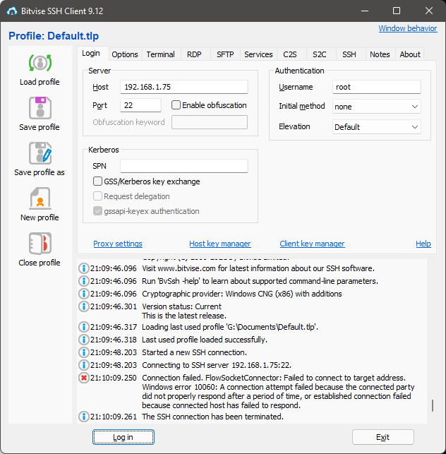

    Ok I added the above the the update folder. The first issue, before it updated, is that the re-boot function isn't great. That often results in the Pi rebooting, coloured square screen showing, and then a black blank screen. No SSH is possible at that stage.
    Powered off and on a couple of times and then it booted, and updated to the latest version as linked. Powered off for a while and then a blank screen after the initial coloured square splash. SSH shows this at this stage....Photo attached.
