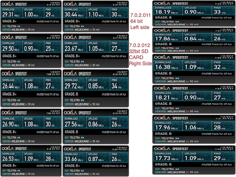

    Observation regarding the wifi on this box.
    Comparing 7.0.2.011 64bit which is installed internally the wifi speed is significantly faster than
    the 7.0.2.012 32bit SD Card on this same box.
    I am running both versions on this same box.
    I have done over 20 speed tests on each version using the speedtest addon and results attached .
    I think the attempt to fix Bluetooth on this chip may have caused this ??
    I am not sure but i am reporting the observation.
