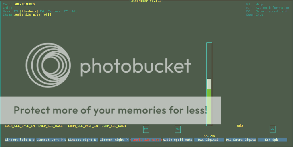

    Bug: No output from AV jack.
    Device: (Tomato?) X96 s905x 2G/16G connected to various amplifiers via both original AV cable and standard 3.5mm to RCA cable.
    Affects: 7.0.2.009 and all devel versions up to and including 11/26/16
    Notes:
    AV out DOES work in original Android firmware
    HDMI audio works perfectly (except for pops on connect/disconnect which has been reported elsewhere)
    SPDIF (optical) has not been tested yet (waiting on D/A converter)
    In LE i2s and spdif are muted by default in alsamixer.
    Unmuting or muting i2s causes a popping in any device attached to AV jack via either the included AV cable or a standard 3.5mm audio cable. The same popping also occurs anytime the soundcard wakes or sleeps and can be heard through the HDMI audio stream as well.
    Increasing "DAC Extra Digital Gain" above 0db causes a very faint hissing to be heard from devices attached to AV jack.
    Speculation on my part, but the hissing at very high gains seems to indicate that a signal IS being output via AV. However, it seems that the Kodi audio stream is somehow not being routed properly.
    Logs and additional info:
    Screenshot from alsamixer before unmuting i2s and spdif:
    Full Log Set from clean install (system booted, liveTV stream started (mythPVR)): Logset 11/26
    I think this is going to turn into a full bug report soon. Seems no one else is having this issue.

    Analog audio in S905X is via T9015 codec which seems to have mapped correctly on your device. What kind of audio cable do you use? With my S905X device a standard 3.5mm plug is working well. Can you confirm that analog audio works for you in Android?
    Although I now have LE on NAND, analog out was working with android during the brief time I was testing.
    I have discovered through alsamixer that Audio i2s and Audio spdif were both muted. When I unmute/mute Audio i2s in alsamixer I can hear a thud through my amplifier, but no further output. Maybe i2s has a hidden mixer control which is currently set to 0?
    [hr]
    Hmmmm... only controls for i2s and spdif are MONO switches.
