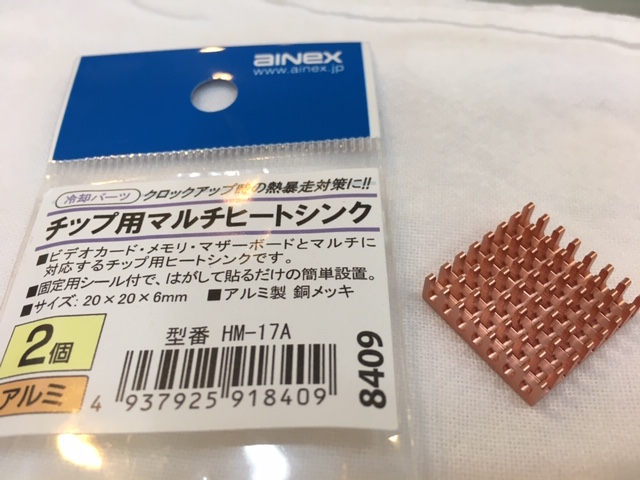

    Now for the heatsink: Locally, I found a small, fairly lightweight, copper heat sink (20x20x6 mm). With just that guy, the max temp (gputemp / cputemp) I’ve reached by just playing videos is about 52°C. While playing video AND updating a large library over the LAN, the temp leveled out at 60°C.
    From what I read at the pi site: “...the CM3+ has better thermal behaviour under load. It has more thermal mass and can draw heat away from the processor faster than CM3. … longer sustained operation under heavy load before the processor hits 80°C and begins to reduce its clock speed.”
    My 52-60°C seems like a reasonable enough range?
