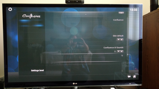

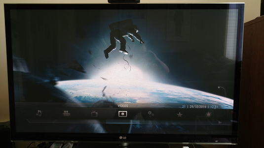

    All seemed to go well initially, but at start up, I get the KODI splash screen flashing (on & off, but not quickly). Eventually I get to the main screen (but after a longish wait). Once at the main screen I can tell my settings aren't preserved (temp in C and date format is non-US), plus, many of the onscreen menu items are no longer visible on the screen, even when highlighted (maybe just a text color issue as the functionality is still there). I tried changing the Skin from Aeon Nox back to Confluence, but it's not made a difference.
    All the functionality seems to be there.
    I've attached a few screen shots and the output from "dmesg" in case that provides any hints.

    2) Even once I got to the main screen (on that first update), many of the labels were "blank/invisible". I use the Aeon Nox skin, but even changing to Confluence didn't seem to make a difference.
