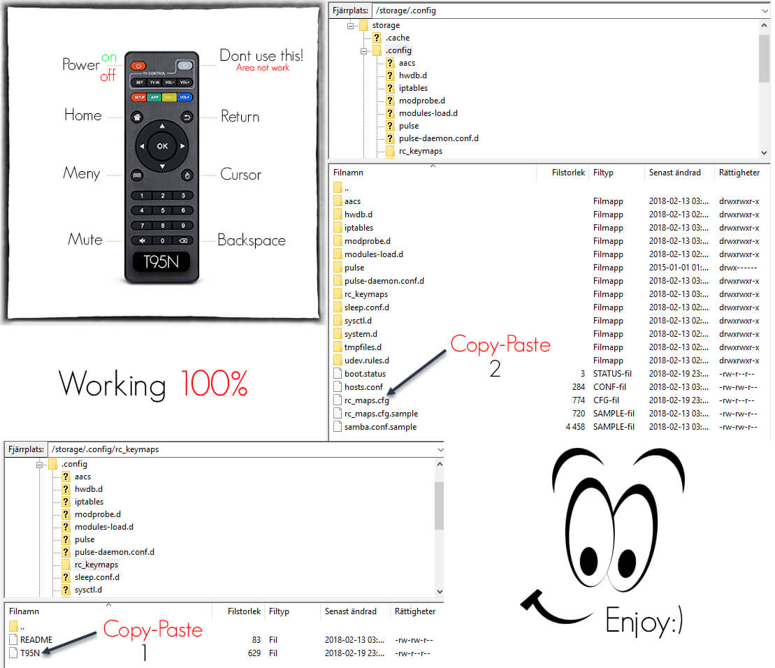

    @CtrlAltDelEnter Why do you copy the files with Filezilla over SSH and not just copy them on samba shared folders?
