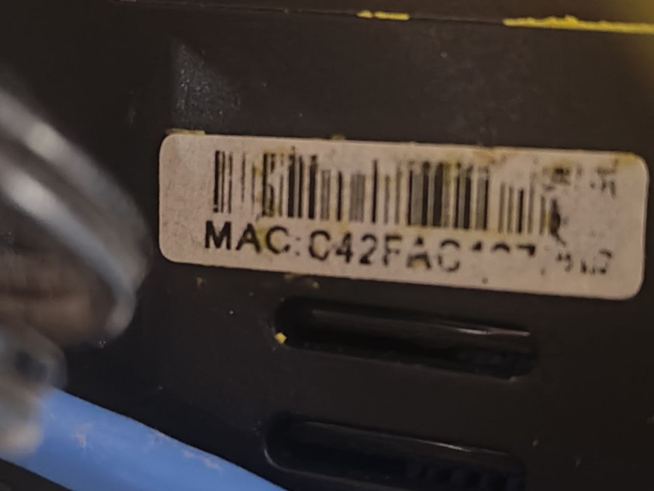

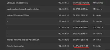

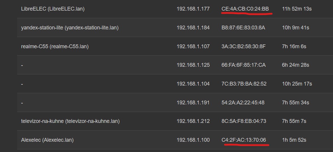

    On the old firmware, the box had MAC C4:2F:AC:13:70:06, which matched the label on the case.
    After flashing your firmware, the MAC changed to CE:4A:CB:C0:24:BB, so the router assigned it a different IP. That made it look like ping was permanently lost.
    Now everything works perfectly, and I'm absolutely thrilled.
