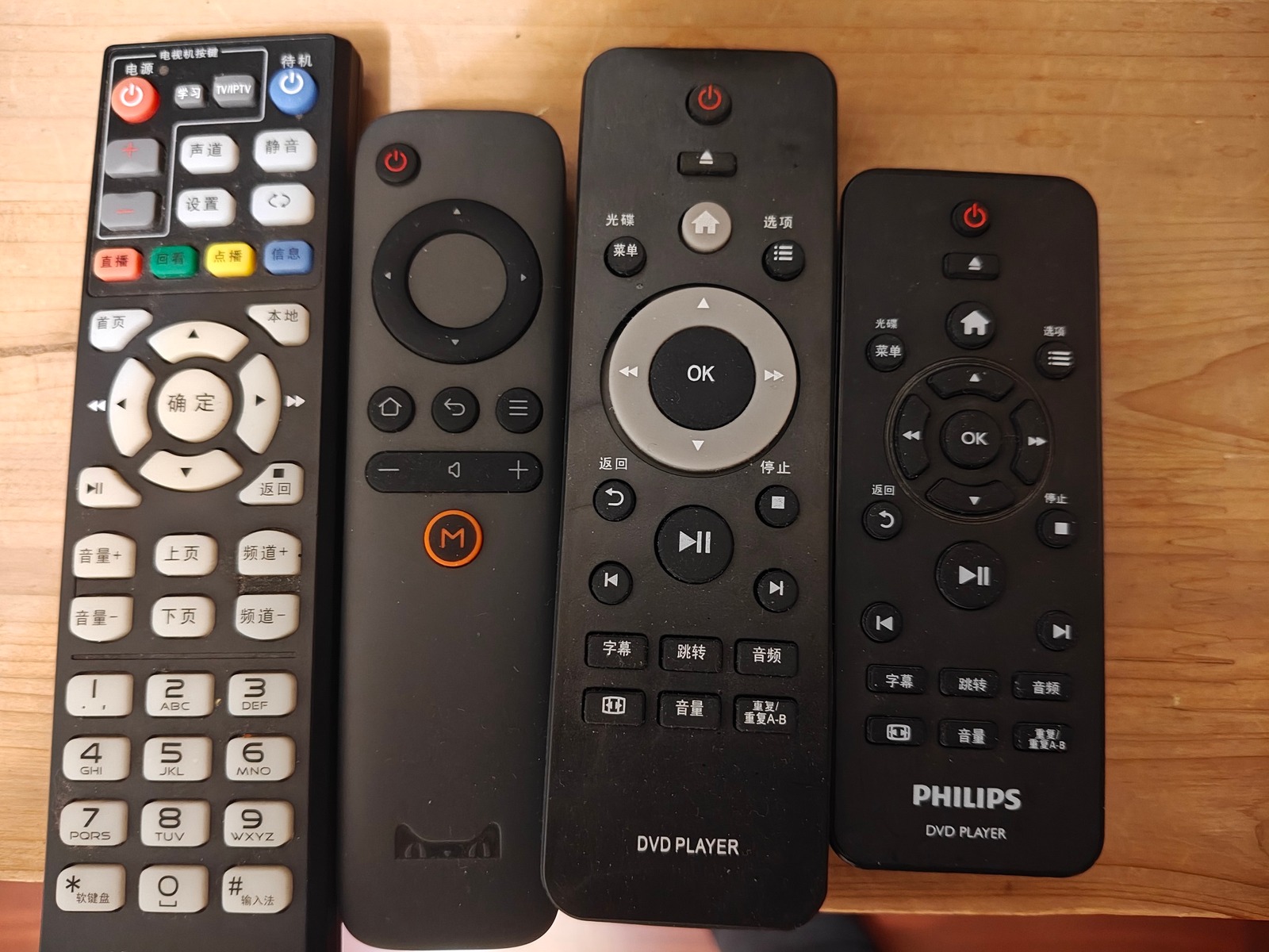

today I try my 4 remote control by remote.conf, and get root cause why some remote no event in log
the left 2 remote can work by the method, but the right remote cannot work and have no event in kodi.log
while as all of them are functional, and I also test all of then in LE 12 with meson-ir
and I found that, the workd 2 with NEC protocol, and non-functional 2 with RC-6 protocol
it may caused because amremote or eventlircd not configured with all protocol support by default
to shared this experience
thank you
