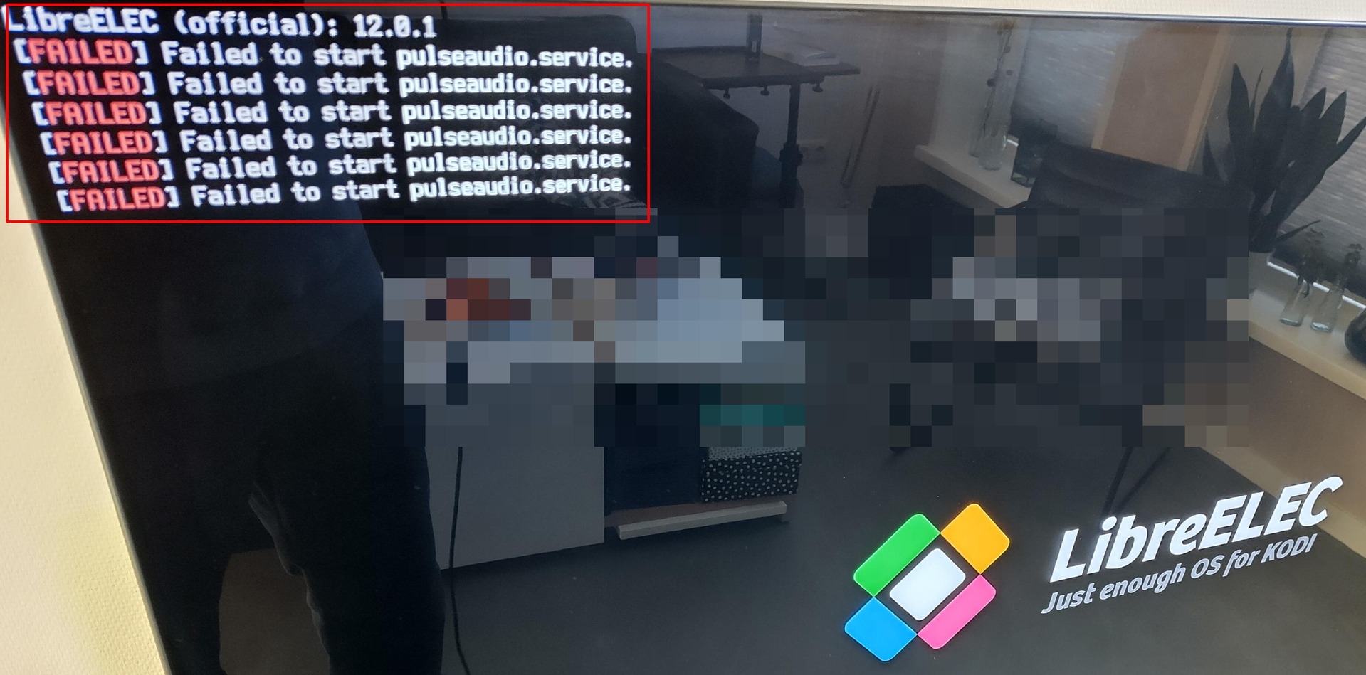

    I know in the picture it says LibreElec v12.0.1 but that's after downgrading because in 12.0.2 this occured as well. I have updated to 12.0.2 again but no change.

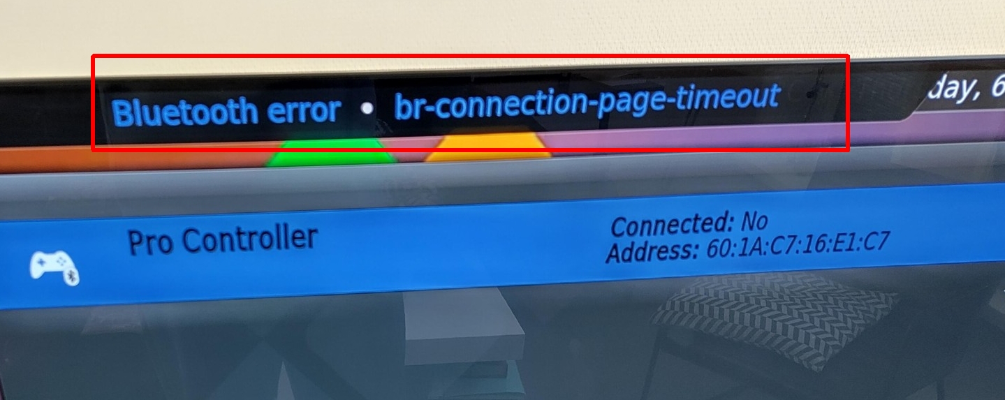

    I am making progress, the systmemctl commands worked, I dont see the Pulseaudio errors on startup anymore. Also I finally managed to connect a controller that stays connected, however communication seems sluggish and unreliable. I am getting somewhere, much thanks for the support thusfar.
    Hi, I'm new to the forum. I don't see myself as a total nitwit when it comes to IT but this issues has me in its grip.
    I have installed LibreElec on my Raspberry Pi 5 (with HiFi Berry XLR addon board). When I start it up the first thing catching my eye is this repeated message:
    Google searches on this issue did not get me an answer or fix for that message. I have read about Pulseaudio and to me it seems I'm totally fine without, I will not be using Bluetooth Audio from or to the Raspberry Pi. I do however want to use a bluetooth controller, to wirelessly control KODI. I have tried a number of different controllers including the 8bitdo SN30 and Nintendo Pro controller. LibreElec finds the controller, attempts to connect but then issues an error message:
    Needless to say, after getting this error, the controller does not work.

    - Can anyone help me fix the Pulseaudio error I'm getting on boot?
    - Can anyone help me find a solution for the br-connection-page-timeout issue and get the controllers to work in LibreElec?
