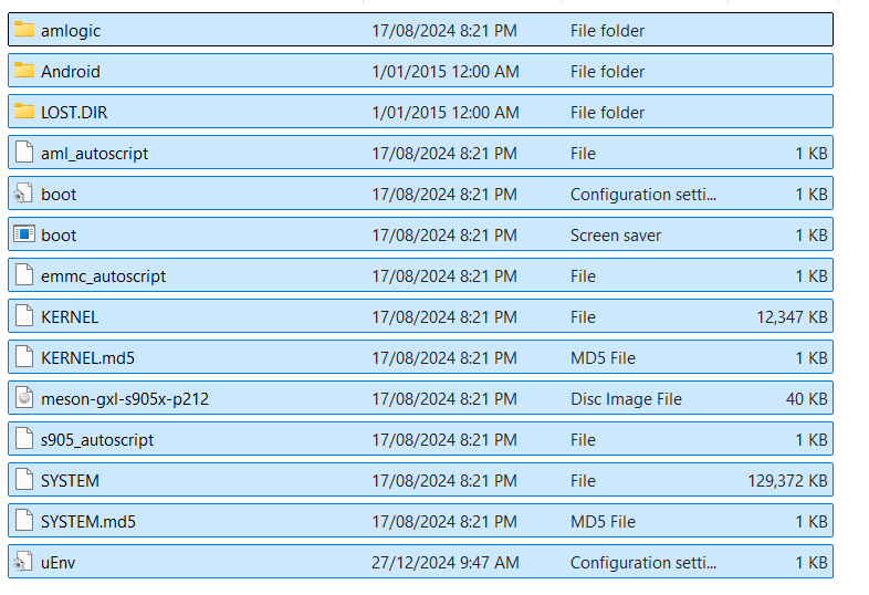

    The 'Android' and 'LOST.DIR' folders were created by Android during recovery boot, it's harmless.

    1). After the previous process I have notice in my SD card folders have another 2 folders 1).Android & 2). Lost.Dir. been added and I am unsure how has been added. I am not too much concern if that's nothing relates to or if its a common? I have attached photo.
