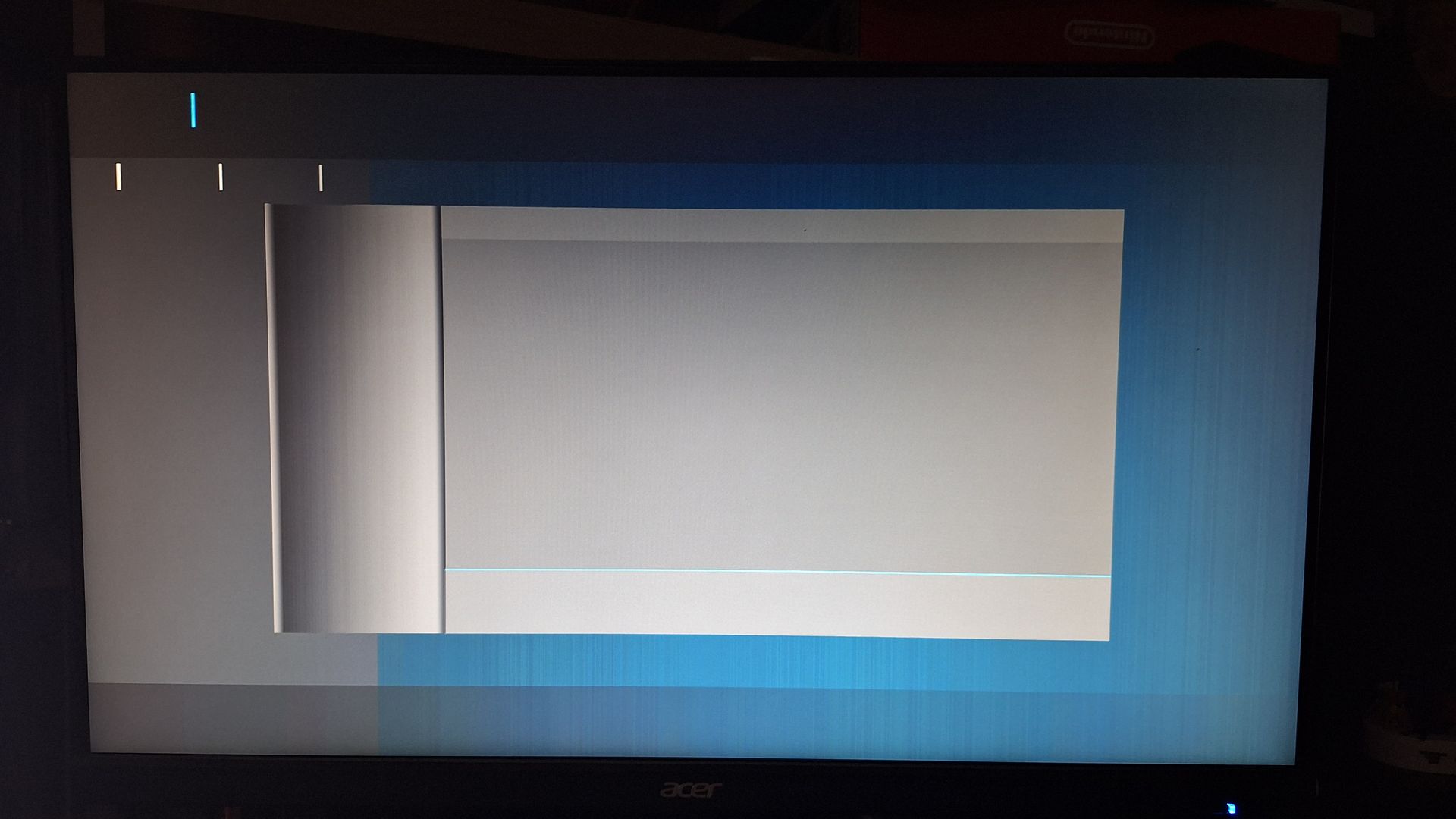

I have to apologize now - the nightly worked on the second attempt and I am in the (recognizable) KODI configuration menu.
Thanks for the help - in my opinion the thread can be closed. If I have further problems, I will create a new thread with the logs.

I tested the latest image ...RPi5.aarch64-12.0-nightly-20241205-f894320... Unfortunately I still get the same error.
I would like to create the log - but it will be a bit difficult to set it up without a console/interface. Is there a way to activate the log via the config/distroconfig file?
thank you very much for your help so far
Hello forum community!
Unfortunately my PI4 broke down when I was about to get my LibreELEC / Kodi to work perfectly. I have now got a PI5 / 8 GB (the PI is in an Argon ONE V3 and other systems should also run on it - separately).
Unfortunately I have the following problem after booting - this screen is displayed (1st image). Something happens when you press a button - but nothing "recognizable" is displayed (2nd image).I have already tested:
Installation
- LibreELEC USB-SD Creator x64 -
- PI Imagervarious images
- LibreELEC-RPi5.aarch64-12.0.1.img
- LibreELEC-RPi5.aarch64-13.0-nightly-20241206-81ab9da.img
--> Raspian PI OS works without any problemsother SD cards / USB sticks
HDMI cable swapped
various monitorsCan you give me a tip on how to solve the problem?
