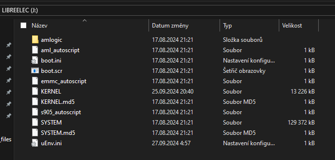

Hello, I am trying to install different versions of libreelec on my box. However, every time I try to boot from the SD card my box stalls in bootloop and never actually boots. I've also tried booting Armbian and it runs without a problem. Please would there be any advice on what I am doing wrong? I've also tried installing to different SD cards but that didn't help. I'm desperate
