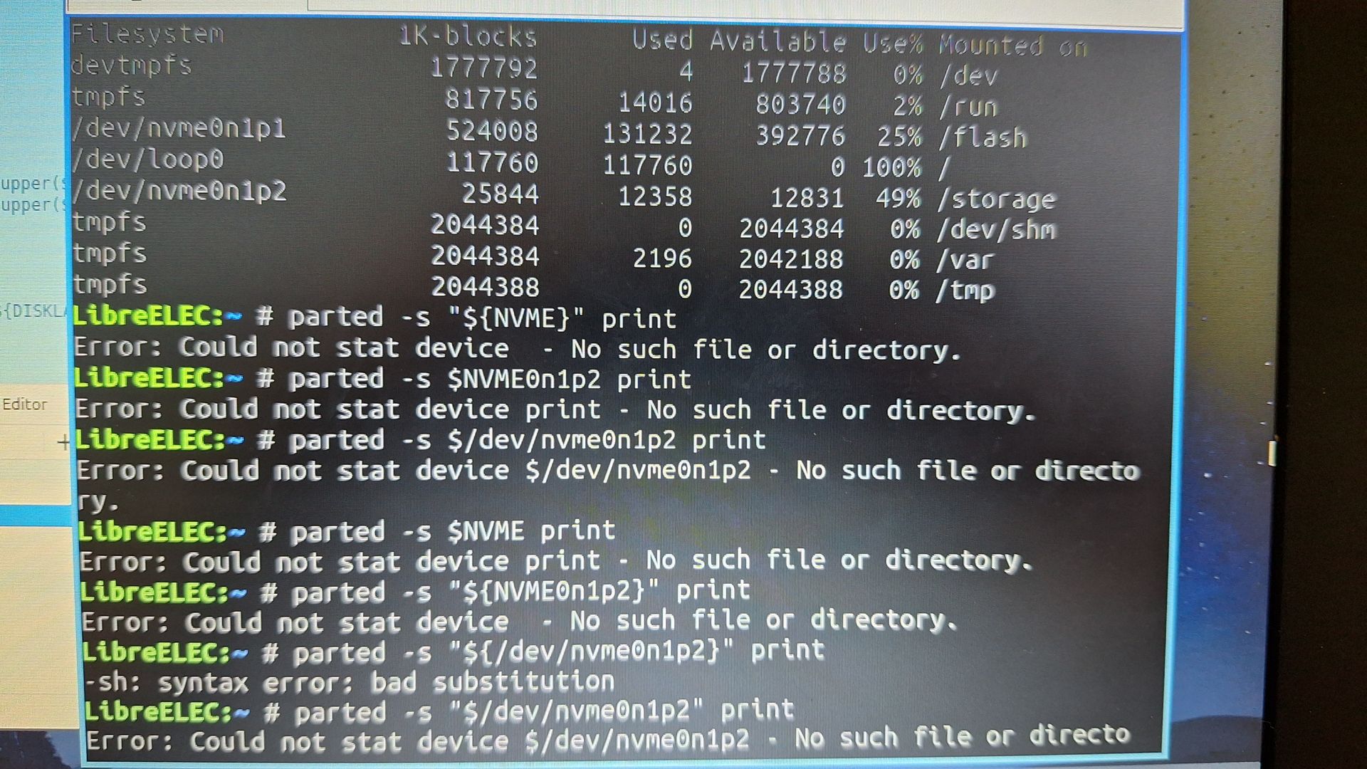

    I am NOVICE when it comes to Linux. I've build a Linux laptop to learn on and that is about it. I keep getting error messages as I do not believe I am correctly entering the information you provided.
    Any additional help and guidance is appreciated. Thank you.

    Thank you! Should be as easy as copying this into SSH, correct?

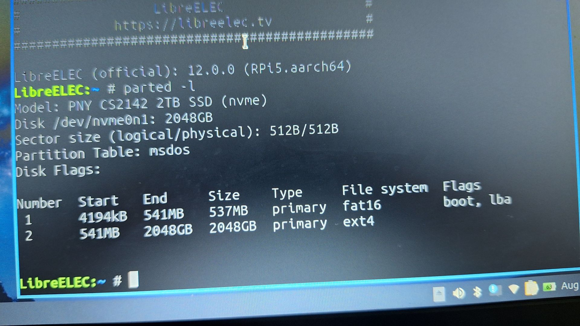

    I appreciate all of the help here. I was able to create a new partition and allocate the remaining 1.8 TB to it. However, everything continues to try and store on the partition that was created upon the first "power on" of Libreelec.
    To your knowledge, is there a way for me to save files to that newly created partition? It seems like there is no way to customize this, however I am not certain and clearly a novice as you can see.

    After about the 12th re-write, I am now having issues with Gparted. I keep trying to allocate the 1.8 TB of unallocated to the dev2 storage partition, only to get error messages every time.

    I have checked multiple times. There is over 1.9 TB of primary partition available. Libreelec resized the partition on its own after I re-wrote the SSD with the OS for the 7th or 8th time. I do not know what to do any more. I need some serious help because there is no way I'm not understanding this.
    Maybe you have to resize the storage partition. You can use GParted on your PC, with the LE SSD attached.
    It had the OS in one partition, and a 2nd partition was unallocated. This seems to have been the problem. Gonna try to allocate the remaining storage and see what happens. I tried with exFAT the first time and Libreelec wouldn't open as it detected an error on the storage device. I guess I can set it up as NTFS, although that is windows only and this is technically a Linus kernel. Unfortunately, the only 2 options I have are exFAT and NTFS.
