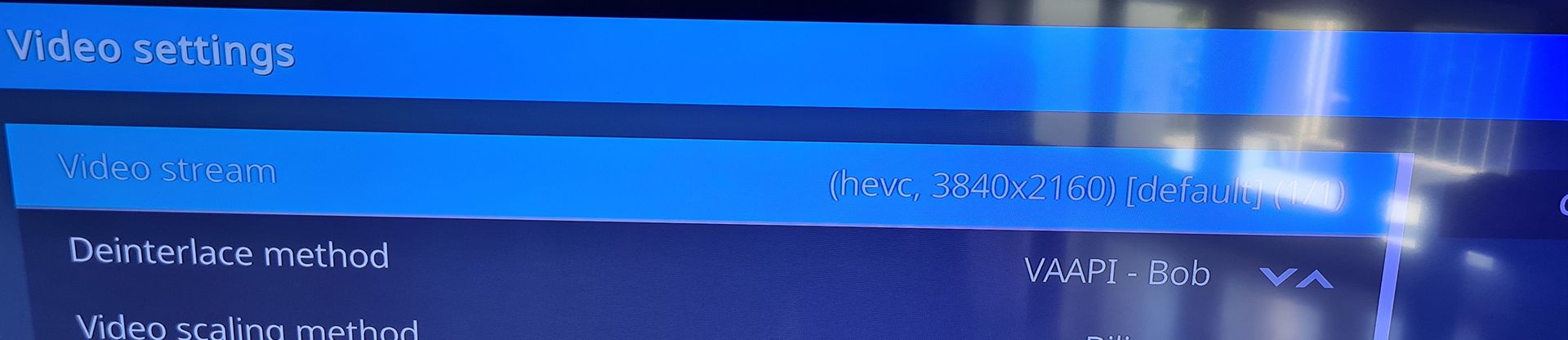

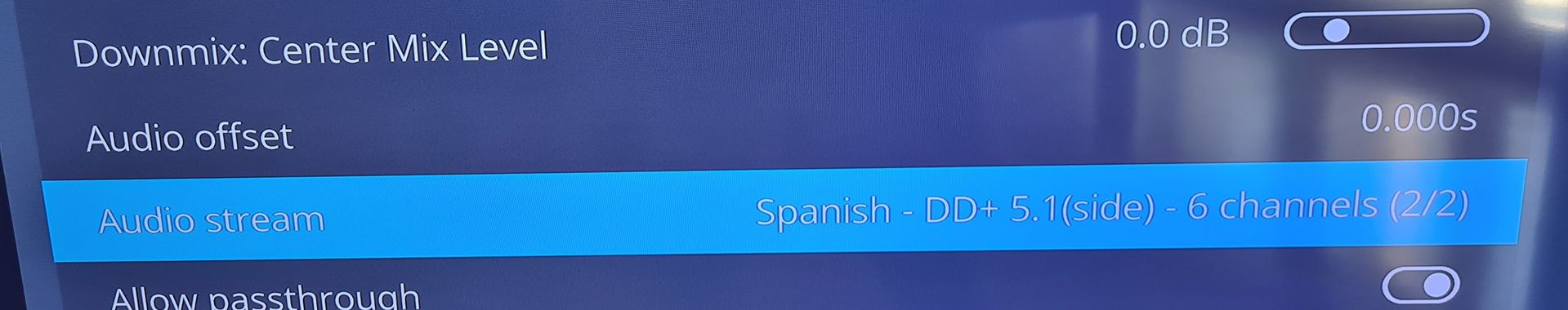

i performed with the 4 test/sample files from Samples - Official Kodi Wiki
only at [1] HDR is missing, but it should be or?

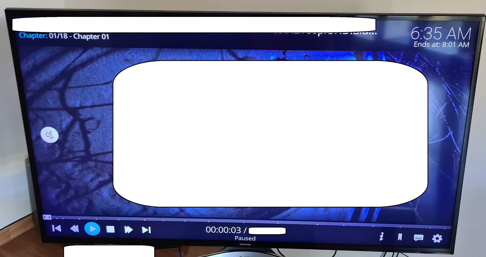

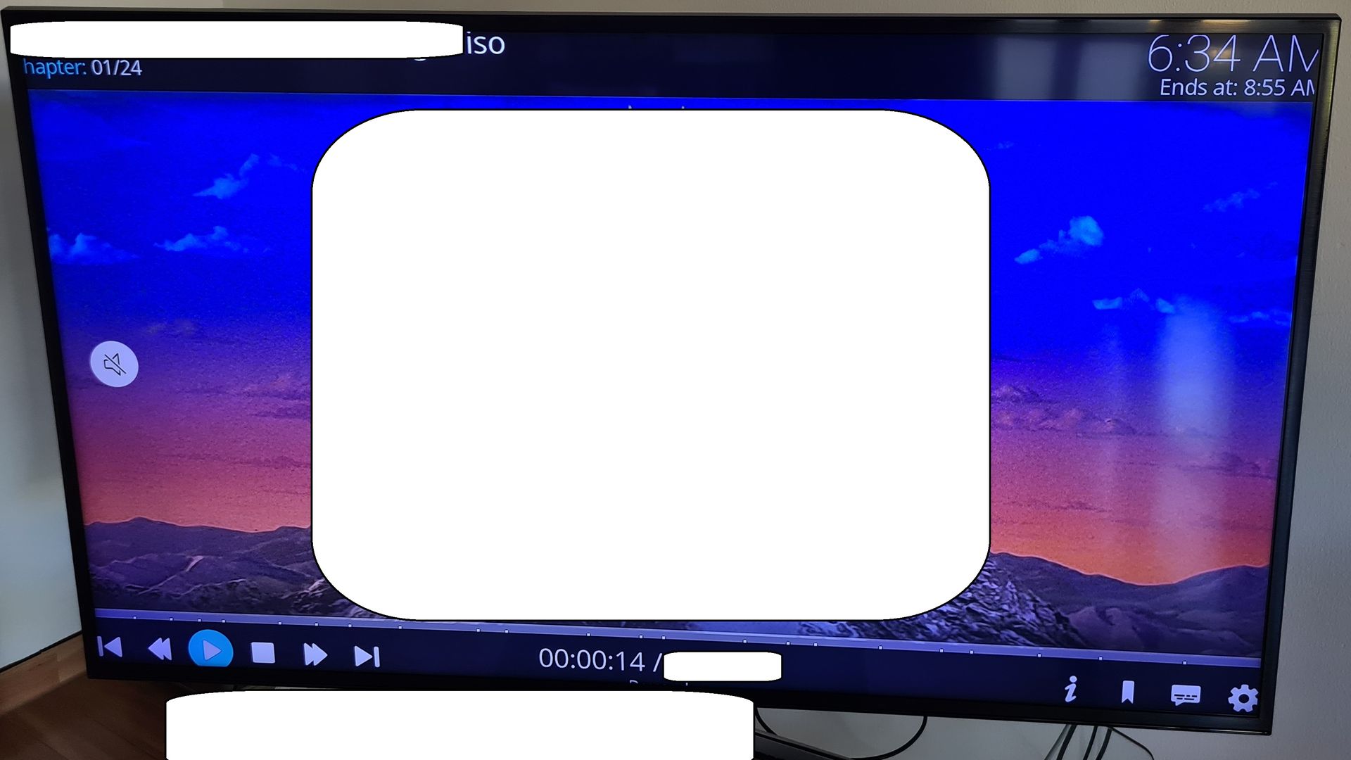

when i play 1080p movies (tested with *.mkv and *.iso), the GUI resolution is cut, doesnt proper shows the elements at the edges. the first two photos shows playing 1080p video. the last photo 4k. with 4k movies no issues.
further, the focused/selected item is more bright, in compare of none playback. the brigtness issue happens at every movie file.
KODI GUI is set as described in the LE wiki, including whitelist and refresh rate adjust.

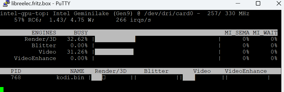

i'm using the same device, with N4000 CPU. therefore i want to ask for the result.
i cannot confirm the described behaviour with dropped frames at the KODI GUI, but i like to have optimized LE for t430.
did you compile a custom image without 'projects/Generic/patches/kodi/000-temp-revert-fences.patch' ?
and did you changed the GPU frequency?

the generic 'LibreELEC-Generic.x86_64-12.0.0.img.gz' is installed. HDR label is shown at the according 4K files. the samsung tv UHD color option is not working, like with legacy image, only when this option is disabled its working.
Make sure your BIOS is up-to-date. If your hardware support page offers video driver updates, install the latest. They sometimes include firmware for the LSPCon driver. You probably need Windows to install those updates.
However, as next i'll install the Generic LE, i'll report the outcome.
next question is raised ... w/o UHD Color no HDR is available.
samsung shows the info only with UHD and the HDR label is missing.
as i understand, only Intel UHD 620 and newer is with HDR?
the UHD 600 is able to decode HEVC h265 8 and 10 bit, so it should have HDR?
when i install the (none legacy) generic will i get HDR?
