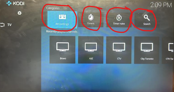

Now I am tasked with preparing a pi for an area with senior citizens who are also invalids. So, I need the remote and Kodi UI very very easy to use and paired-down so to speak. I need the channel up/down to work. I don't want extraneous PVR things like Recordings and Timers and such. I just want the Guide and Channels.
The last one we set up as IPTV Simple Client, because it is an IPTV feed. Do you have any suggestions to help me make the next one even more user friendly?

Okay never mind then. Thank you for the help though. I wonder if you could make an option in future releases to remove those easily with a toggle setting? Fo*d for thought.
chewitt , are you sure? I installed the node editor but see no 'Recordings' or 'Timer' or anything like that
chewitt , Never mind I figured it out! Thank you so much! Mission accomplished. You're awesome.
