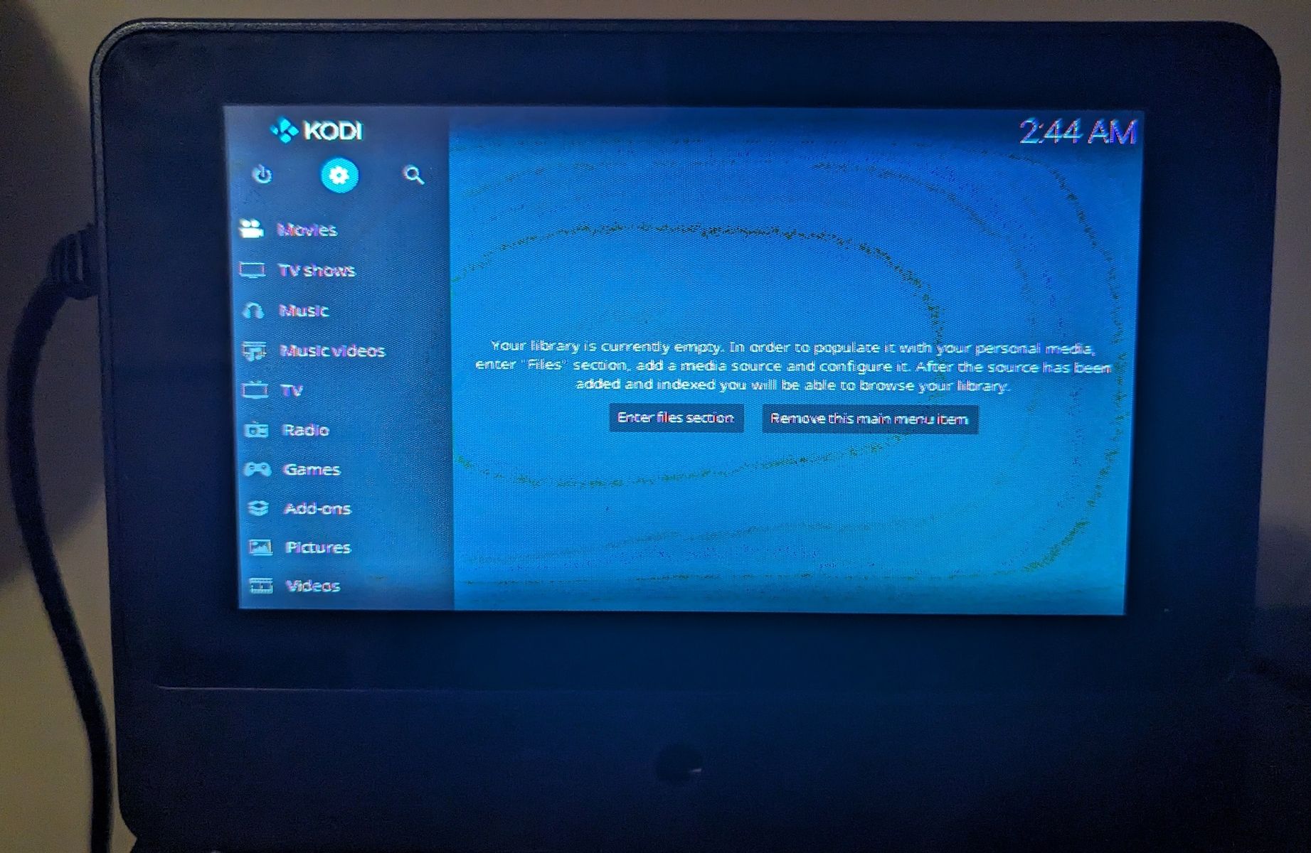

I have a Pi4 with the official touch screen and I just upgraded to LibreElec 12.0. Now the text in the UI is barely readable and sometimes there is a flicker on the screen. This problem didn't happen in 11.0.6. I also tried wiping the SD card and installing from scratch but that didn't help. I also made sure to upgrade the firmware.
