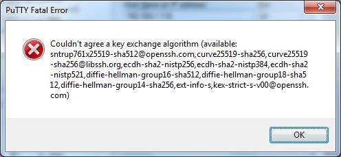

How old is the version of PuTTY?
Yes, you are right, I had an older version of the program. I updated it, but now when I enter the root login a window appears and the connection is terminated at that point
Thanks, it worked. Everything works!
