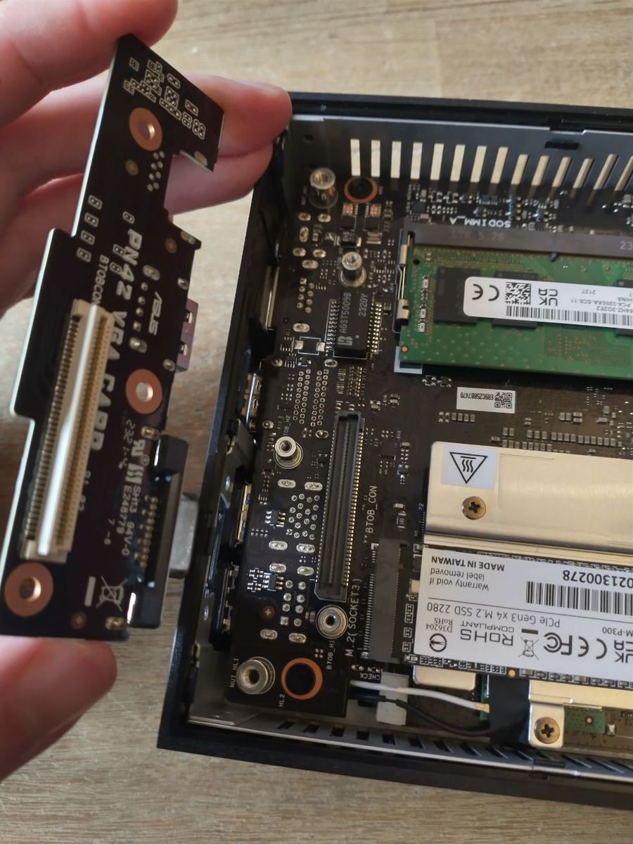

Took it apart, no CEC headers visible that are easily accessible on the ASUS PN42 (See attached).

I'll probably take mine apart at some point to see if there's a CEC header as the BIOS seems to suggest. If it's there and the header seems to match what the Intel NUC's use, I'll get the Pulse8 adapter for it and test. Ofcourse, I'll also share pictures for the community to see
I probably am not the only one that wants this.If it doesn´'t have the CEC header, I'll try to see if I can get a response from the Pulse8 team, asking if the CEC Adapter is compatible with HDMI 2.0b (or newer) and thus would not disrupt any 4K60 UHD (or better) content. Otherwise, I'll get a wireless keyboard that uses a dedicated RF transmitter which does not rely on the OS. Those should be able to wake up the system.

The more interesting detail however: When you look at the HDMI-CEC feature in the BIOS, the "Help" for it indicates that you need to disable it in the BIOS to be able to use any device connected to the CEC header. Did you, per chance, take a look inside the device to see if you can find such a header?
Having a CEC header available could potentially resolve all the CEC limitations this device has by adding the Pulse8 CEC module for Intel NUC's.
