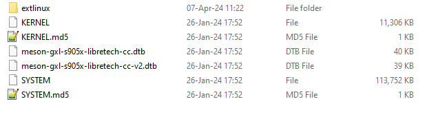

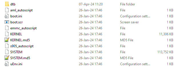

    I noticed, that the files on SD for generic s905x and those of VIM1&Le Potato are totally different! Is that the reason tha generic images don't boot?
