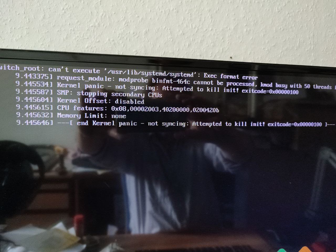

Dissecting the SYSTEM file from a broken and a working .tar file reveals:
file usr/lib/systemd/systemd
LibreELEC-RPi4.aarch64-13.0-devel-20250803115117-88c8e3c
systemd: ELF 64-bit LSB executable, no machine, version 1 (SYSV), dynamically linked, interpreter /lib/ld-linux-aarch64.so.1, for GNU/Linux 6.12.0, stripped
LibreELEC-RPi4.aarch64-13.0-devel-20250628054217-b3719f8
systemd: ELF 64-bit LSB executable, ARM aarch64, version 1 (SYSV), dynamically linked, interpreter /lib/ld-linux-aarch64.so.1, for GNU/Linux 6.12.0, stripped
notice: "no machine" versus "ARM aarch64"
The same is true for these .so files in usr/lib: no machine

I have had problems lately building from LibreELEC.tv git master repo for an RPi4. It will generate a .tar file but after upgrading it would not be able to boot but would tell me it could not load the system (sorry, I did not make picture). Until now I thought it could be related to the OS I am using (Gentoo Linux).
see: https://cant-create-working-upgrade-tar-file-for-rpi4-with-gentoo-linux
This may be gentoo related and I can not figure out what is going wrong:
The Bildsystem with PROJECT=RPi DEVICE=RPi4 ARCH=aach64 make runs through but the resulting binary wont boot.
