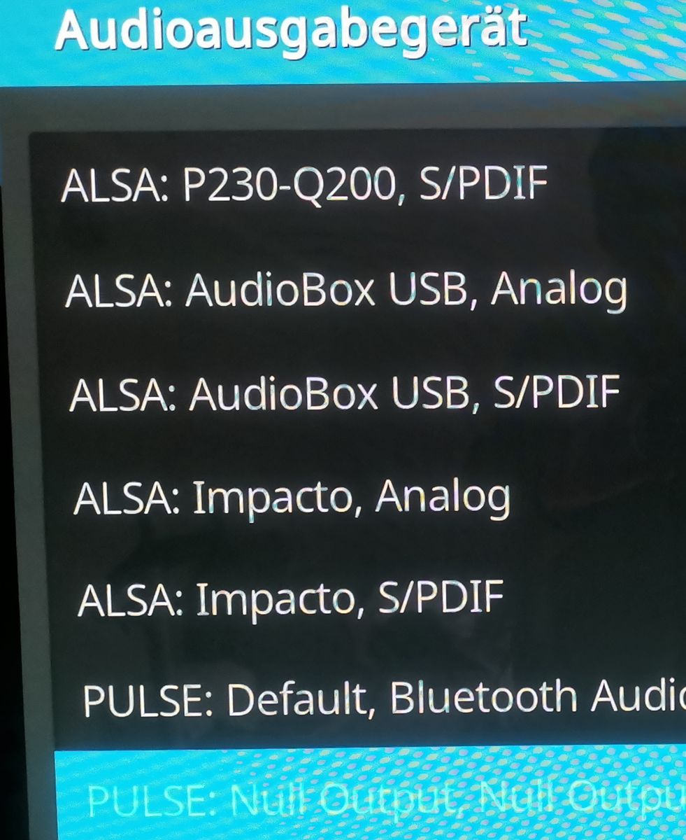

    It works!
    I added both USB DAC modules (device_id=USB and device_id=Impacto) to the startup.sh script :
    # Provide ALSA output
    pactl load-module module-alsa-sink device_id=Impacto >> $PULSEAUDIO_MODULES_FILE # Impacto
    pactl load-module module-alsa-sink device_id=USB >> $PULSEAUDIO_MODULES_FILE # AudioBox USB
    pactl load-module module-alsa-sink >> $PULSEAUDIO_MODULES_FILE # Hdmi
    now i can switch between the interfaces HDMI, USB Audio DAC and Impacto DAC via .brutefir.config:

    Hello chipfunk,
    I think i need support in getting the Usb-Dacs to work together with brutefir.
    Could you please give me some advice? The name of the Usb-Dac Alsa Devices are attached below.
    In the first place there is no need to operate brutefir with hdmi and usb-dac, usb-dac and brutefir alone would be perfectly fine.
    So maybe you can advise some concrete modifications of the existing standard hdmi setup?
    thanks in advance
