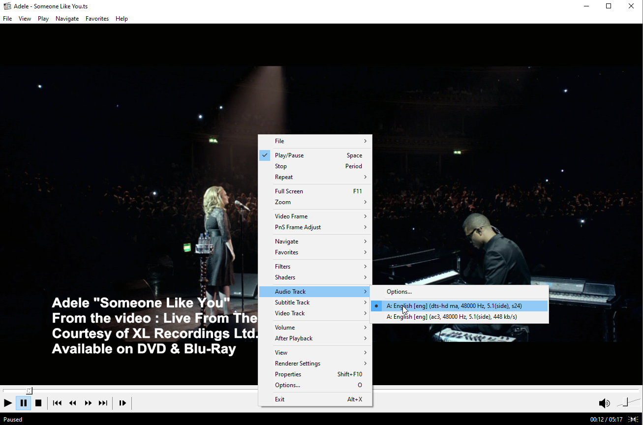

Now in in the attached images, looking at Image 1, you can see that the file has DTS-HD Master Audio soundtrack. That shot was taken on my Windows PC... and I do get DTS-HD there.

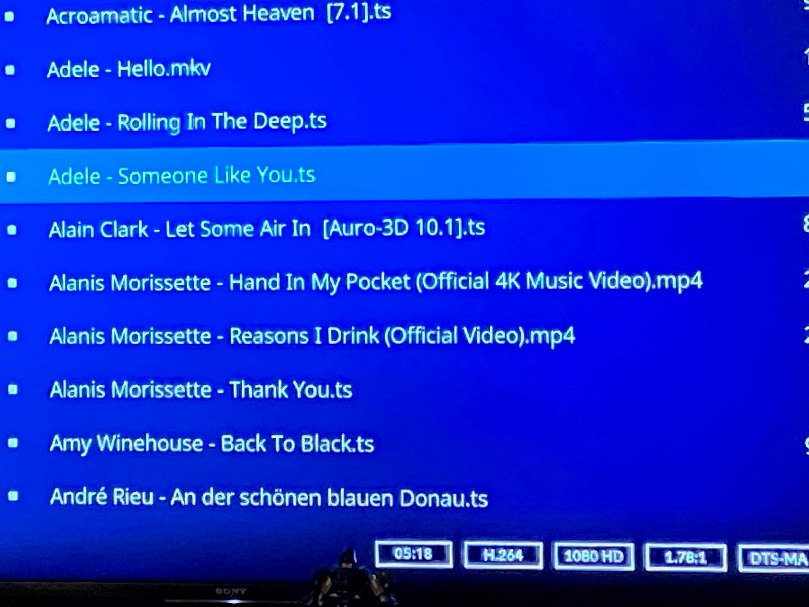

In Image 2 you can see that the KODI file listing it clearly states that it has that HD audio track. Now bear in mind that all of my movies that have the same audio track work perfectly fine with DTS-HD MA and DTS:X IMAX, Dolby True HD etc.

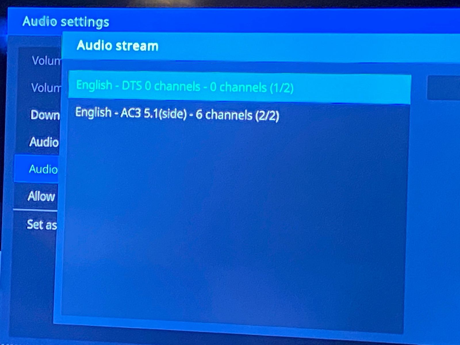

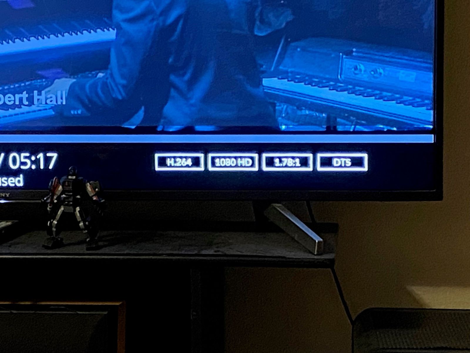

In Image 3 you can see that the file is only playing in DTS. And in Image 4 you can see that I only have Dolby Digital and DTS. No HD tracks anywhere. If I revert back to 19.5 Matrix these files work perfectly with DTS-HD MA.
I also looked at the log above and saw DTS HD Core there, so it's definitely there but for some reason the latest KODI version is blocking music videos HD audio tracks. Really odd I know. All of my music videos that have HD audio won't work with Nexus and I just get standard Dolby or DTS. Where Matrix they work fine.

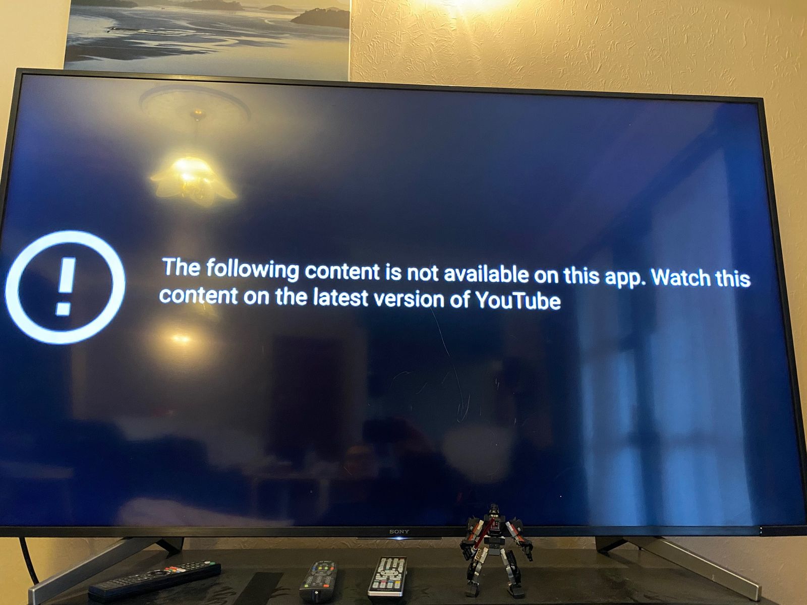

Hi guys
Ok I did some research on the KODI forums and found this link below.
Releases · anxdpanic/plugin.video.youtubeWatch your favorite YouTube content on Kodi. Contribute to anxdpanic/plugin.video.youtube development by creating an account on GitHub.github.comI firstly uninstalled any trace of Youtube on my current setup. I downloaded the version plugin.video.youtube-7.0.5+beta.4.zip
Once it was downloaded on my windows pc, I put it into the downloads folder in Kodi.
I then went to Addons and clicked on Install from zip file. I selected the file and let it install.
I then added my API codes I have backed up via going to \\KODI\Userdata\addon_data\plugin.video.youtube and editing the api file.
I then signed in twice via the code and going to google.com.device
After that Youtube worked. File playback is a bit slower to get started, but I'm getting 4K no worries.
I'm not sure how long this will go for till Google make another change.
So hope this helps... let me know how you go
Dave
Hi guys
I have been running 19.5 Matrix with no issues for years and due to upgrading to an RTX 3050 graphics card, I needed to update to version 11.06. Ok I'm a bit late.
First thing I found is I cannot get YouTube working anymore. I pasted my API codes into Kodi and signed in twice, and I get an error (see attached image). My subscriptions are coming up, but I get that error.
Any assistance with this issue will be fantastic and I'll owe you a beer. I use YouTube with Kodi every night and would love to get it going in 11.06 (and beyond)

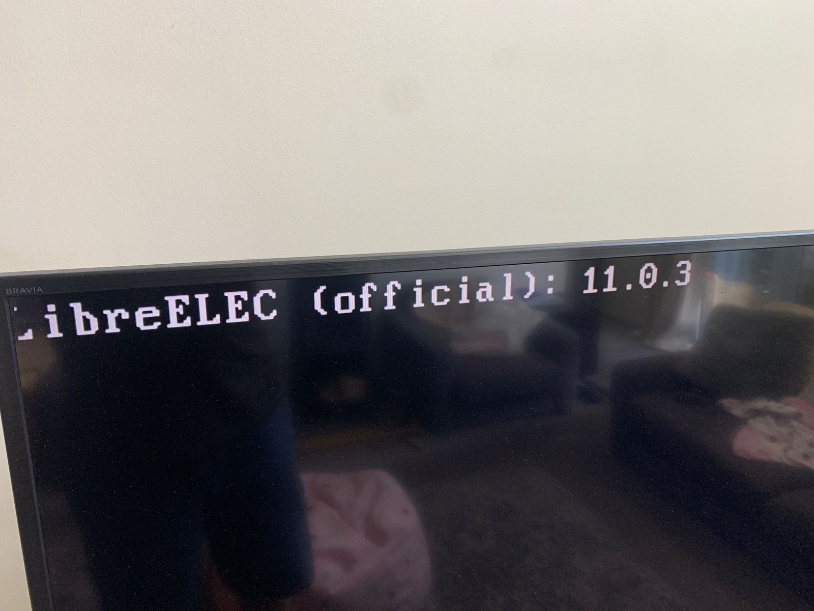

I've been using 19.5 Matrix (10.0.4) for a while and wanted to update to the latest 11.0.3 edition. The current version works real well with 4K, Dolby Atmos, DTS:X working well. CPU is 1150 i7 with a Biostar H81a mainboard. GPU is a Nvidia GT1030 (due to be upgraded soon)
The install for the newer version works well. It goes right through to the end where I reboot, and then the issue starts. On reboot I get to the screen where it says at the top left "LibreELEC (official): 11.0.3" and it stops and goes no further. I tried both Legacy and UEFI installs and the issue is still there.
So I reinstall the older 10.0.4 and it works without any issues. I try installing the newer 11.0.3 the same way and its a no go.
Has anyone here had this issue??
