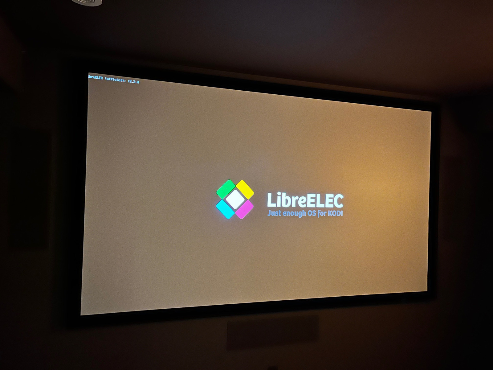

I'm currently running 12.0.0 on an RPi5.
My last two attempts to update to 12.2.0 have failed and when the RPi reboots after the update process the system hangs at the LibreElec splash screen.
Is the manual update from12.0.0 to 12.2.0 considered a major version change and therefore requires a re-install instead?

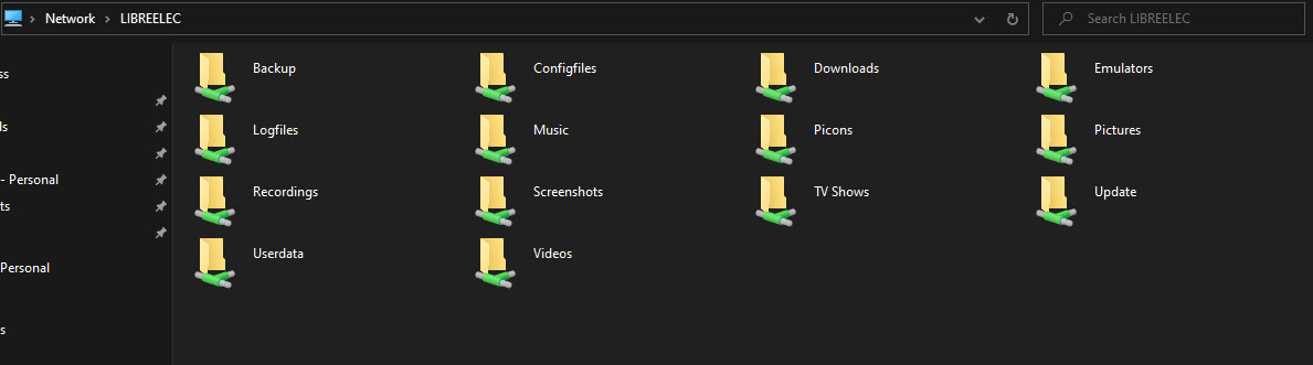

I have a problem with my RPi 4 running LibreELEC 11.0.3 taking literally forever to scan and update new movies.
The KODI.log file shows tons of these errors:
2023-11-01 16:57:56.076 T:948 error <general>: Unable to lookup host: 'myserver-pc'
I read that the proper way to edit the hosts file to add an ip address for myserver-pc is through the storage folder. Is this correct because I don't seem to have a storage folder (attached screenshot)?
