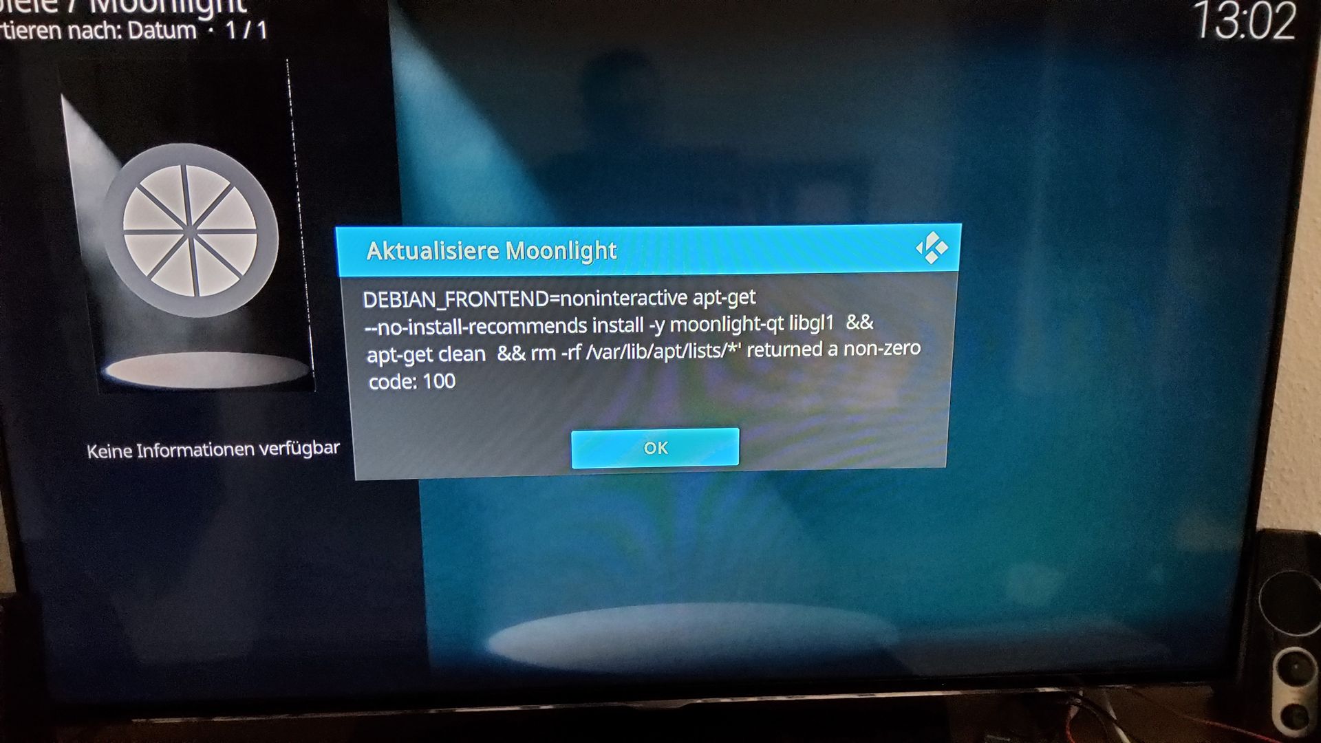

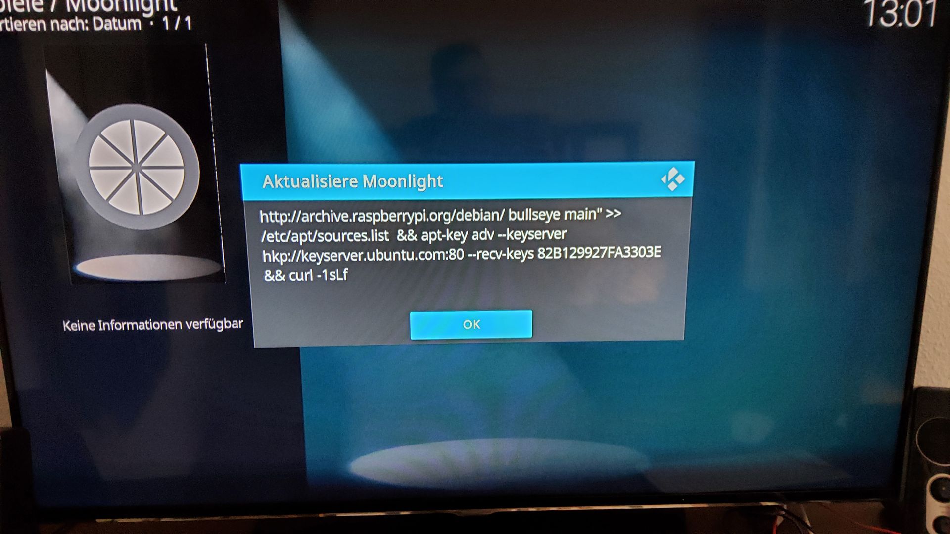

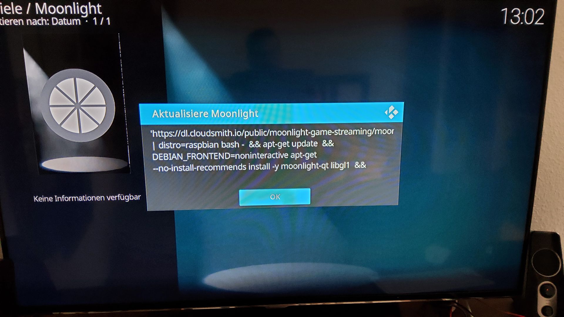

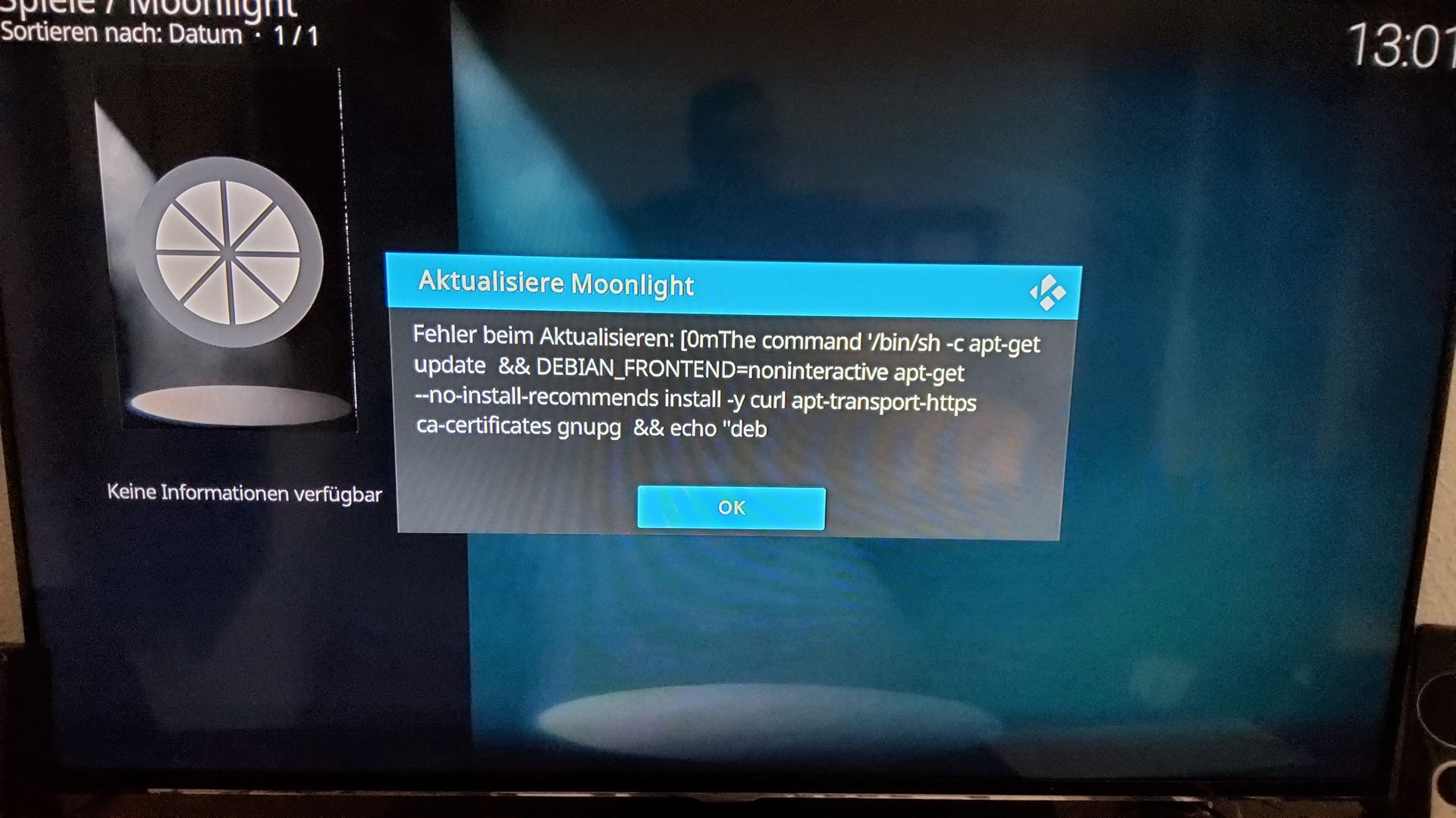

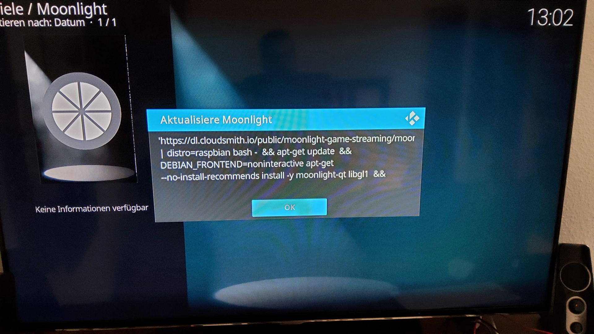

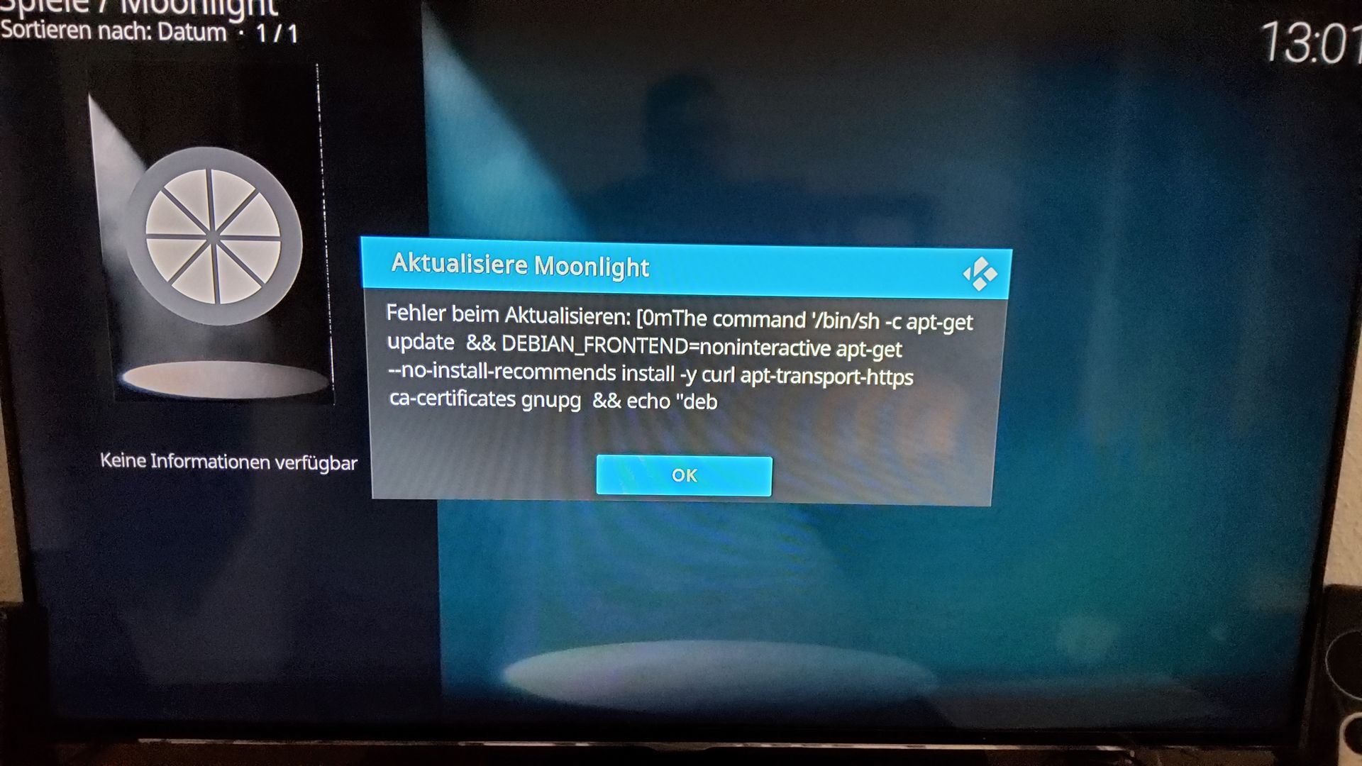

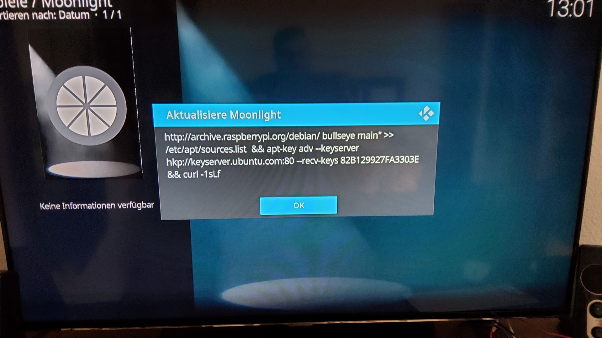

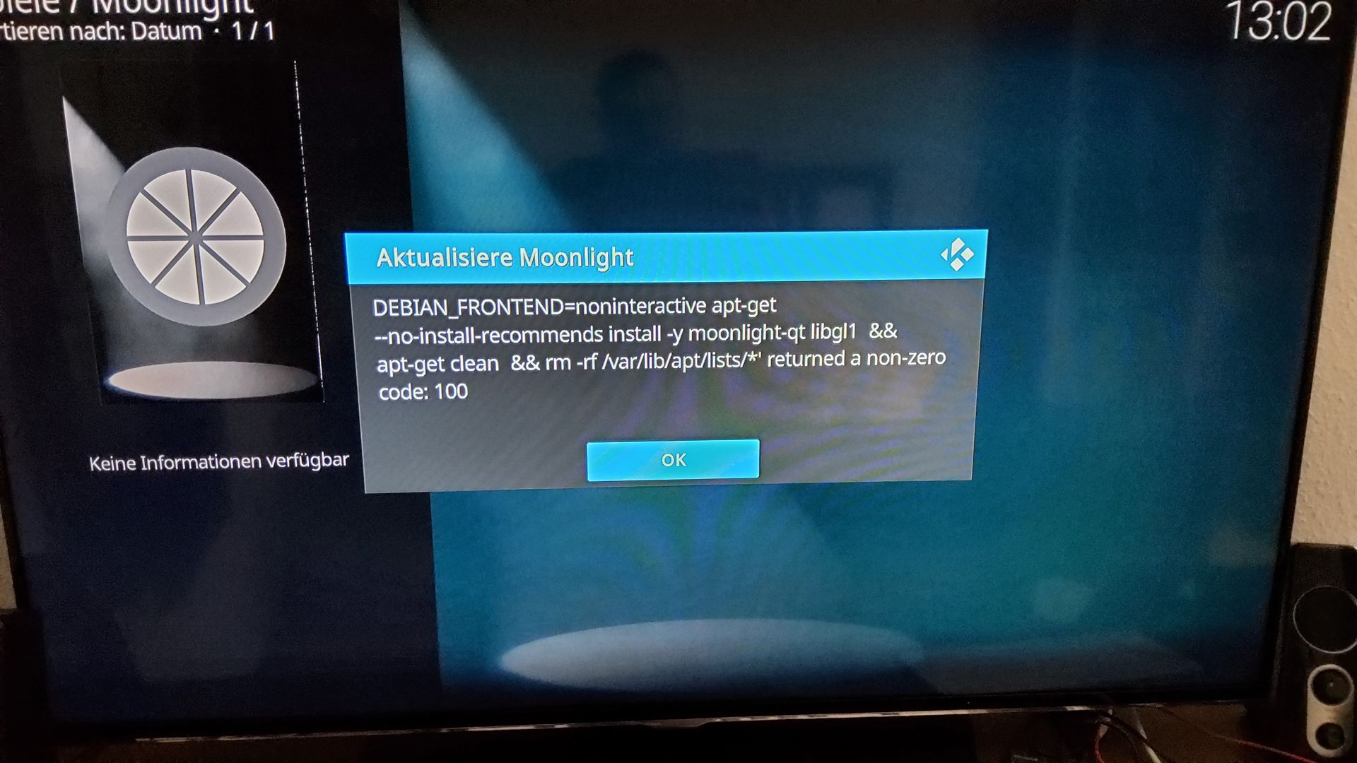

Hello.
Today I tried to update Moonlight-QT from veldenb to the current version under LibreElec 11.0.3, but I always get an abort with an error message. A new installation did not help either. What am I doing wrong? Docker is up to date and running.
