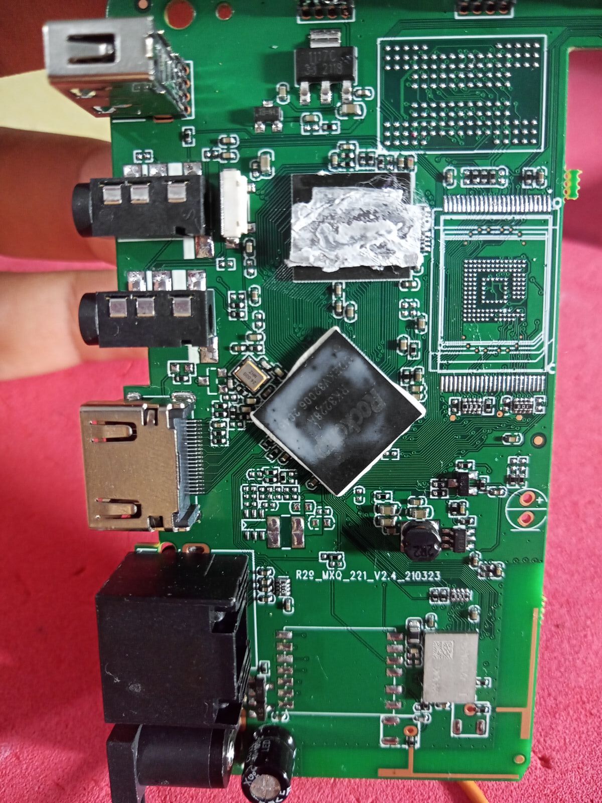

    The Build "LibreELEC-RK322X.arm-11.0-nightly-20231020-2c170bd-rk322x" worked on my TVBOX Rockchip RK3228, 1GB RAM, 8GB ROM, board R29_MXQ_221_V2.4_210323. Only the Wi-Fi did not work because I believe the chipset is the 339s0205, the same as the iPhone 5S. THAKS! :)
