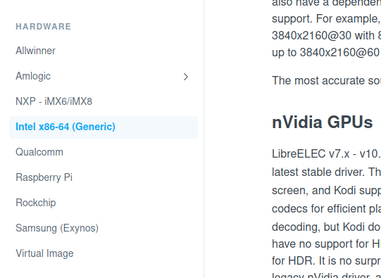

    Unfortunately, even legacy LE is not enough to make Kodi work on my hardware.
    The default (GBM) Generic image no longer contains nVidia drivers due to their lack of support for modern Linux graphics standards.
    Does this mean, that nvidia graphic card is no longer a good choice?
