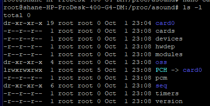

    Whilst still in Ubuntu, went into alsamixer, to see what was available with the sound working, not sure if the below means anything, but these are what are in /proc/asound on ubuntu:
    Back on Libreelec, this is what is in most of the files there, no modules...:
    If I try to edit /proc/asound/devices, seems it's read only.:

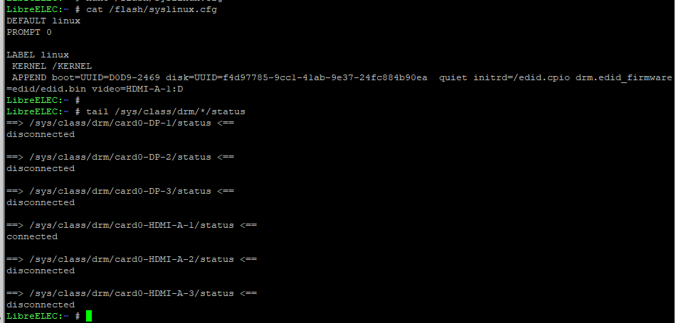

    Right, so I've got a HP Prodesk 400 G4,
    Intel i3 8100
    UHD 630
    I have a really weird issue, where the audio will come out of the inbuilt speaker, but will not route through to my TV.
    I'm having to use a DP to HDMI adapter, which does route audio through on my main PC, just not with Libreelec for some reason.
    I've done some digging, but cannot figure out how to get it to route the audio through, I've tried the EDID config, tried a patch I found on here, with regards to adding a FW fix and a conf file into modprobe.d however, I cannot write the new file to modprobe as it is write only. Tried the usual remount -o rw thing, but that did not work......
    I've tried the latest nightly build I believe by Millhouse but no cigar...
    When I go to Audio settings, I get:
    ALSA Audio
    Default: ALSA Audio
    ALSO: Pulse Bluetooth audio...
    Any suggestions would be greatly appreciated. Let me know what other information is required.
