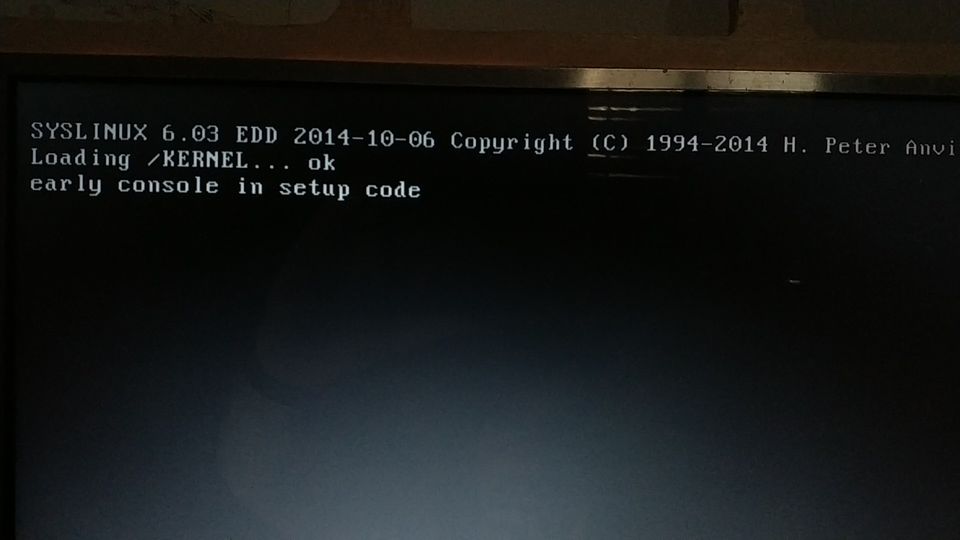

When i enable debug mode during boot it stuck here for the same 1+ min before start kodi
I don't think I saw the usual error ptp_kvm

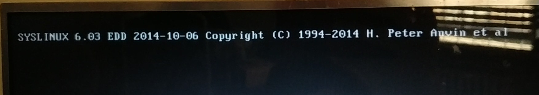

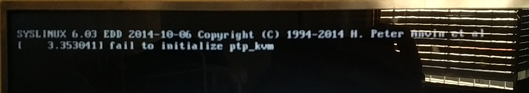

Hi,
during boot time I receive this error.
After POST it stuck here for about 1+ min
then the error appear for a fraction of a sec
and finaly kodi start as nothing was appended.
I have install LibreELEC Generic legacy 11.0.3 on my Packard Bell EasyNote TM85 JO 198IT with a 64Gb Kingston SSD and 4Gb RAM
Here some logs:
dmesg (you can se the error at [ 1.300040] fail to initialize ptp_kvm)dmesg.txt
