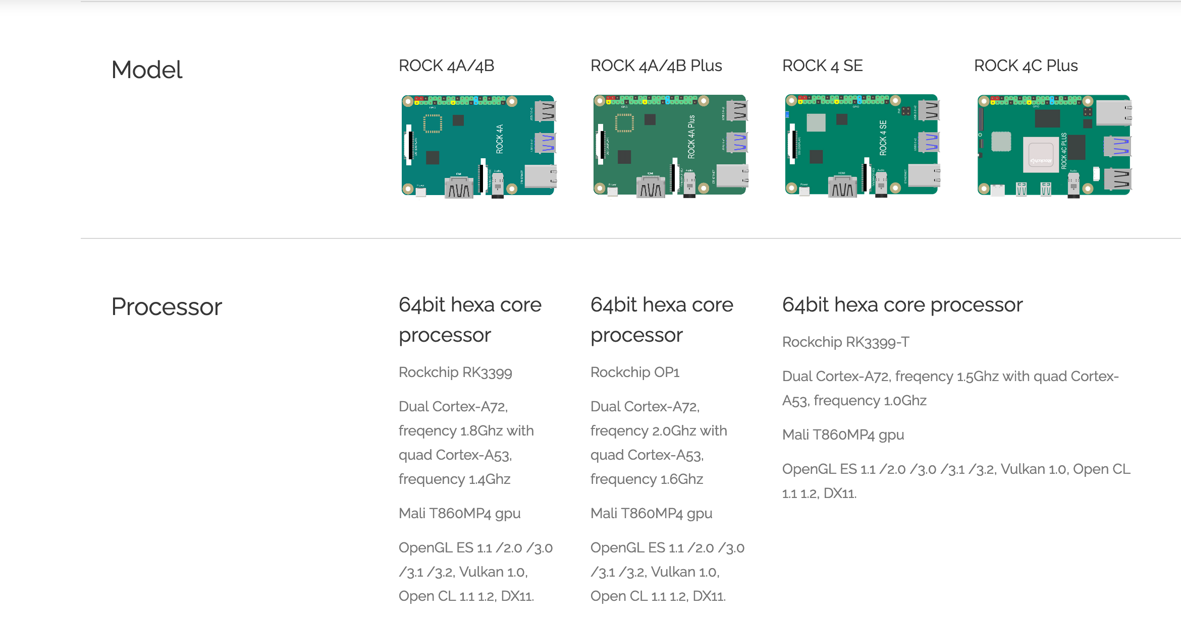

Edit: I did "find" the other thread, concerning the rk3399 vs rk3399T here:
easy implement a new board - LibreELEC ForumHi ! I just purchased a ROCK 4 SE which is different from a RADXA ROCK 4 or ROCKPI 4 because in the ROCK 4 SE RK3399-T is used instead of RK3399. Difference is…forum.libreelec.tvFYI the difference between the two versions of rk3399 , I did find a comparison on radxa´´ s website

Did you, or anyone, find if there is a difference of these 2 mentioned SOCs ?
I did see some mentioning somewhere regarding RK3399 and the newer (or different) T-model , which is also fitted on the RADXA Rock 4 SE . Something about LE is running weird on the 3399T compared to the "normal" 3399 ?
Radxa website, or even Google doesn´´ t seem to compare these two models, at all?
One of the differences I see between them is that one has the 3399 and the other the 3399T. Are there important differences between these two socs ???
