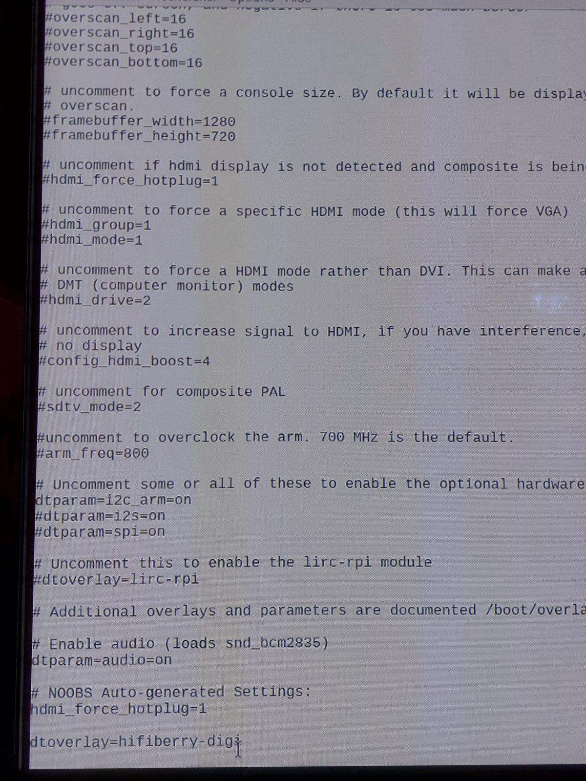

    HI Da Flex,
    As advised, I rechecked the instructions I received when I bought the card ( you are right its a PiFi Digi+ soundcard, not the original HiFiBerry Digi+)in 2016 :
    https://www.amazon.fr/gp/product/B01DD94DL6/ref=ppx_yo_dt_b_asin_title_o00_s01?ie=UTF8&psc=1
    2) CONFIGURATION DU RPi
    Déroulez les étapes suivantes indépendamment de l'image (distrib) installée sur votre RPi,
    - Connectez-vous sur votre RPi
    $ ssh <mon-rpi> -l pi
    - Ouvrir le fichier /boot/config.txt
    $ sudo nano /boot/config.txt
    - Commentez l'entrée : "dtparam=audio=on" (si elle existe)
    - Ajoutez une ligne pour la carte HiFi DiGi+
    dtoverlay=hifiberry-digi
    - Sauvegardez et quittez
    - Ouvrir le fichier /etc/modules
    $ sudo nano /etc/modules
    - Ajoutez la ligne suivante pour charger le module de la carte au boot
    snd_soc_hifiberry_digi
    - Redémarrez votre raspberry
    $ sudo reboot
    3) PARAMÉTRAGE KODI
    - Après reboot, allez dans Paramètres > Système > Audio
    - Sélectionnez "ALSA: snd_rpi_hifiberry_digi,S/PDIF"
    (Désactivez le passthrough s'il était actif)
    Maintenant votre son passe à travers la carte HiFi DiGi+
    Well it was ok in the past... but not working anymore
    Then I checked other tutos :
    Create /etc/asound.conf with the following content: pcm.!default { type hw card 0 } ctl.!default { type hw card 0 }
    Reboot again
    Any other idea?
    Should I update the LE9 to LE11?
    Will it help?
    Thanks in advance

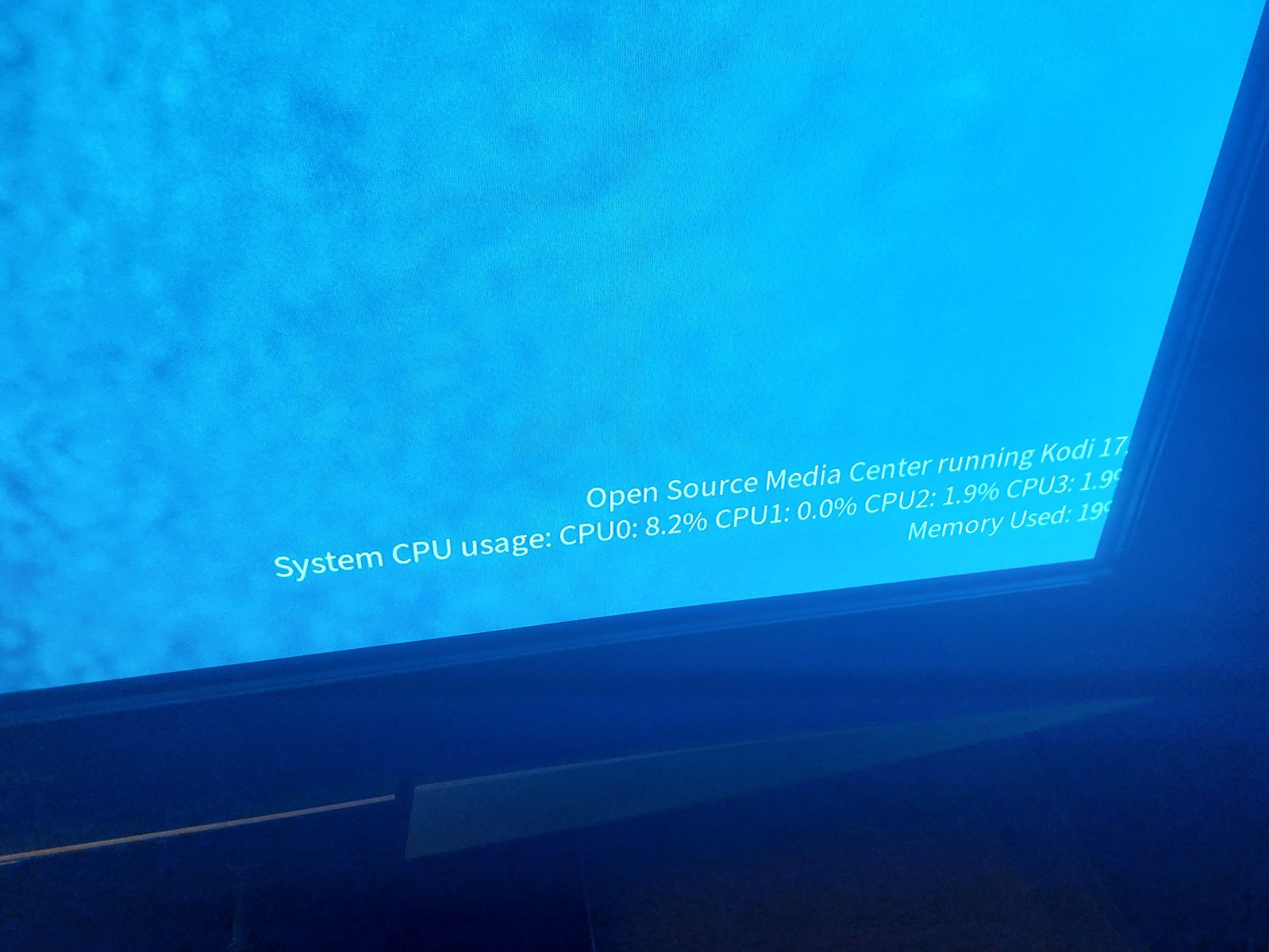

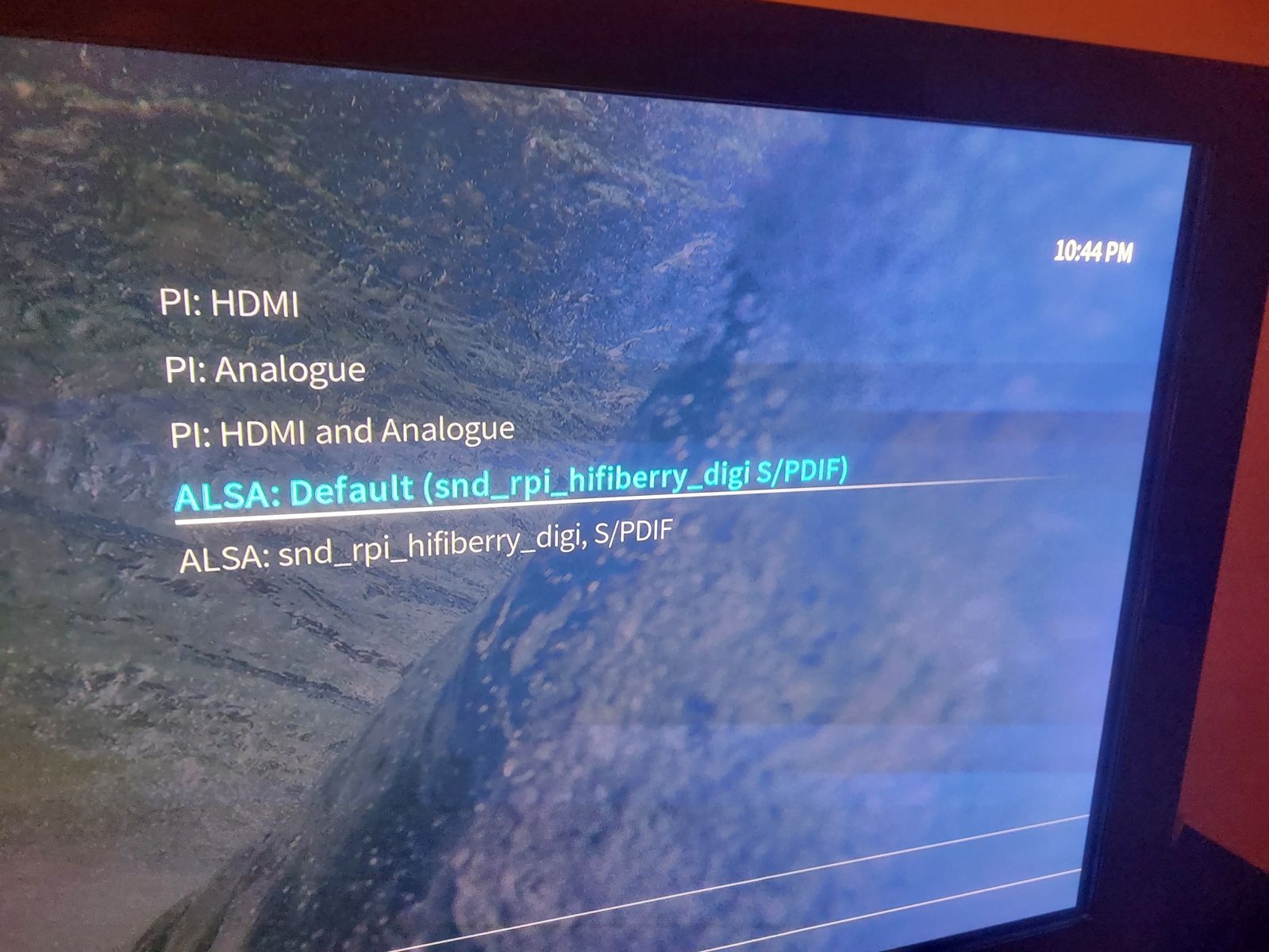

    Hi Da Flex,
    Im a bit lost as I am a real beginner in here.
    I dont know which instructions you are talking about in Raspberry PI OS.
    I just can tell you that before upgrading LE 9 to LE10, my spdif output was working and available in kodi 18 (leia). When I downgraded from LE10 to LE9 it mystiriously disappeared.
    By the meantime, I still have another kodi 17 installed on my pi.
    This session works with my soundcard in spid. See the picture enclosed...
    hello Da flex,
    I deleted the lines
    • dtparam=i2c_arm=on
    • dtparam=audio=on
    • hdmi_force_hotplug=1
    But it didnt work out
    Then I downgraded L10 to LE9 2.8 (leia 18.5).
    Unfortunately i still dont see hiifidberry in my available audio outputs in kodi...
    Do you have any idea how to force it into config.txt?
    Thanks in advance

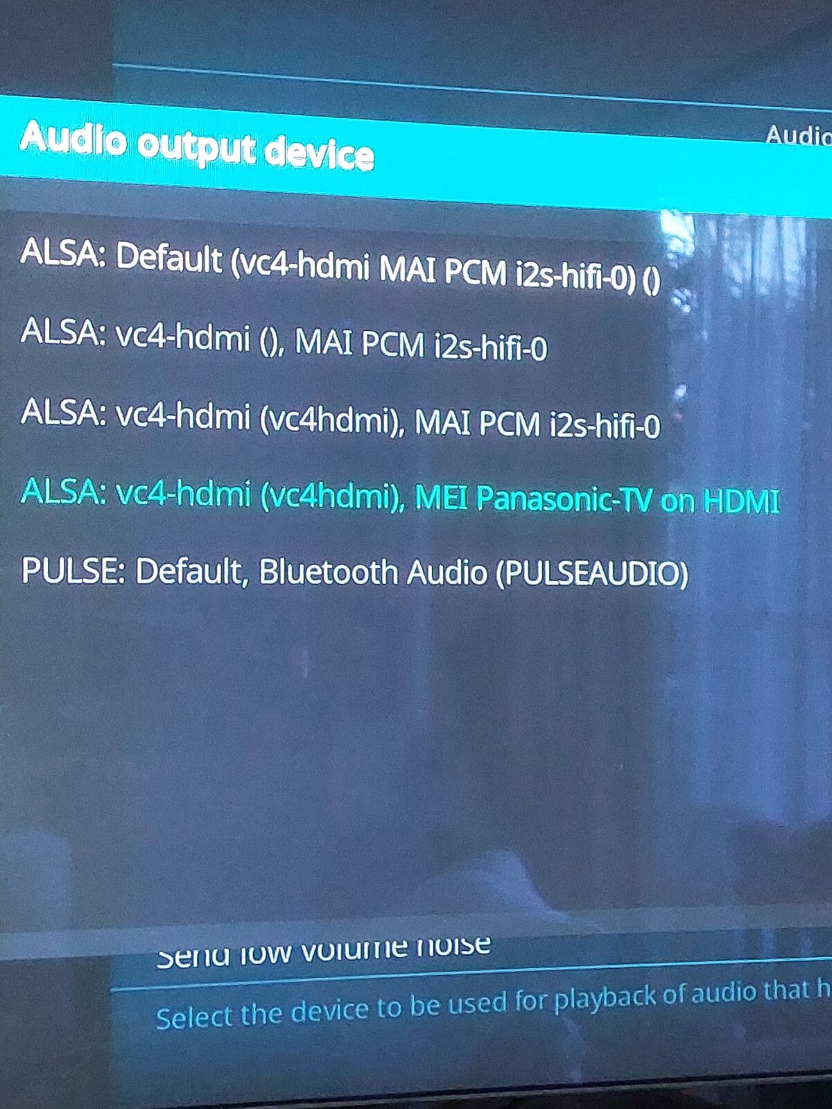

    hi there,
    Im using a rpi3
    My os is LE10 (kodi 19.5)
    I have an extra soundcard hifiberry+ but I dont know how to configure the spdif output.
    It doesnt appear in the sound settings of kodi...
    Only appears alsa defaut hdmi (4 times) and pulse default bluetooth.
    See enclosed a picture
    Any idea to force the spdif output of my hifiberry+?
    I bought a hdmi splitter to spdif but it doesnt work either...
    Thanks in advance
