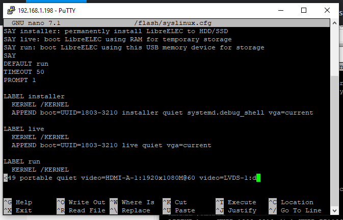

Nah, append that line right after vga= current at LABEL live section.

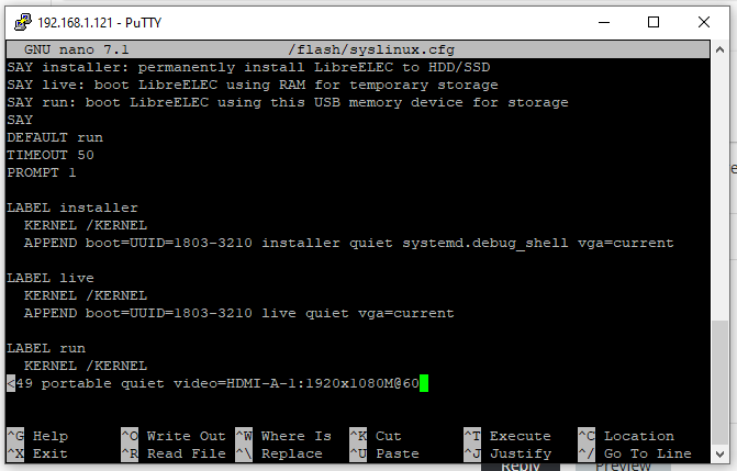

I added video=HDMI-A-1:1920x1080M@60 after vga=current.
You have to disable the video output you don't want ( chewitt already mentioned it).
Use ls /sys/class/drm to get the correct LVDS name and use video={lvds name}:d.
Usually it is video=LVDS-1:d or video=eDP-1:d

CodeRevisory:~ # ls /sys/class/drm card0 card0-LVDS-1 renderD128 card0-HDMI-A-1 card0-VGA-1 versionI want to ask if I should add video=card0-LVDS-1:d or video=LVDS-1:d. Additionally, if I do so, should I add it to LABEL live and LABEL run as suggested by @19921-da-flex (I'm not sure how to use the mention function)?
^ Adding this to kernel boot params (the APPEND line in syslinux.cfg) forces the video output to the HDMI-A-1 adapter. Set this if wanting to use HDMI and not the internal screen (LVDS) or change the adapter details to suit the second HDMI device and it will be used, else the kernel will detect/use the first device probed (on a laptop, normally the LVDS connection). You can also use content like "video=HDMI-A-1:d" to disable the HDMI-A-1 device (allowing another to be discovered) .. whichever works is good. There is no F7 style hotkey to swap outputs once Kodi has started.
So, I managed to add the line:
to /flash/syslinux.cfg by remounting the /flash partition in read-write mode. However, after rebooting, I still get Kodi on the internal screen instead of the HDMI. Did I do something wrong? I would like to know!
