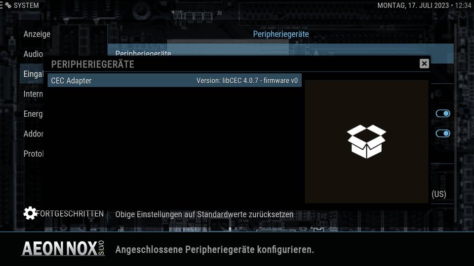

Maybe helpful:
Display More############################################## # LibreELEC # # https://libreelec.tv # ############################################## LibreELEC (official): 11.0.1 (RPi4.arm) LibreELEC:~ # cec-client No device type given. Using 'recording device' CEC Parser created - libCEC version 4.0.7 no serial port given. trying autodetect: path: /dev/cec0 com port: Linux opening a connection to the CEC adapter... DEBUG: [ 59] Broadcast (F): osd name set to 'Broadcast' DEBUG: [ 59] CLinuxCECAdapterCommunication::Open - m_fd=3 bStartListening=1 ERROR: [ 59] CLinuxCECAdapterCommunication::Open - ioctl CEC_S_MODE failed - errno=16 DEBUG: [ 59] CLinuxCECAdapterCommunication::Close - m_fd=3 ERROR: [ 59] could not open a connection (try 1) DEBUG: [ 59] CLinuxCECAdapterCommunication::Close - m_fd=-1 DEBUG: [ 1059] CLinuxCECAdapterCommunication::Open - m_fd=3 bStartListening=1 ERROR: [ 1059] CLinuxCECAdapterCommunication::Open - ioctl CEC_S_MODE failed - errno=16 DEBUG: [ 1059] CLinuxCECAdapterCommunication::Close - m_fd=3 ERROR: [ 1059] could not open a connection (try 2) DEBUG: [ 1059] CLinuxCECAdapterCommunication::Close - m_fd=-1 DEBUG: [ 2059] CLinuxCECAdapterCommunication::Open - m_fd=3 bStartListening=1 ERROR: [ 2059] CLinuxCECAdapterCommunication::Open - ioctl CEC_S_MODE failed - errno=16 DEBUG: [ 2059] CLinuxCECAdapterCommunication::Close - m_fd=3 ERROR: [ 2059] could not open a connection (try 3) DEBUG: [ 2059] CLinuxCECAdapterCommunication::Close - m_fd=-1 DEBUG: [ 3060] CLinuxCECAdapterCommunication::Open - m_fd=3 bStartListening=1 ERROR: [ 3060] CLinuxCECAdapterCommunication::Open - ioctl CEC_S_MODE failed - errno=16 DEBUG: [ 3060] CLinuxCECAdapterCommunication::Close - m_fd=3 ERROR: [ 3060] could not open a connection (try 4) DEBUG: [ 3060] CLinuxCECAdapterCommunication::Close - m_fd=-1 DEBUG: [ 4061] CLinuxCECAdapterCommunication::Open - m_fd=3 bStartListening=1 ERROR: [ 4061] CLinuxCECAdapterCommunication::Open - ioctl CEC_S_MODE failed - errno=16 DEBUG: [ 4061] CLinuxCECAdapterCommunication::Close - m_fd=3 ERROR: [ 4061] could not open a connection (try 5) DEBUG: [ 4061] CLinuxCECAdapterCommunication::Close - m_fd=-1 DEBUG: [ 5062] CLinuxCECAdapterCommunication::Open - m_fd=3 bStartListening=1 ERROR: [ 5062] CLinuxCECAdapterCommunication::Open - ioctl CEC_S_MODE failed - errno=16 DEBUG: [ 5062] CLinuxCECAdapterCommunication::Close - m_fd=3 ERROR: [ 5062] could not open a connection (try 6) DEBUG: [ 5062] CLinuxCECAdapterCommunication::Close - m_fd=-1 DEBUG: [ 6062] CLinuxCECAdapterCommunication::Open - m_fd=3 bStartListening=1 ERROR: [ 6063] CLinuxCECAdapterCommunication::Open - ioctl CEC_S_MODE failed - errno=16 DEBUG: [ 6063] CLinuxCECAdapterCommunication::Close - m_fd=3 ERROR: [ 6063] could not open a connection (try 7) DEBUG: [ 6063] CLinuxCECAdapterCommunication::Close - m_fd=-1 DEBUG: [ 7063] CLinuxCECAdapterCommunication::Open - m_fd=3 bStartListening=1 ERROR: [ 7063] CLinuxCECAdapterCommunication::Open - ioctl CEC_S_MODE failed - errno=16 DEBUG: [ 7063] CLinuxCECAdapterCommunication::Close - m_fd=3 ERROR: [ 7063] could not open a connection (try 8) DEBUG: [ 7063] CLinuxCECAdapterCommunication::Close - m_fd=-1 DEBUG: [ 8064] CLinuxCECAdapterCommunication::Open - m_fd=3 bStartListening=1 ERROR: [ 8064] CLinuxCECAdapterCommunication::Open - ioctl CEC_S_MODE failed - errno=16 DEBUG: [ 8064] CLinuxCECAdapterCommunication::Close - m_fd=3 ERROR: [ 8064] could not open a connection (try 9) DEBUG: [ 8064] CLinuxCECAdapterCommunication::Close - m_fd=-1 DEBUG: [ 9064] CLinuxCECAdapterCommunication::Open - m_fd=3 bStartListening=1 ERROR: [ 9064] CLinuxCECAdapterCommunication::Open - ioctl CEC_S_MODE failed - errno=16 DEBUG: [ 9064] CLinuxCECAdapterCommunication::Close - m_fd=3 ERROR: [ 9064] could not open a connection (try 10) DEBUG: [ 9064] CLinuxCECAdapterCommunication::Close - m_fd=-1 unable to open the device on port Linux NOTICE: [ 10065] connection opened -

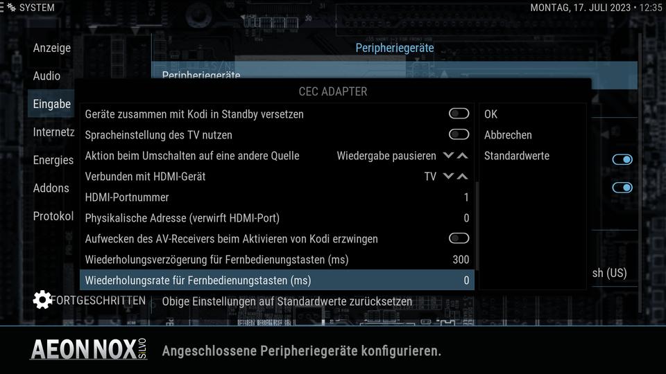

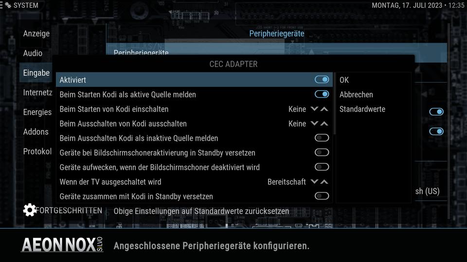

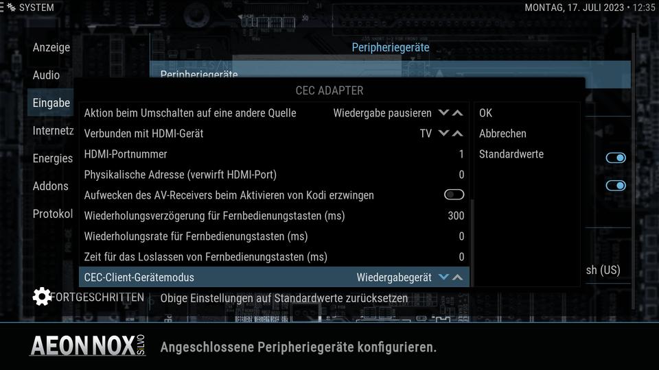

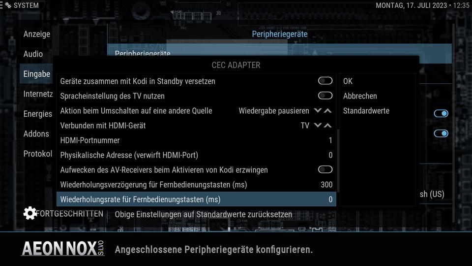

After installing and setup Libreelec 11 I have very often issues with CEC.
My old setup (RPi3>AV Receiver>TV) with Libreelec 8 runs perfectly.
But Libreelec on RPi4 (RPi4>micro hdmi/hdmi>AVR>hdmi TV) very often makes problems with CEC.
I have to turn off TV, turn on TV and hoping CEC is now working. But very often I have to reboot Libreelec, turn off AV receiver, turn on TV and turn on AVR and so on...
Is this issue only a "setting problem" or is it a cec driver issue/bug?
Attached my (german) settings:
