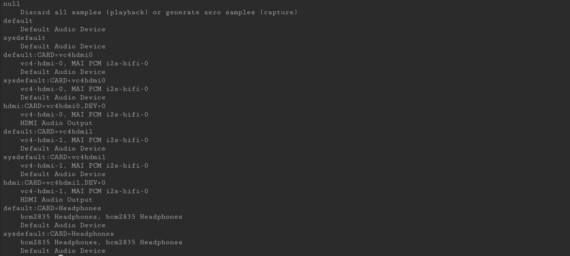

    Hi, I'm using Libreelec 10.0.4 on a raspberry pi 4 8gb
    I nearly finished my setup after hours of fiddling. But after I installed some add-ons today suddenly all the HDMI audio output devices in the Kodi settings are gone and I'm now left with only the headphones (which I enabled via the config.txt before) and Bluetooth as audio output. I'm pretty sure it has something to do with the Audio Profiles add-on I installed from the Kodi add-on repository. At least I recognized it afterwards and it was the only audio output related add-on I installed today.
    Before everything was working fine and I had multiple hdmi audio output options.
    I already reinstalled the add-on, uninstalled it, rebooted, tried to change the audio output device to hdmi in the guisettings.xml and searched for hours in the internet for a solution, but couldn't find a fitting one.
    The weirdest thing is, if I reboot the sound is played over hdmi but as soon as I go to settings/audio (not doing anything else) the sound is gone and the audio output device is still bcm 2835 headphones.
