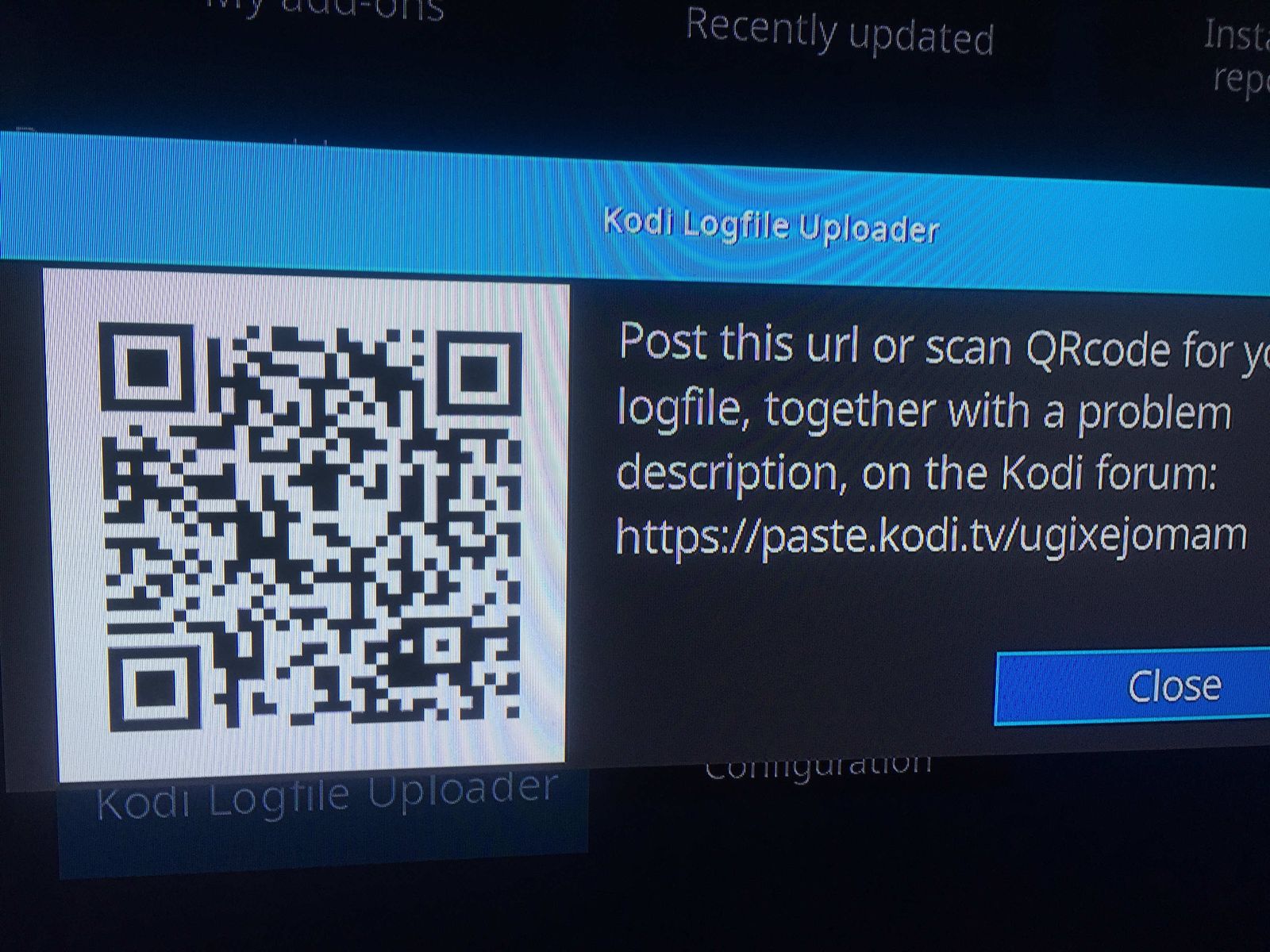

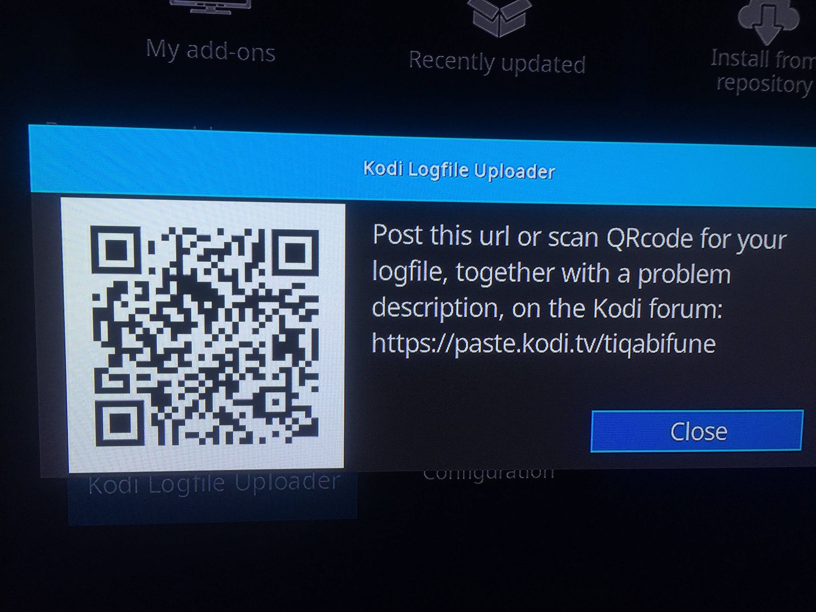

Both logs (11.0.4 - first and 11.0.3 - second) were uploade ~11 AM CET. The first attached picture (189b) points log of 11.0.4 (problematic) and the second one (190c) points to log from 11.0.3 (ftp works without any problems).
Both systems are fresh - just installed. Only two plugins are installed: ProFTPD Server and Kodi Log Uploader. RPi's IP in both cases is the same (192.168.1.99). Experiments were done with the help of HIK IP camera (192.168.1.202) which tried to ftp a test file to the server (192.168.1.99).
FTP user and password in both cases were the same.
