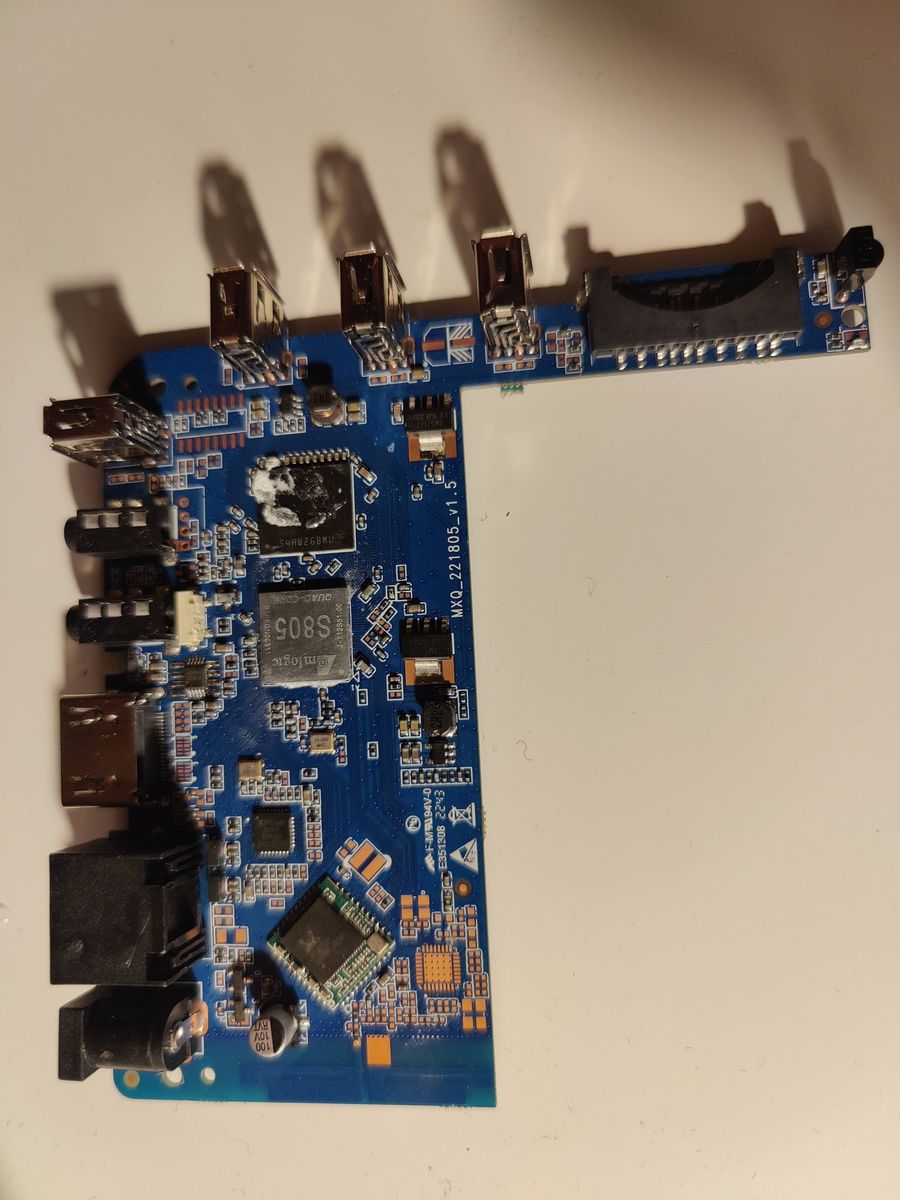

    Well, the manufacturer saved a lot of space, the PCB is quite small compared to the size of the box.
    Yes, looking at the cut point I suppose they get 2 board from a single pcb. The box could have been really smaller with a different pcb approach. I think that's behind the marketing idea: bigger is better...

    Thanks, it is AS and not BS. I have misunderstood vid and pid, now I've checked the chip by removing the heat sink. Wifi it's not working, switched to Lan use.

    I have an MXQ PRO 4K 5G, it has S805.
    Just found that wifi is not working, the wifi chip is an RTL-8723BS, (024c:8723), tried modprobe on r8723bs but getting
