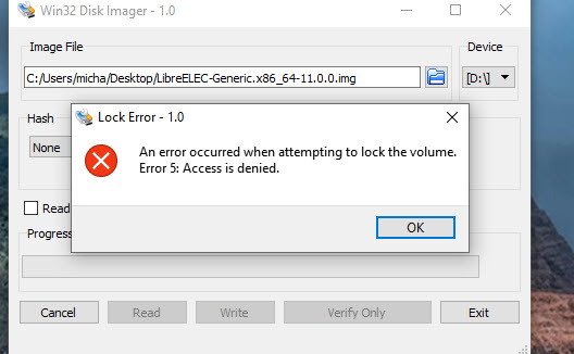

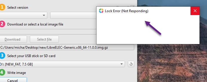

hi all - thanks for chiming in . . . this was an odd problem and might not be applicable to others but in case it it . . . so the problem - as i saw it - was that it needed to lock the drive to perform the write but couldn't for some reason (not that it Was locked) . . . it wouldn't proceed without that in place . . . used a partition tool and partitioned the device to a gpt partition over mbr . . . really don't know if that did it but someone allowed the write to proceed and thus i did get the image on the stick. thx again.
hi all - long-time user here . . . this is the 'easy' part but having trouble for some reason . . . 2 different usb sticks, 2 different image programs and 2 different images (rolled back to see if it was the image file) . . . not sure what is happening or if you all can help as not a libreelec-specific issue but . . . also, changed the file system to fat to see if that will help but originally ntfs.
thanks for any suggestions
michael
