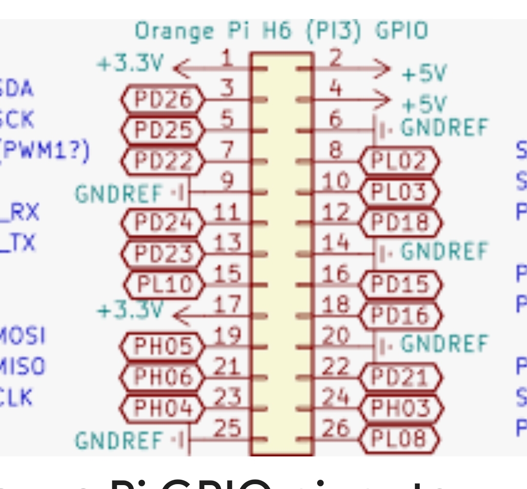

editing: installed your last message zip orange tools file, installed service fan zip addon, but im not sure what to do in addon settings, LTS model is no present so i choose opi3 board, fan negative to pin 6, fan positive to pin? i tried set to pins 8, 10, 12, 3 and some others with no success, what am i doing wrong?
i dont want to bother you, im not an expert with electronics so, if you think you dont have to lose your time its ok, fan sound is not really a big problem for me unless some times when alone st night and tv volume very low.

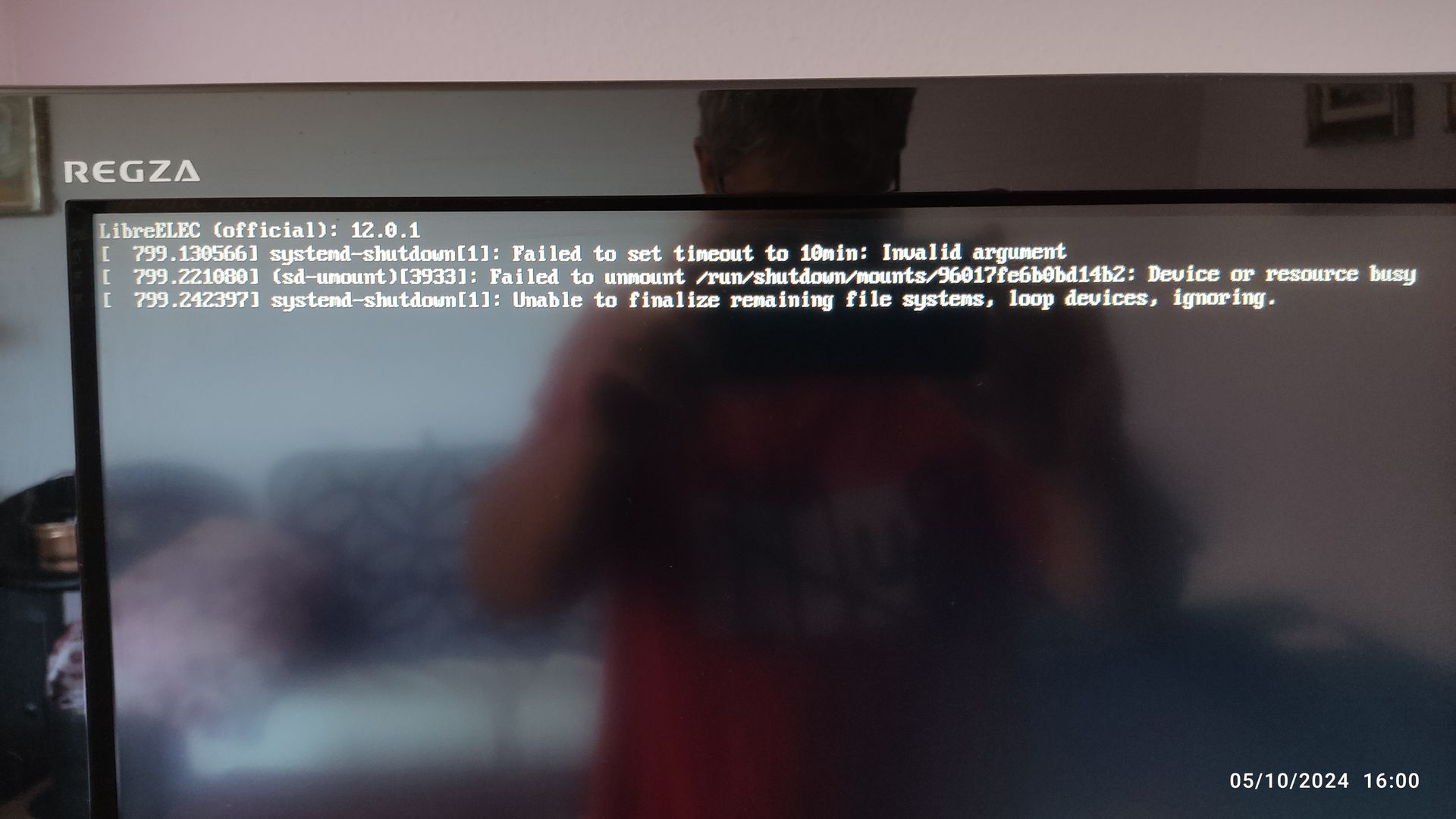

yes they are there, the only different is that errors messages dissapear from screen much faster, reboot is faster and you can barely see that screeen, but yes, i took a photo and same errors shown.
btw, when shutting down, the errors shown are only 1st and 2nd lines, 3rd error line is not present

https://paste.libreelec.tv/relaxed-liger.log
I tried a fresh install (SD) for testing, same error happend
hello. i see that when rebooting system. is that normal?
to be honest im not sure if that was happening since latest 12.0.1 was installed, however everthing works fine, no issues so far.
Orange pi3 lts, no SD installed (emmc intallarion using ssh install2emmc command), 1 HDD and 1 SSD attached to USB ports.
