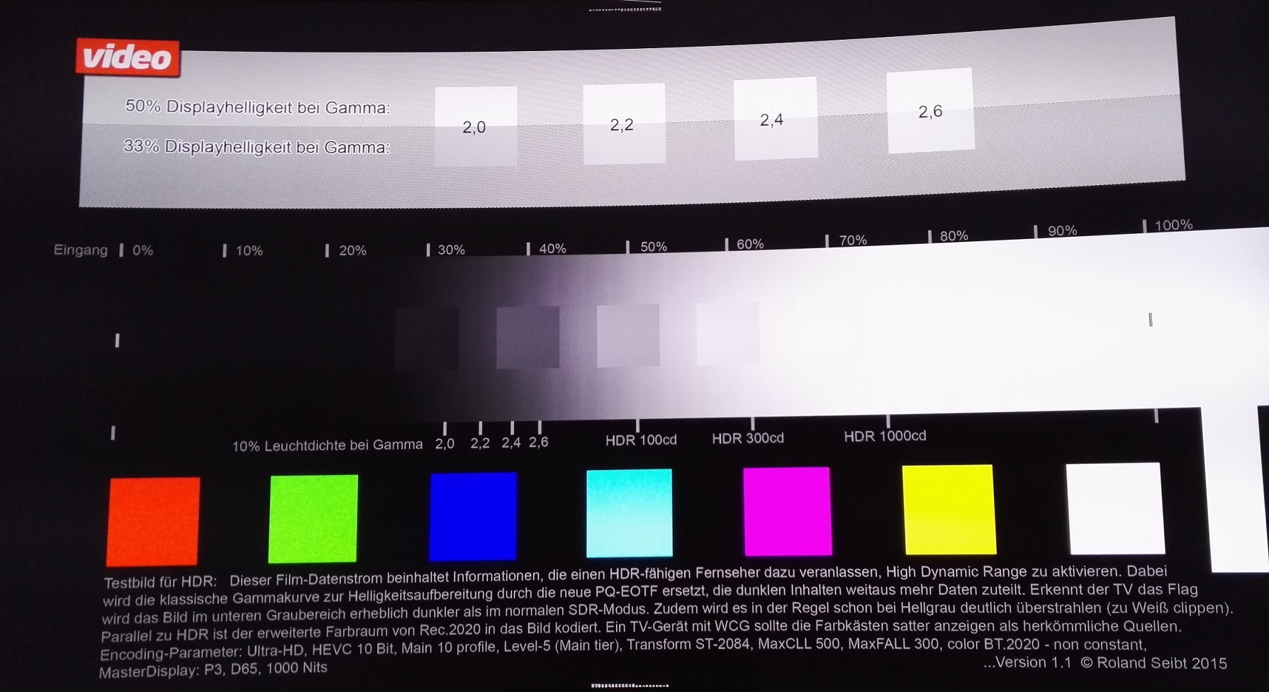

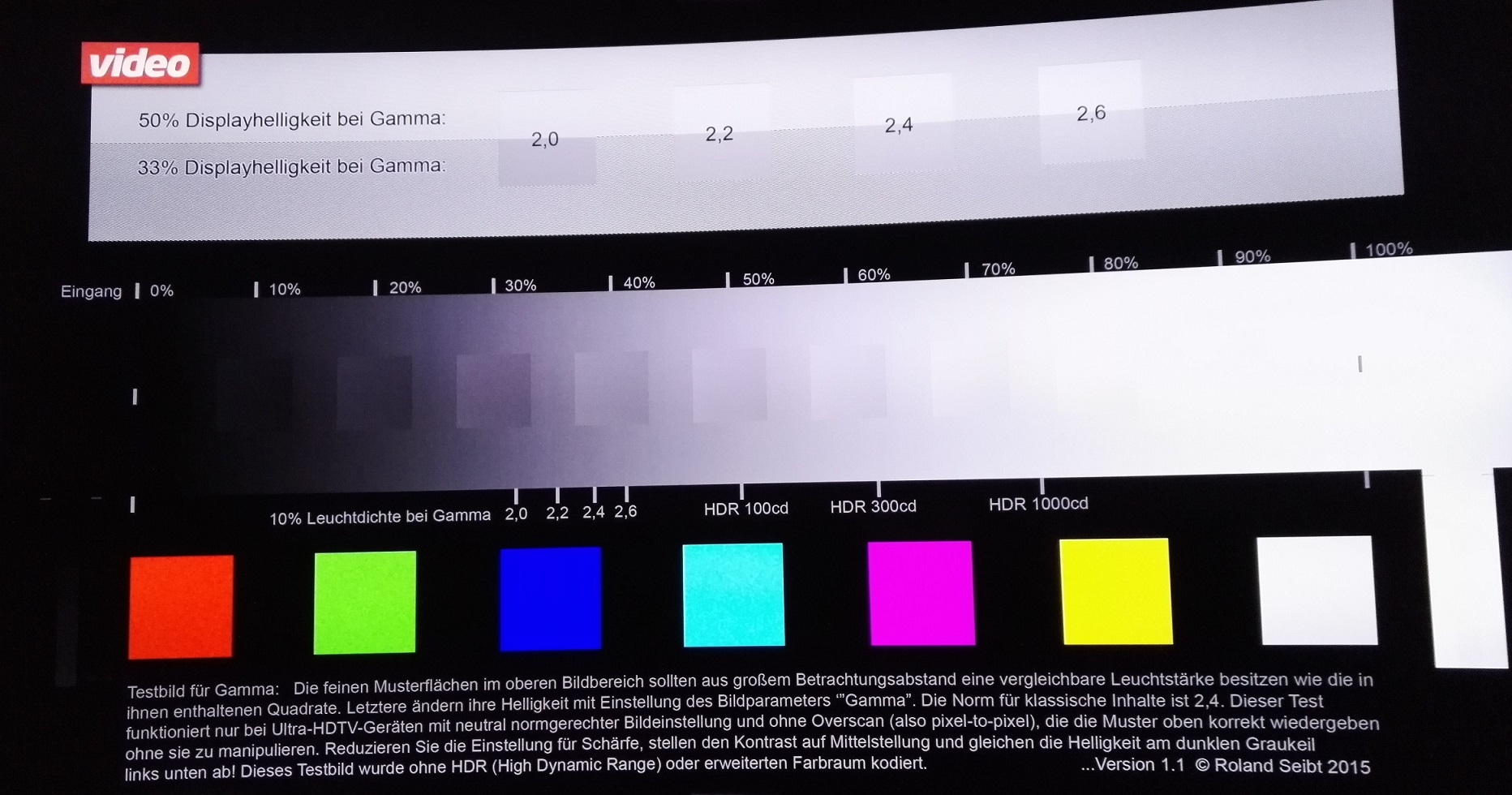

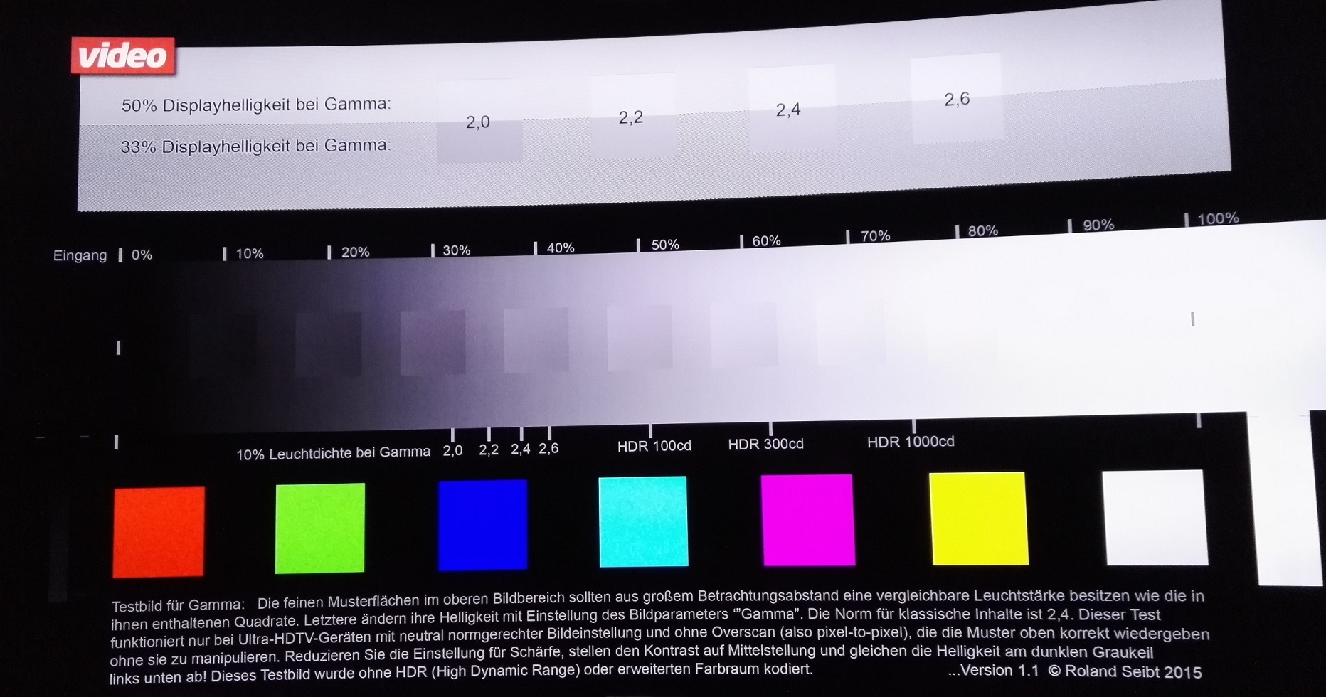

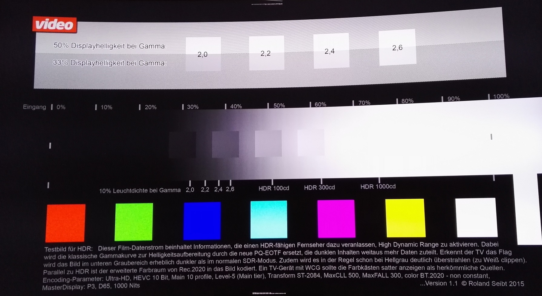

    I took photos of a HDR and a SDR video playing for comparison (same camera settings):
    HDR:
    SDR:
    (Look at the contrast difference of the writing for example)
