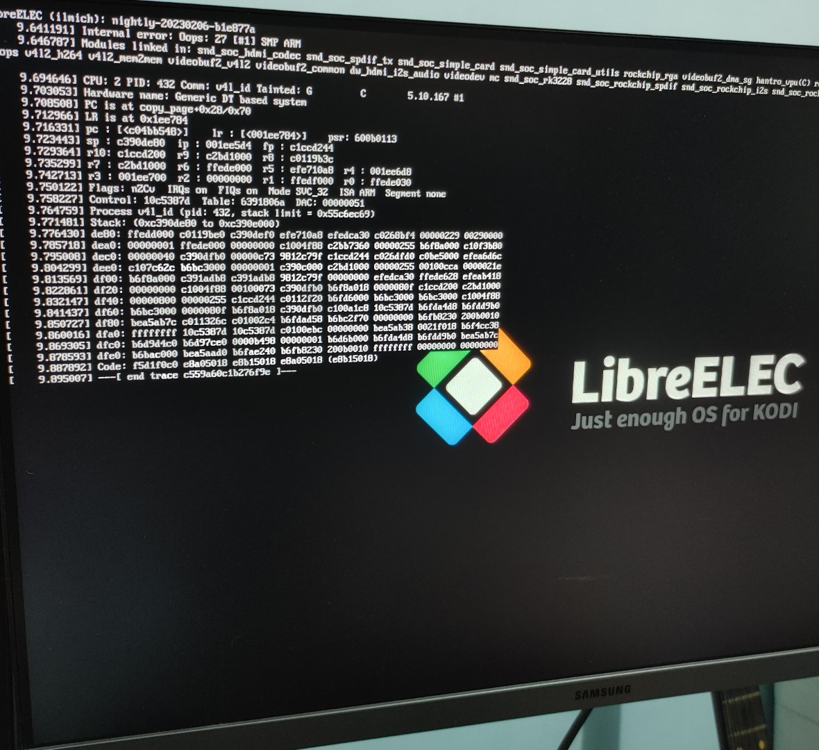

    I tested the new dtb on latest build. Still no boot on SD so I had to install via multitool. I then swapped it using your steps, but I also updated the FDT entry on extlinux.conf, that's how it's supposed to be right? Unfortunately it still hangs, result is not much different. I'll attach logs again just in case. If there's no error in logs, does it mean that it crashes before it could log what causes the error?
    In a couple of attempts to reboot some sort of kernel errors appear after the boot logo, unfortunately I couldn't get screenshots.
    I also want to note that when it hangs, the ssh session also hangs, I'm unable to type anything, and it'll only close once I pull the plug on it.

    Hi, I have an MXQ Pro 4k with RK3228A + ESP8089 and 1GB RAM + 8GB ROM. I'm assuming that this firmware is not fit for my box because I'm unable to boot this from sd card (in contrast to multitool, armbian, and the older LE 9.2 from knaerzche).
    However I'm able to flash it to my device's emcp, but even then the experience has not been very pleasant, as the device randomly becomes unresponsive, or doesn't continue past the boot logo. I attached some logs below.
    Not sure if you're able to do something about this. The older firmware boots in SD but can't be flashed and bricks the device. It is relatively stable but it lacks some features such as use of the remote.
