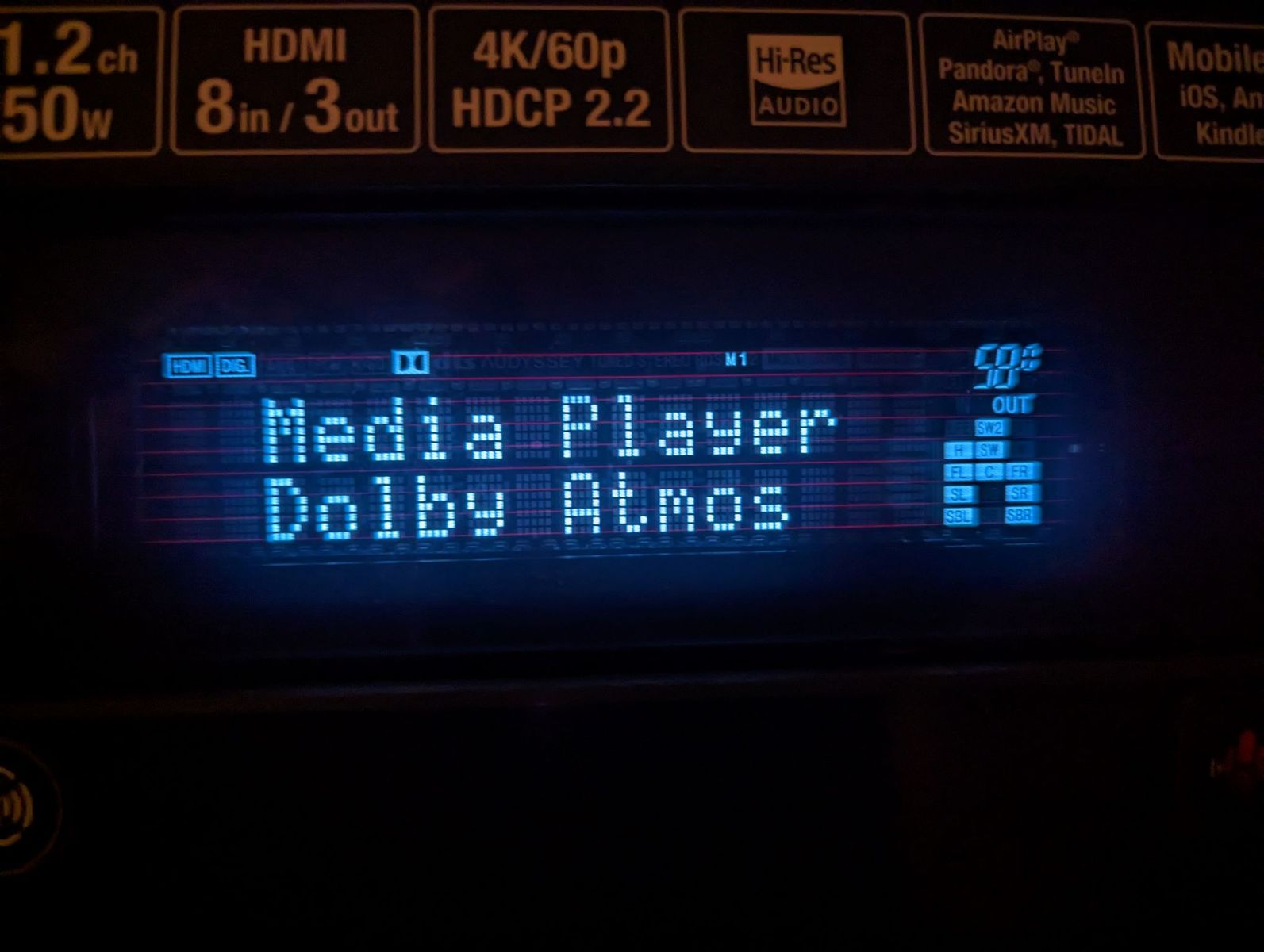

    My Minix Neo U9-H is now running LibreELEC-AMLGX.arm-10.95.0-box.img very well off of an ultra fast Micro SD card. So far, I've only encountered one significant issue. It fails to play any HD audio streams and that is a real deal breaker for me. The Minix box still has the old copy of LibreELEC 8.2.2.3/Kodi 17.6 running from the onboard eMMC so by inserting and removing the SD card with the LibreELEC 10.95.0/Kodi 20, I am able to switch between the 2 versions and do apple to apple comparisons to confirm the issue is not with the hardware or the specific movie file...same physical hardware (Minix Neo U9-H Player -> Denon AVR-X6300H Receiver) playing same mkv file (Alita Battle Angel 4K HDR10 Dolby ATMOS). When running LibreELEC 8.2.2.3/Kodi 17.6 off of the internal eMMC, all formats of lossless audio are handled correctly - Dolby TrueHD, Dolby TrueHD with Dolby ATMOS, DTS-HD Master, and DTS:X (see Old Libreelec image attached). When running the new LibreELEC 10.95.0/Kodi 20 software on the same Minix box, I get no HD audio of any type. The same audio file (in this case it is Dolby TrueHD with Dolby ATMOS) will not play. I have to switch to the Dolby Digital (AC-3) lossy 5.1 audio file to get any sound. This can be seen in the other attached image New Libreelec (small).jpg. All audio settings are the same in the 2 Kodi versions, including allowing Passthrough of all listed types of audio codes. I've tried numerous movie files with HD audio and had the same results. My newer Zidoo Z9X media player with OSMC and connected via HDMI to same Denon receiver also handles all of the HD audio formats with no problem. Anyone have any ideas?
    NOTE: The New Libreelec image shows Blu-Ray as the source but that's only because I switched inputs on the Denon to rule out an issue with the connection and forgot to switch back before taking the photo. The source is the same in both photos, the Minix.
