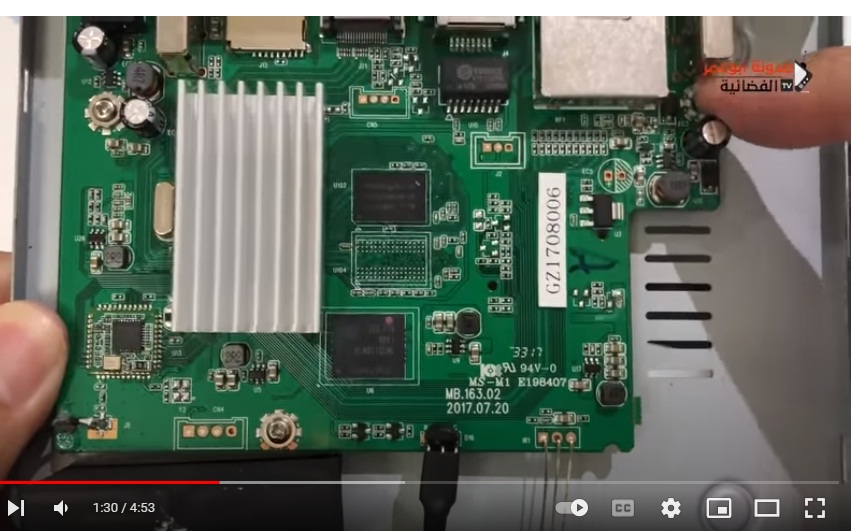

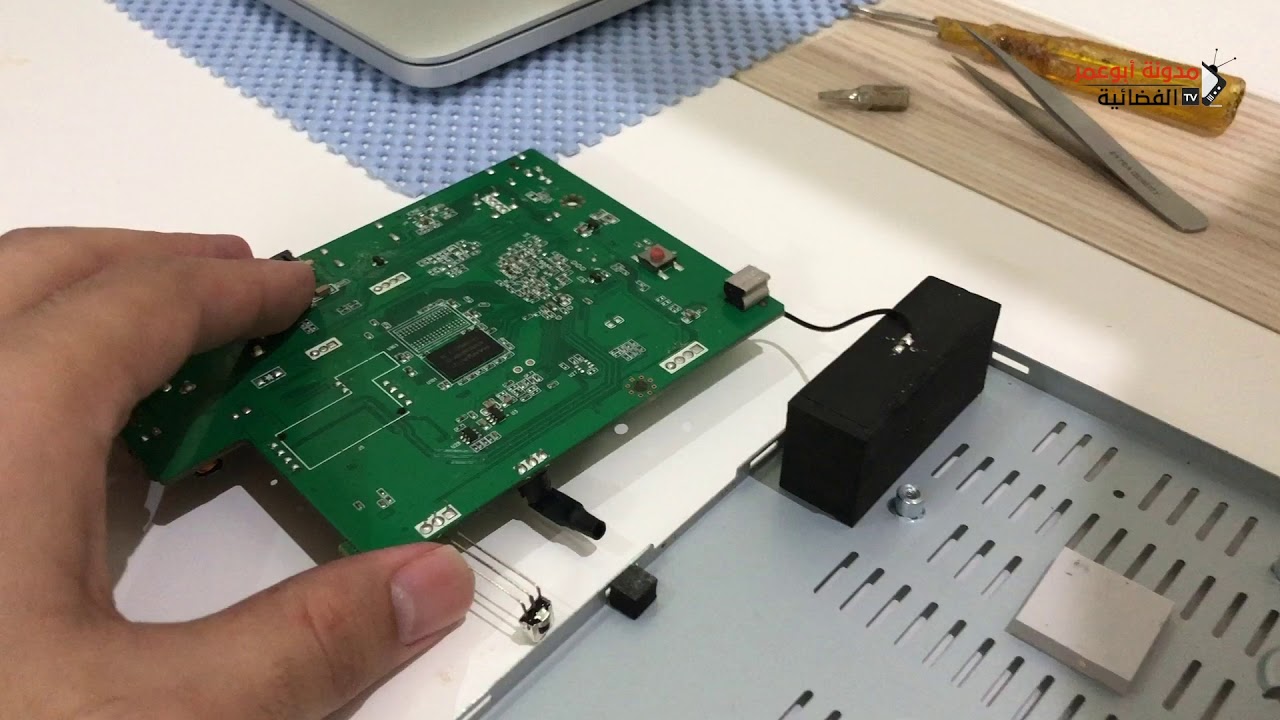

Pls help, I think I breacked my tv box When trying to run libreelec, I just but the sd card my device stopped, I tried to flash any rom with amlogic burning tool its stopped at 2% the device is always connected to the pc without pushing the recovery button, there are no point to be shorted to do short pin method, I bought UART and connect it, attached the log for good working device and for the breacked device
device specs
Amlogic
SS5B7BA_ME003
Device Name: DreamMax B9S2
ROM 8GB
RAM 1GB
S905D
the old working rom is
BeoutGO-V2www.mediafire.com
