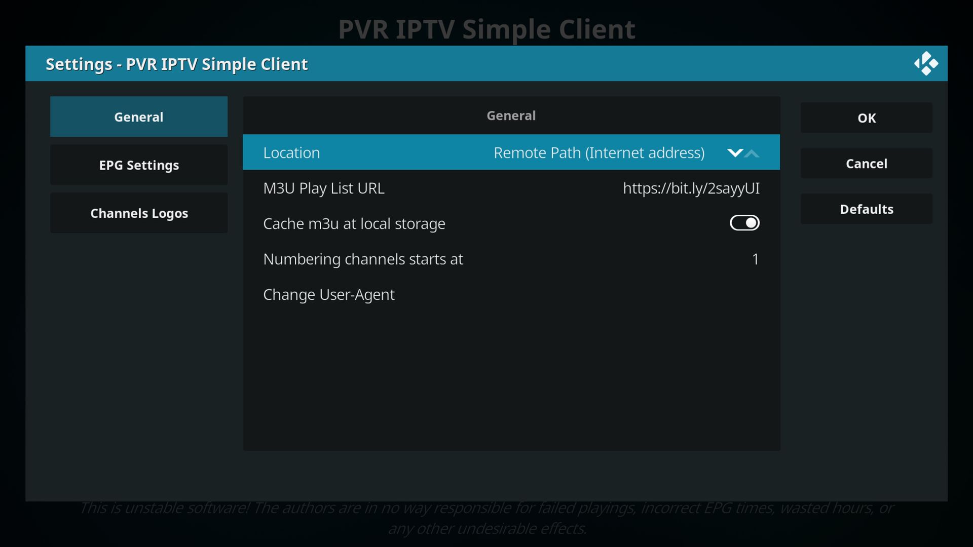

I've setup the same m3u link and can see and select a channel but it does only start the video window without image& sound and then crashing.

Dear LibreElec's,
I face an issue on IPTV Simple Client that I can't handle myself, I tried long hours but can't find the proper solution.
There are some similar issues to be found on the web but none of them helped me out.
Log's are attached.
Thanks for your input
Issue:
Channels are loading, I can see them and select.
But once I do it, the channel is not displayed, the player stays black and mouse cursor lags with overlaps + upcoming crash with frozen window.
A forced reboot has to be done, no other chance.
Same m3u + IPTV simple client works on Matrix LibreElec. But not on the recently downgraded Leia 9.2.8.
(I had to downgrade due to VPN reasons that only work well with Leia)
System:
Raspberry 4B 4GB
LibreElec 9.2.8
M3U:
The m3u link is available and works on other systems.
Size about 300 channels.

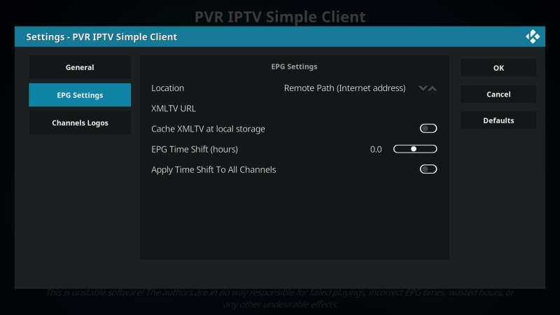

EPG:
I did not share a link in this section, so I take it that it's turned off.
