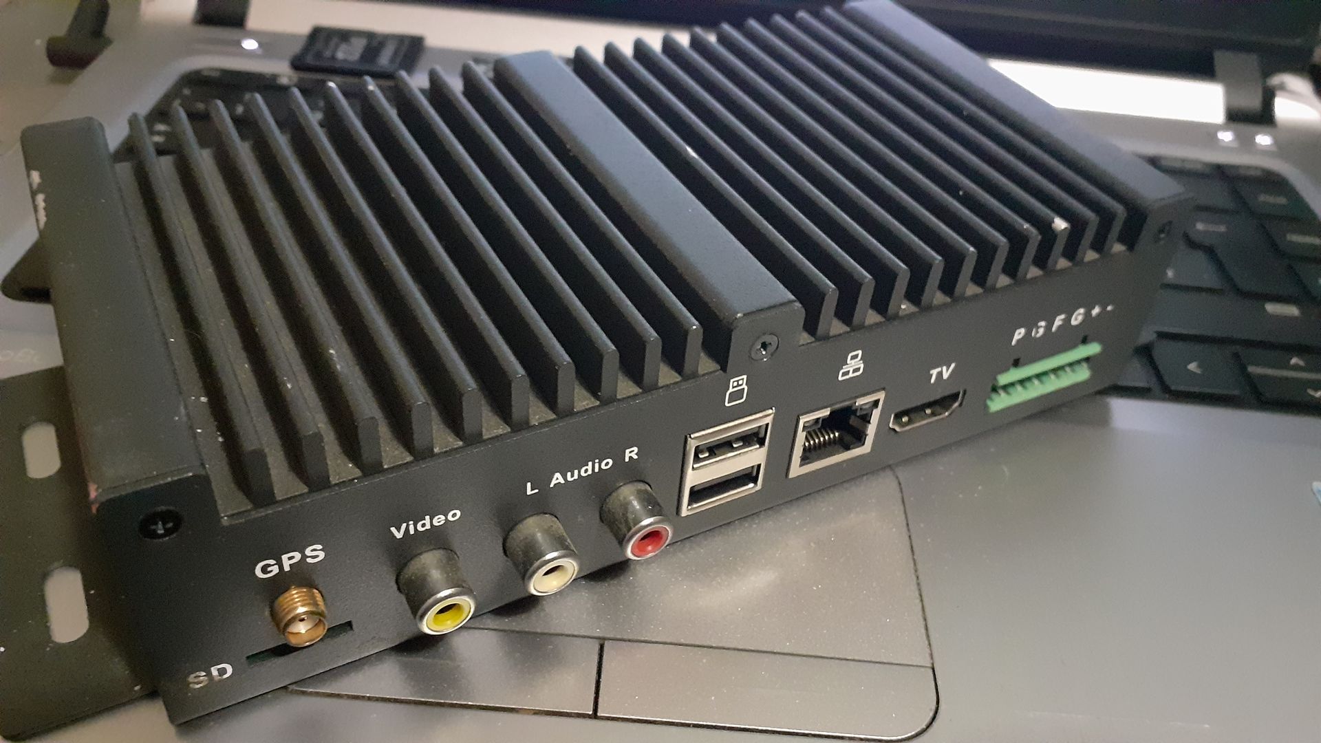

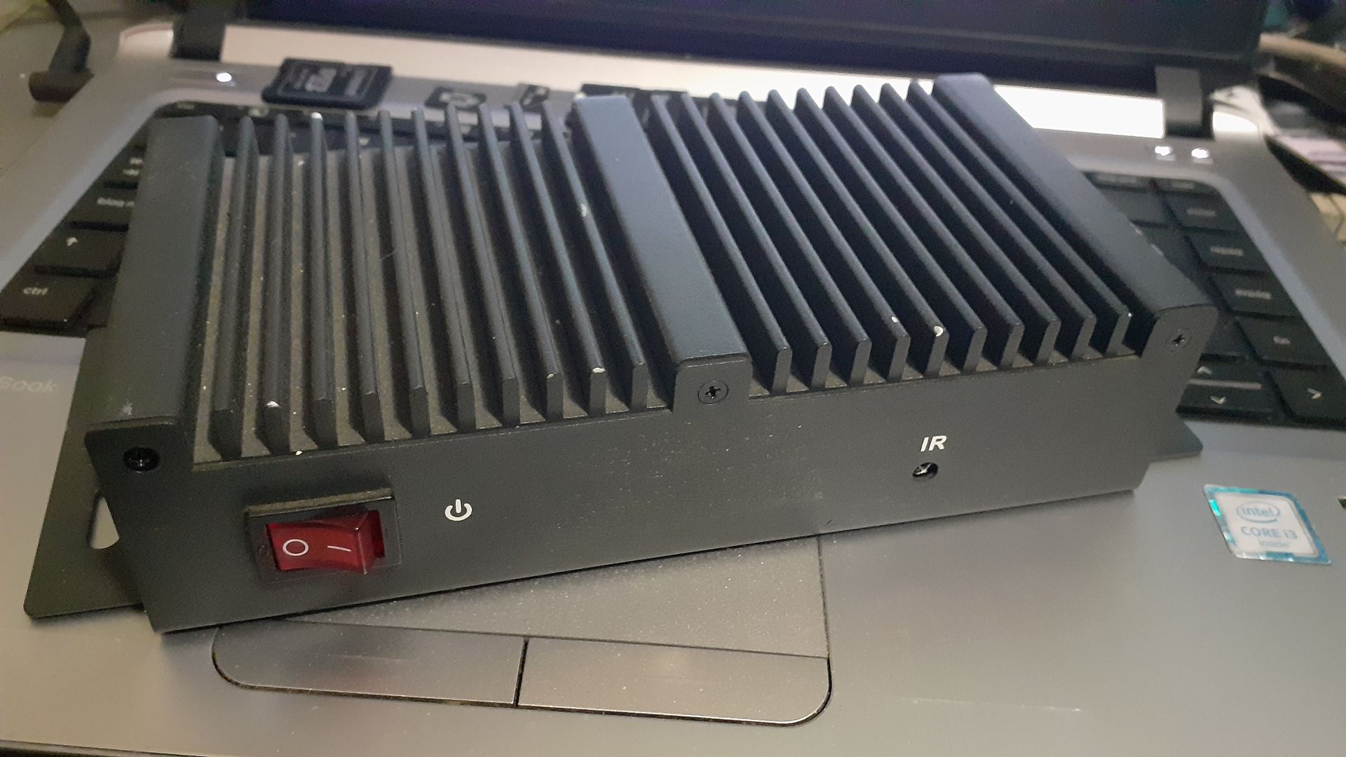

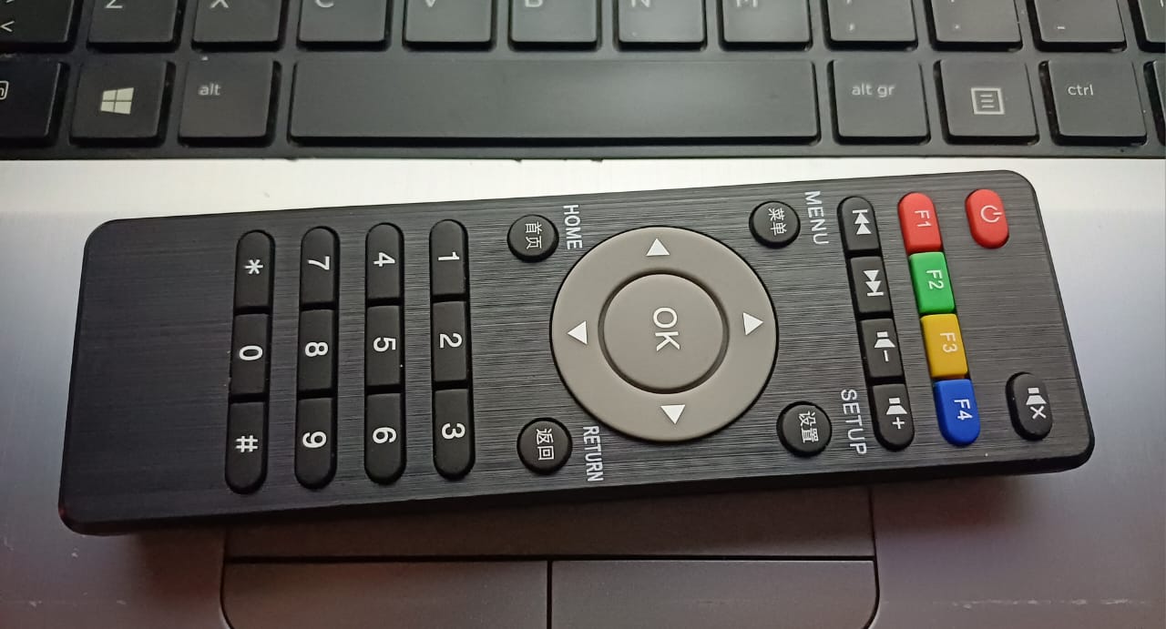

Hi guys, excuse my english. I leave you some optimizations and my Remote Control configuration. My device is industrial, for that reason I added some python scripts to the gps. You'll see that I loaded the remote in autostart, since it became impossible for it to read rc_maps.cfg

ir-keytable -p nec -w /storage/.config/rc_keymaps/my_remote

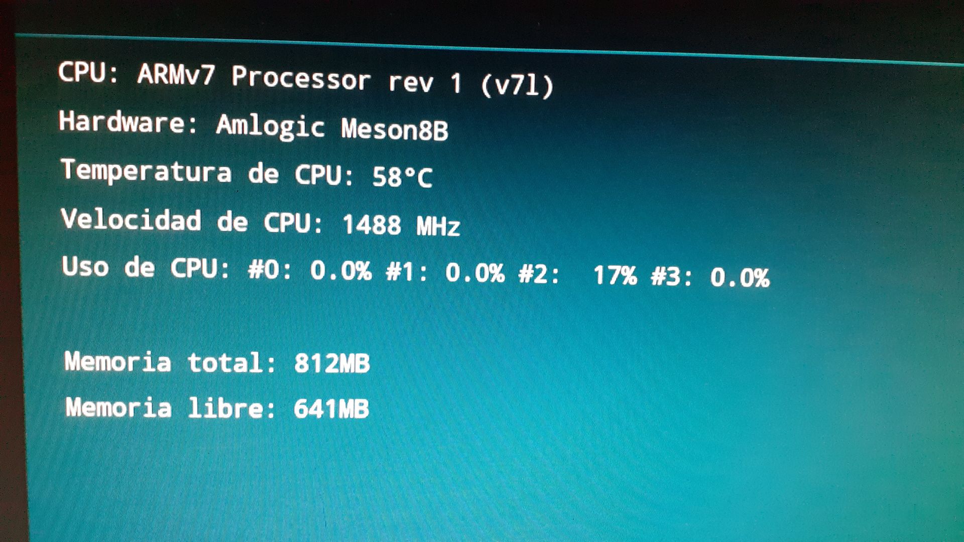

Hello everyone. I am currently building a small VOD server, for no more than 50 streaming clients, which also has an on-screen player. My device is an AML Meson 8b with 1gram running Android4.4 with old nginx included by the manufacturer (which is not able to read an index.html, only by absolute url haha).
I only need to run an nginx, lighttpd or apache server, since all content is static.
The docker option is not possible, the kernel is 3.10.
Python SimpleHTTPServer only delivers one request at a time, that is, if I have a client watching a movie, until the download finishes, it doesn't deliver anything to anyone.
Actually, an Alexelec compilation works very well for me, since it takes all the available ram and the 4 cores of the processor, unlike the libreelec distros that only take 2 cores and 796 of ram. Although I would compile my own distribution if I manage to run all the necessary functions.
