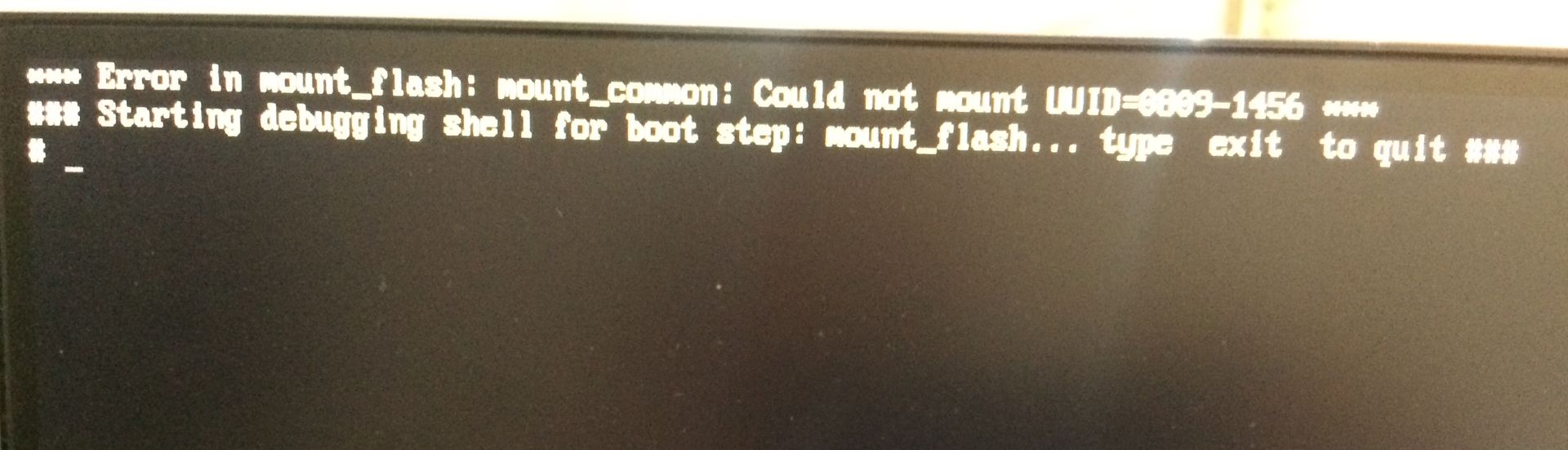

    I tried following imaging tools:
    Balena Etcher, Rufus,Win32DiskImager, USBImager. The latter two didn't recognize the SSD. So I used only Etcher and Rufus, and wrote latest LE 11 Nightly build, and same thing happened.

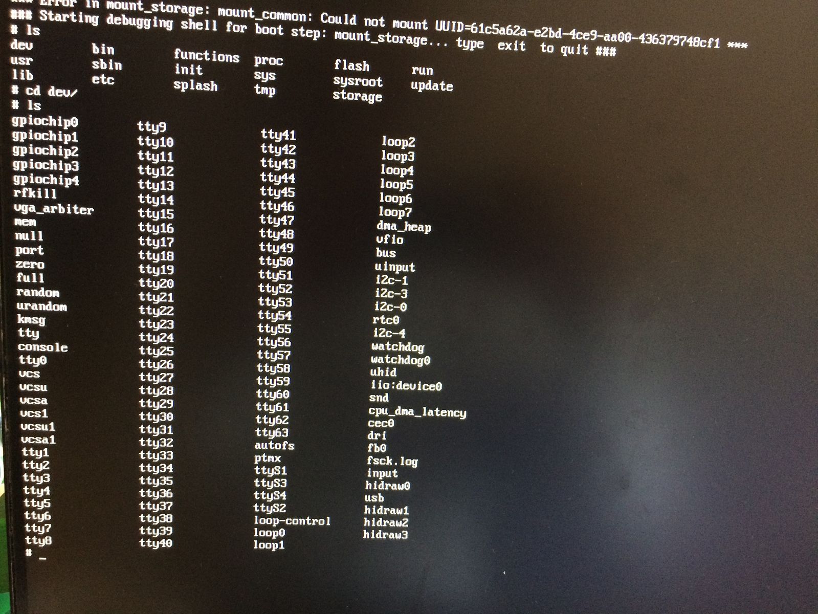

    When inside LE boot console, the NVME is not listed in /dev.
    Below you can find various screenshots:
    1) The text that appears during boot

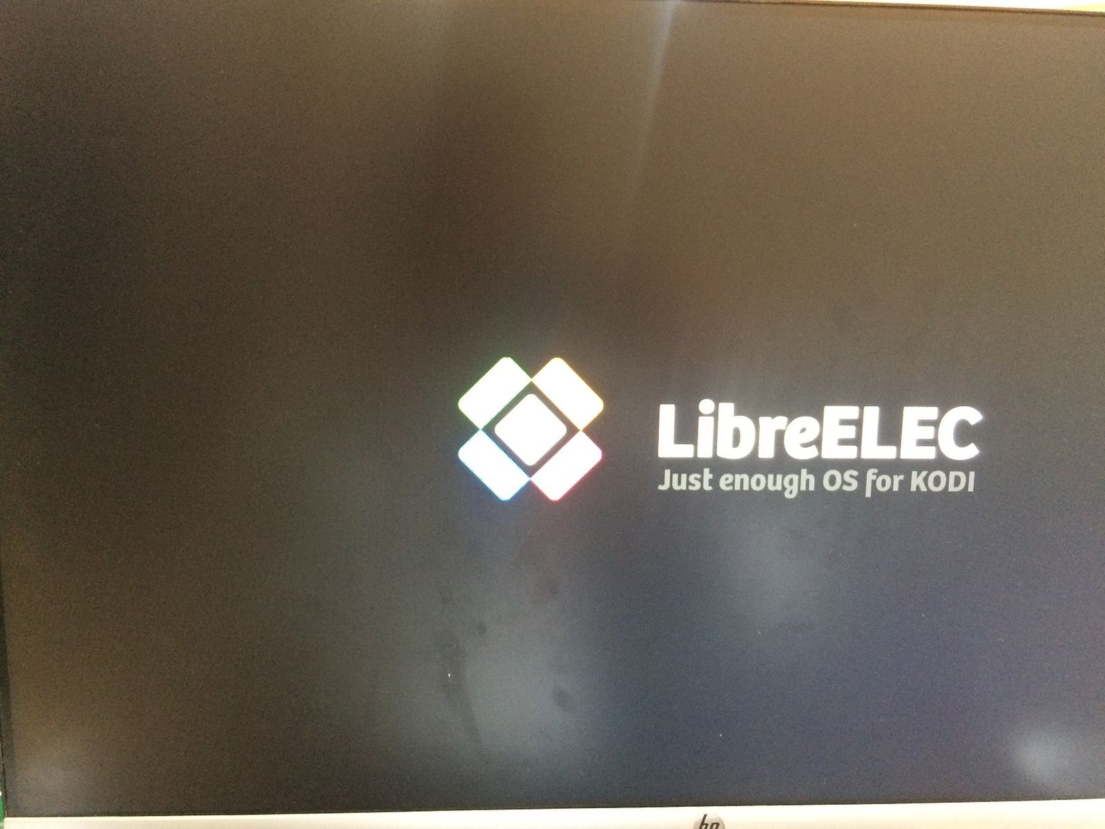

    2) When I type "exit", LE logo appears
    3) Contents of /dev

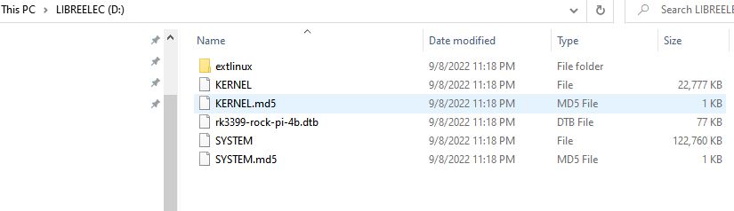

    4) Contents of NVME as seen from Windows after writing the image

    Then I tried to do the same with NVME SSD. I used USB SSD reader, wrote the image through Balena Etcher and tried it on Rock Pi 4B. During the boot, console gives the following message: "libreelec could not mount uuid". Afterwards, device is stuck and only LE logo appears.
