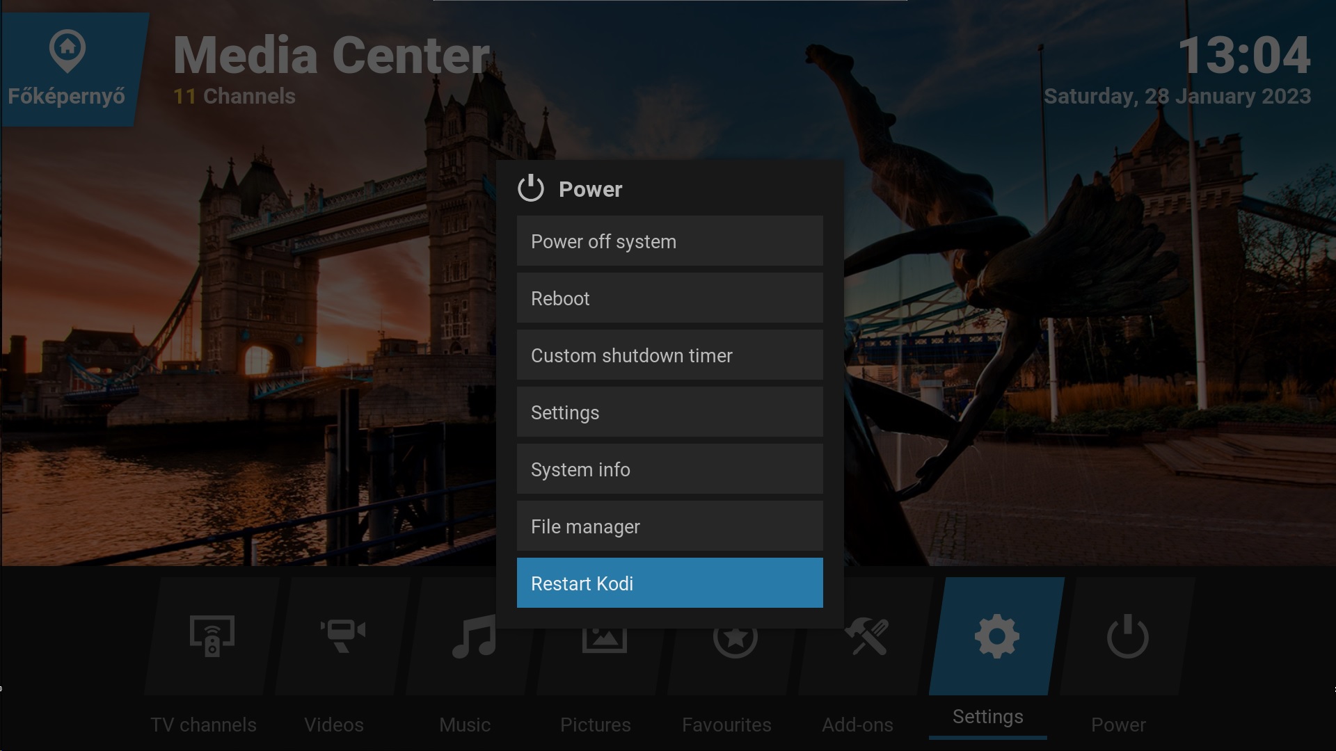

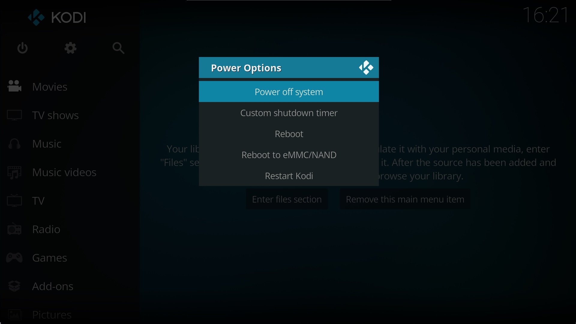

Each Kodi skin uses its own powermenu config, so there's not much point in adding it to Estuary by default, not to mention that this menu item will appear in English on non-English languages as well, which is quite confusing for some users. I don't think you're using the Estuary skin either, because there's no Exit menu item under LE.
So it depends on which theme I will use? But which theme to use so I can add
boot option in power menu ?
