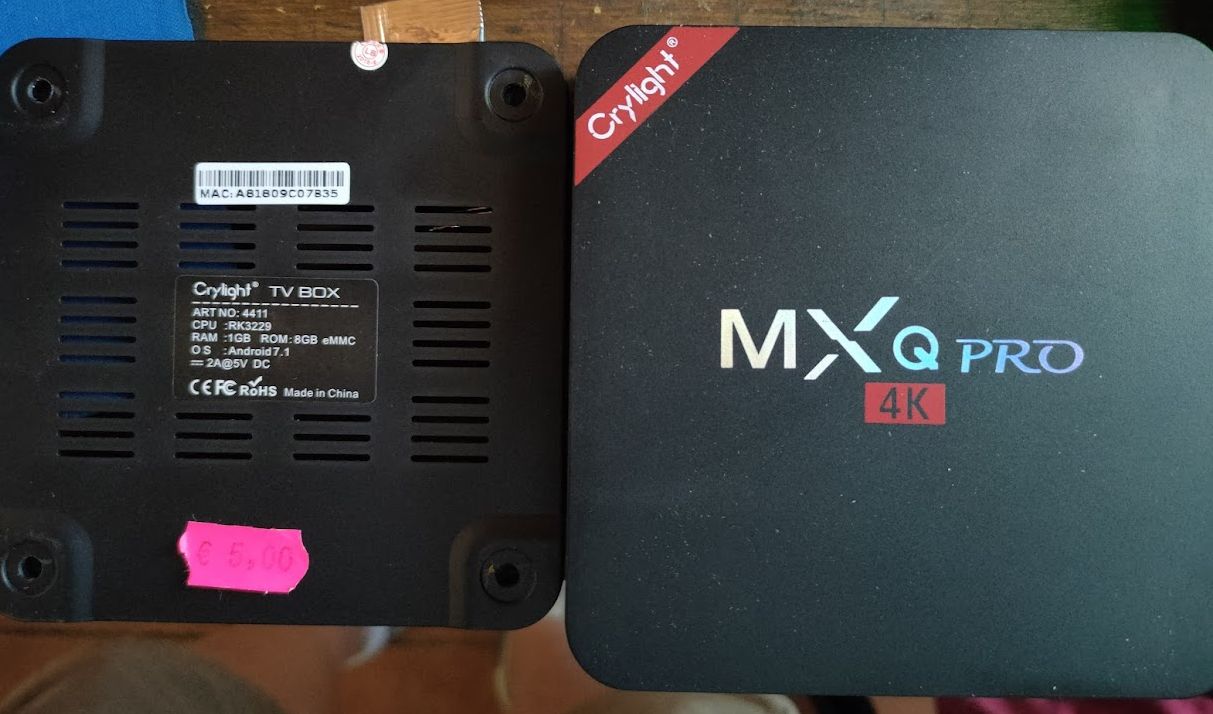

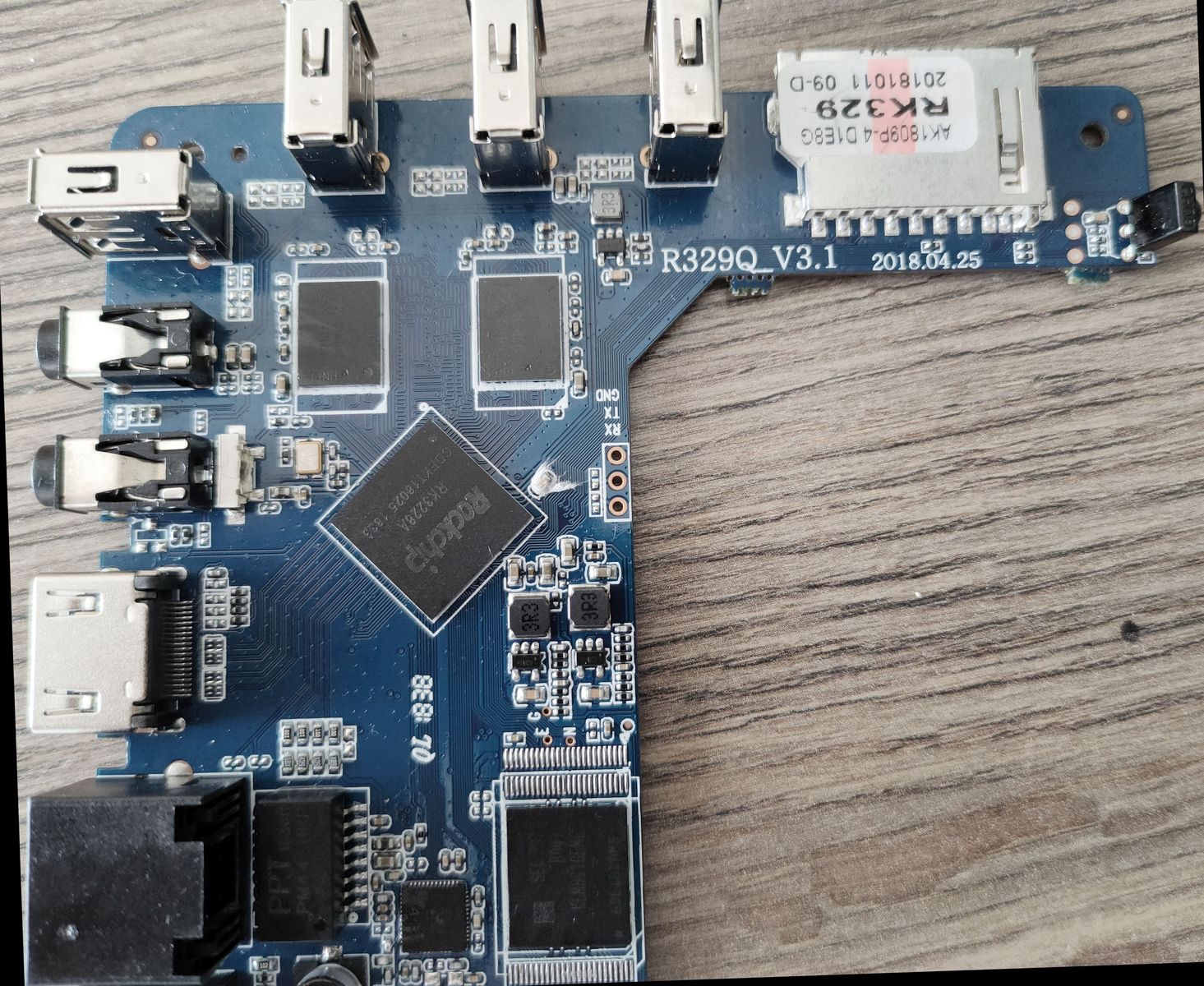

    This build of LibreElec 10.0 works amazingly well, but I have some issues:
    - HDMI resolutions are incorrect
    - No audio from HDMI
    I put two pics of the boxes: AFAIK they have eMMC (Samsung part, 8Gb), rk3228a & 533Mhz DDR3. On the board is written V3.1.
    They have South valley SSV6051 wifi (not really important).
    Actually, your build is the ONLY one that does not crash after one/two hours of video, too bad I do not have any audio, and I don't know where to look for a fix. HDMI driver loads fine, but it seems ALSA device is not detected. Here's what I read in dmesg:
