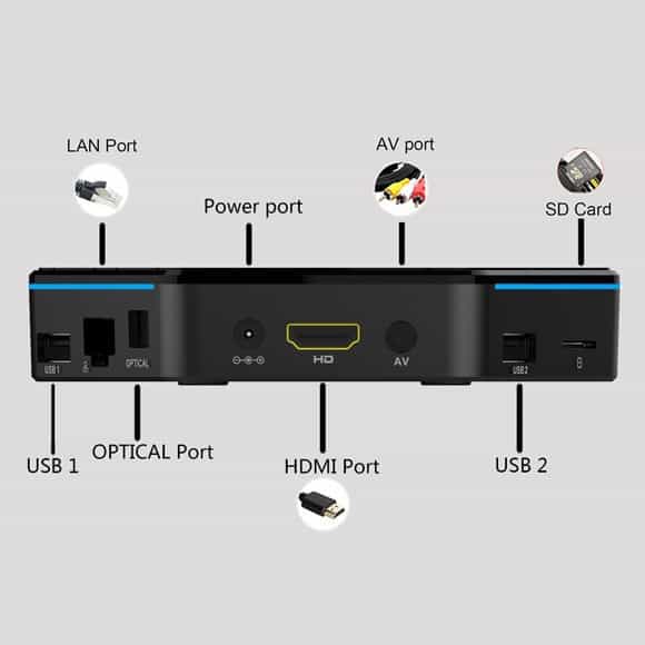

@chewitt, Your build doesn't make any changes - the USB No:1 don't work:
Posts by PhoenixBG
T95Z Plus 3/32GB... now, with meson-gxm-t95z-plus.dtb . Ethernet now working good (with meson-gxm-q201.dtb and meson-gxm-q200.dtb it doesn't work), LCD display shows information (with meson-gxm-q201.dtb and meson-gxm-q200.dtb it doesn't work at all), but one of the two USB ports stopped working after update from LibreELEC 11 Beta 2 to 11 Stable. I can't explain what has happened, but one port is working but the other is not. Before update all ports has working!
